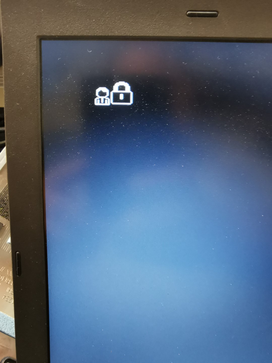

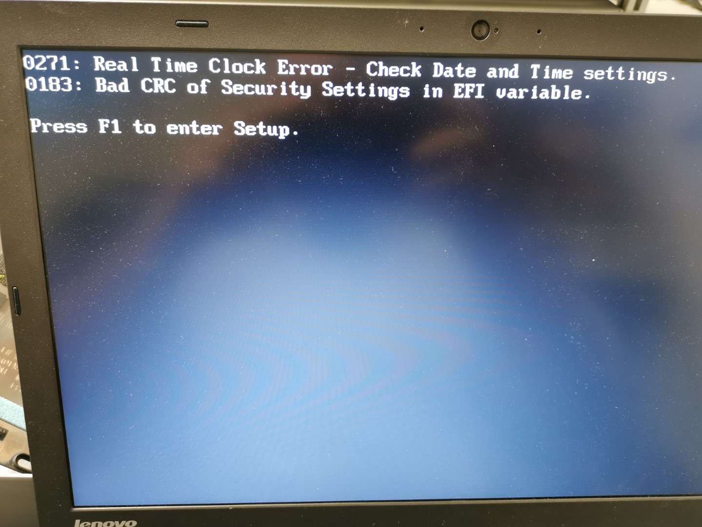

    After flashing and reassembly the laptop starts (and beeps) until the following screen: Pic ...118
    Press f1 to display the following screen: Pic ...059
    I do not know that password !I don't even know if one has been programmed, at least the seller claims not to know.

    I think my bigger problem at the moment is the password.
    can someone tell me if the W540 has a separate security chip where the svp is stored
    or is the password in one of the both BIOS-Eproms?

      Try to patch your dump and follow the guide after :
      https://www.badcaps.net/forum/showthread.php?t=87588
