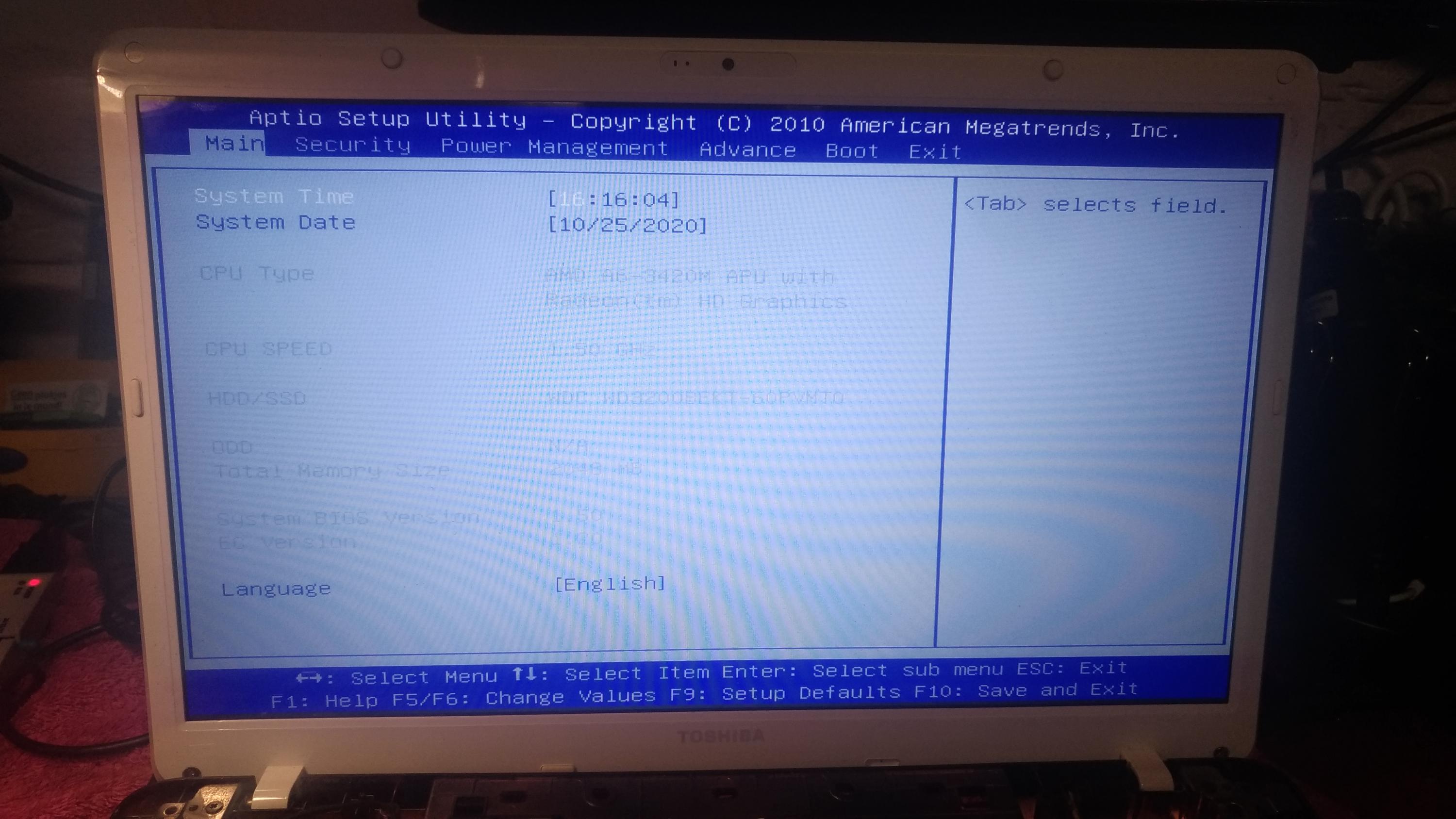

              Ive made a picture of the bios , it is showing main and ec bios versions, is this ok because the laptop has only 1 eeprom ?

                Re: Bios dump for Toshiba L775D-10v
                Found the problem! One of the USB ports 5volt was shorted!!
