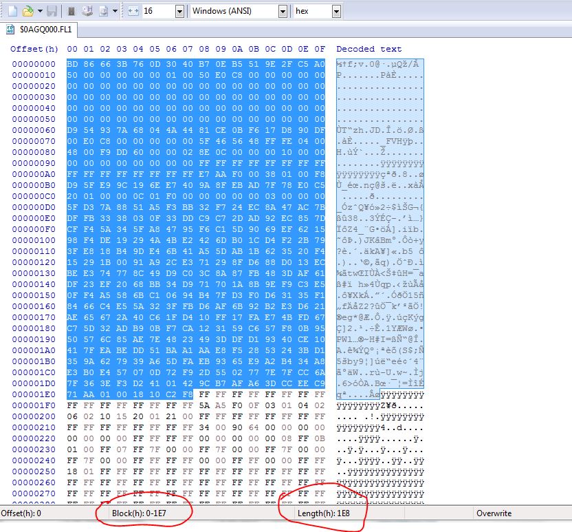

      After you`ve extracted the exe open the .FL1 file with a hex editor.Delete 0-1E7 (length 1E8),

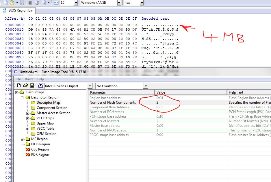

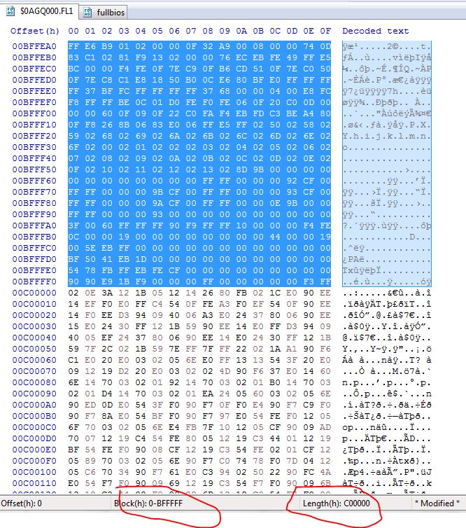

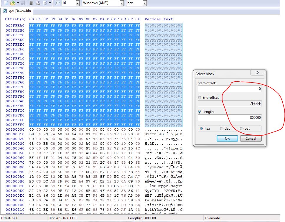

      then Select block 0-BFFFFF ,the full length is C00000 which is 12MB,copy and save into a new file.There are 2 bios chips,8MB + 4MB.Check your bios backup to see which is 4MB and 8MB, and if you don`t have bios backups you can check where the 12MB file should be split by opening it with FIT flash image tool, check with MEAnalyzer first to found out which FIT to use,its version 9.5 (tools) .Open with FIT ,the flash descriptor will say 2 chips, then check in the decomp folder,the bios region is 4MB .So now you know to split the 12MB file into 8MB (ME) + 4MB (Region) ,not 4 + 8 . Select block 0-7FFFFF (800000 8MB) ,select cut,open a new file,paste into a new file.Save both.
