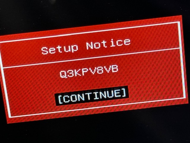

        Setup Notice
        [Q3KPV8VB]
        password = WSOE0J0K1

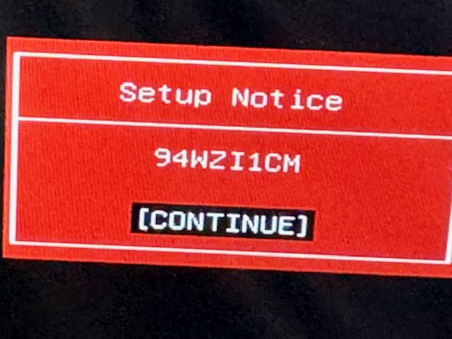

        [94WZI1CM]
        password = LD99UAJU1

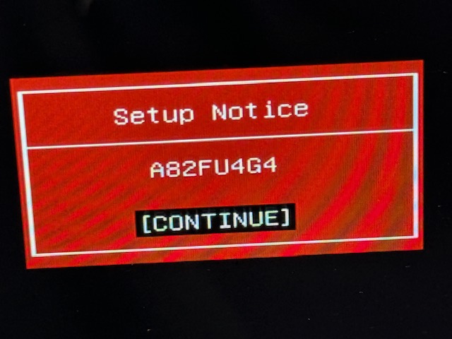

        [A82FU4G4]
        password = LJOU8DFD1

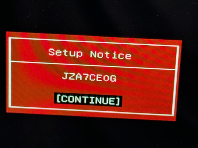

        [JZA7CE0G]
        password = Y9LUJIFF1

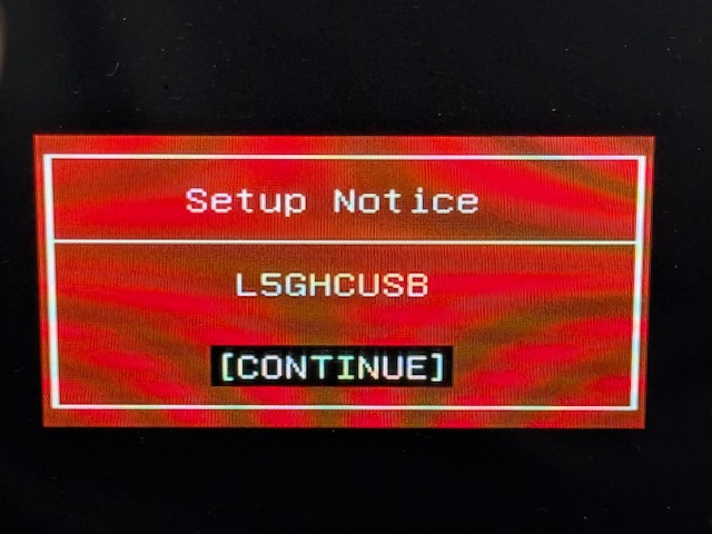

        [L5GHCUSB]
        password = IIFIJ89K1

          #44
          Re: ECS laptop ed20pa2 bios password
          thx so much...
          but this password didn't work
          [QUOTE=AAAC;1276717]Setup Notice
          Setup Notice
          [JZA7CE0G]
          i think it is the J
          greatings, Stephan
          • AAAC
            • Jan 2020
            • 457
            • Mexico
            #45
            Just reboot and obtain a different code that does not include the "J" character.
            EDIT: It's probably your keyboard layout, as all passwords are calculated for a US QWERTY keyboard and the computer you are trying to unlock may have a QWERTZ German keyboard, I believe that's the reason.

              #46
              Hi AAAC,
              i have reboot and reset the passwords...
              and the QWERTZ Keyboard by me is the Reason for the "incorrect" J Character... it's not a Y, it's a Z by me ;-)
              Thx so much for your help and work...
