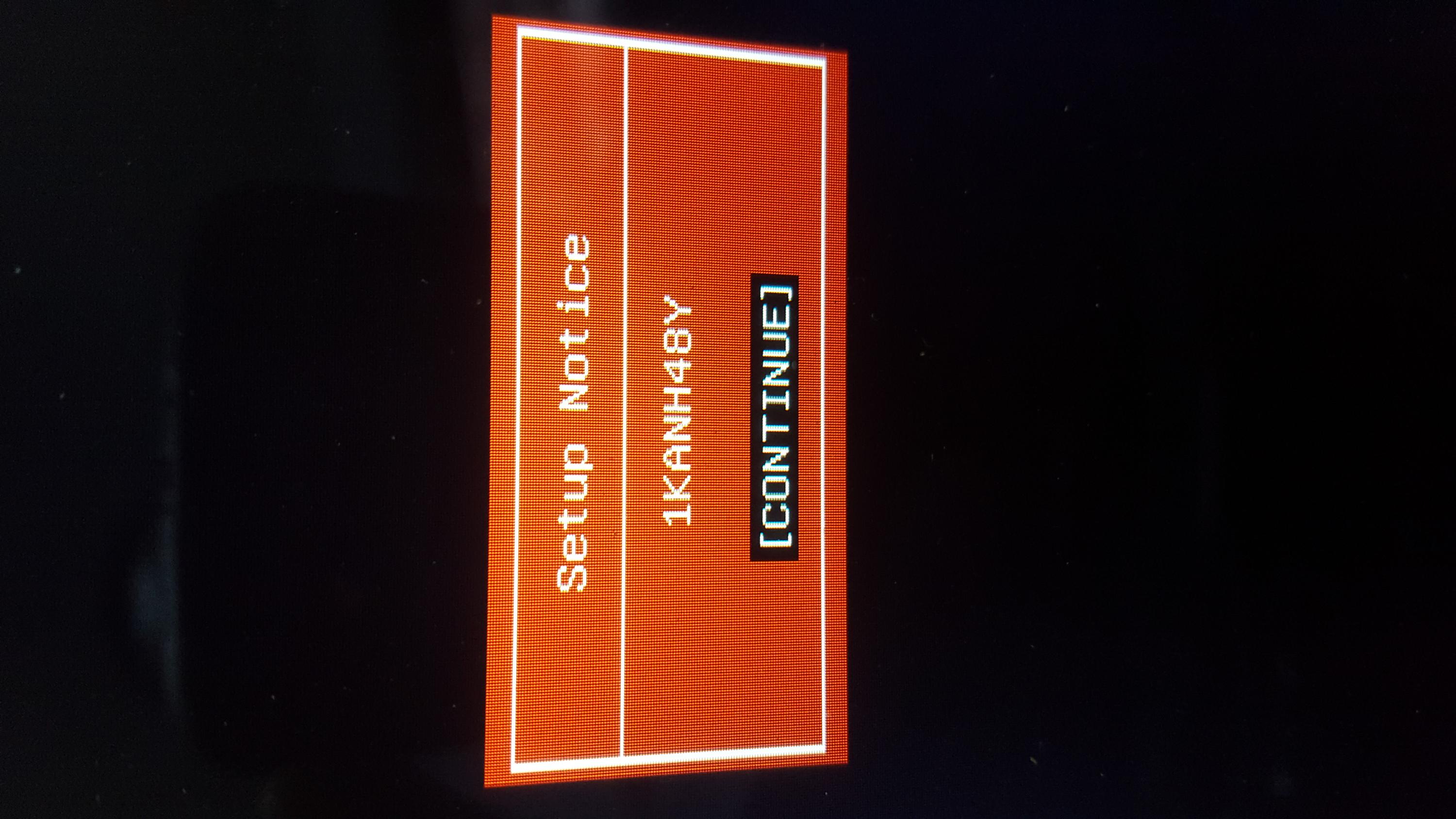

    Hello everyone, help me to remove password from backup,
    model :ED20PA2 V1.1
    P/N:15-XA6-011100
    THANKS

    Re: ECS laptop ed20pa2 bios password
    Hello, does the code shown on the picture keeps changing on every reboot? I did check part of the code in order to calculate a matching password.
    Can you record a short video starting from the point you power-on computer, until you press the [CONTINUE] option on the picture? I will like to see all the messages.
        @andrew25
        Check if code changes every 3 incorrect passwords, if it remains constant then provide a picture.
            Ok, so the code must be changing every 3 incorrect passwords, do the password typing again until you get a new code, take a picture and upload it here, wait for the password.
            What happens if you click CONTINUE after it shows the Setup Notice code? does it allow you to type the password that will match the code? I'm thinking that if a password is to be generated for a particular code, that it may be only valid while there, meaning that if you cycle power the computer, (the password) it may no longer be valid.
              after 3 incorrect password attempts it displays a challenge code.. then it shows where to put a master password ... let me share you a picture shortly

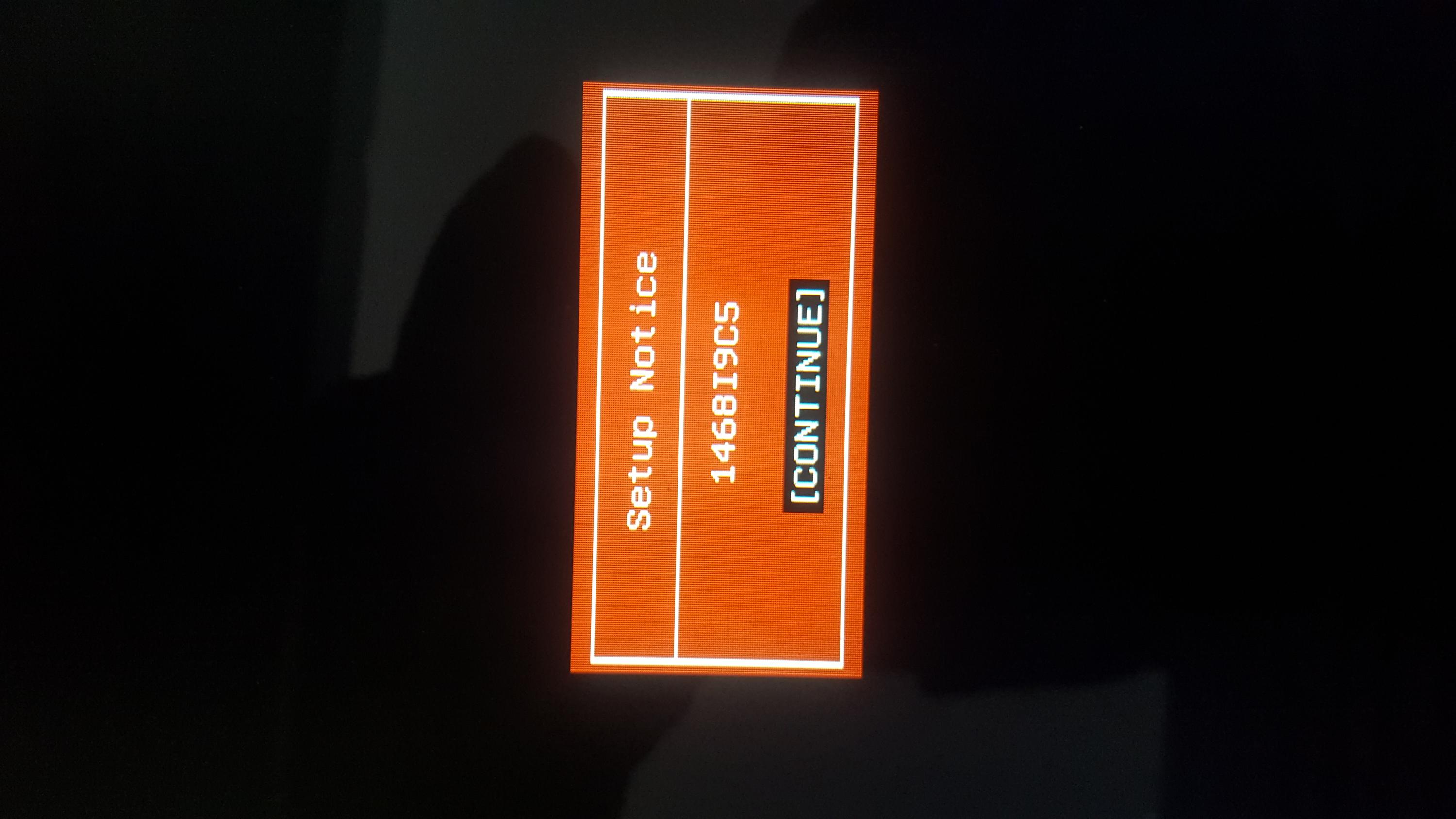

                thats the picture after 3 incorrect password attempts

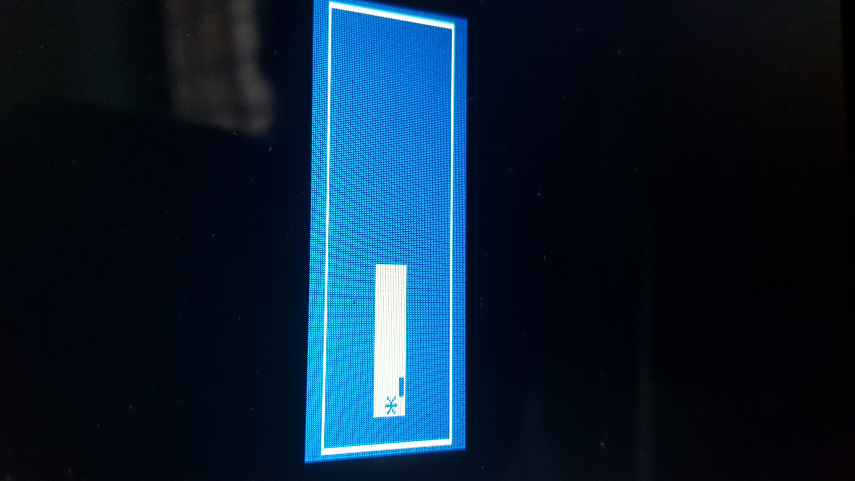

                              here are the screens for the code after 3 wrong password attempts and the screen which follows when i click on "continue"
                              • AAAC
                                • Jan 2020
                                • 458
                                • Mexico
                                Setup Notice
                                [1KANH48Y]
                                password = AOLJIDJ01

                                • andrew25
                                  • Feb 2016
                                  • 222
                                  • Malawi
                                  Setup Notice
                                  [1KANH48Y]
                                  A - ALFA ( UPPERCASE )
                                  O - OSCAR ( UPPERCASE )
                                  L - LIMA ( UPPERCASE )
                                  J - JULIETT ( UPPERCASE )
                                  I - INDIA ( UPPERCASE )
                                  D - DELTA ( UPPERCASE )
                                  0 - zero ( digit )
                                  1 - 1 ( digit )
                                  it worked bro, thank you so much.. God bless you

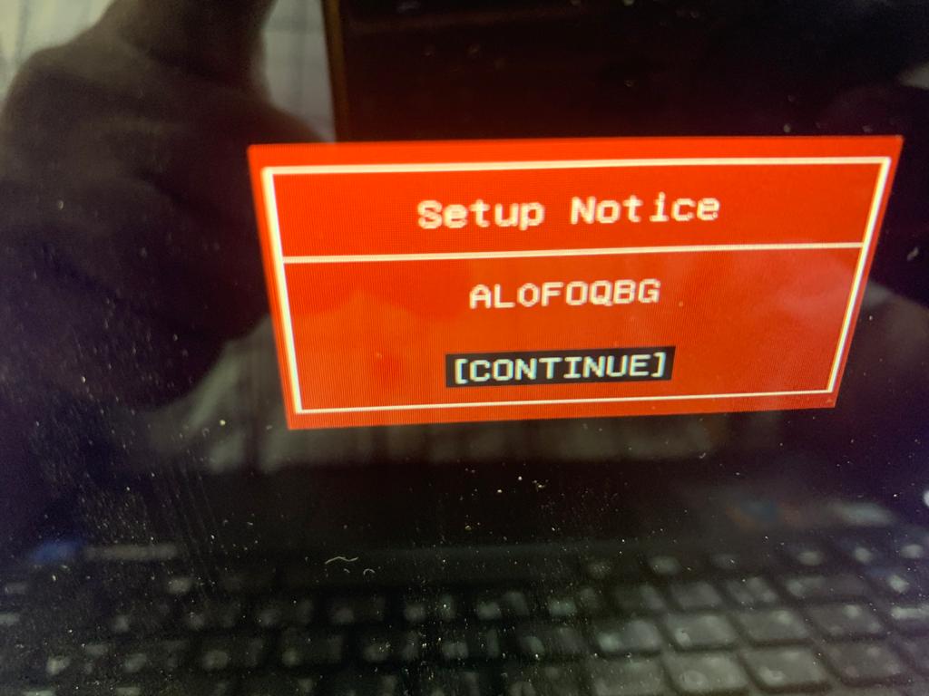

                                        Hello, at our school, on one laptop, they put a boot password in the bios (ECS EH20GM laptop) with three unsuccessful password entry attempts, it issues a SETUP NOTICE request with a key, the key changes. Could you give a link where the bios password generation mechanism is described, or describe the generation algorithm, I would try to generate a key. Thanks
