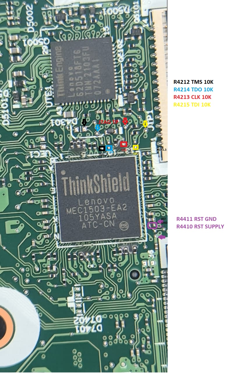

    Hi to all i try to read mec1503 by SVOD3 from t14s gen2 but no luck can anyone help?
    JTAG pins in photo.

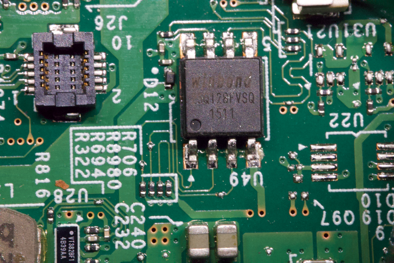

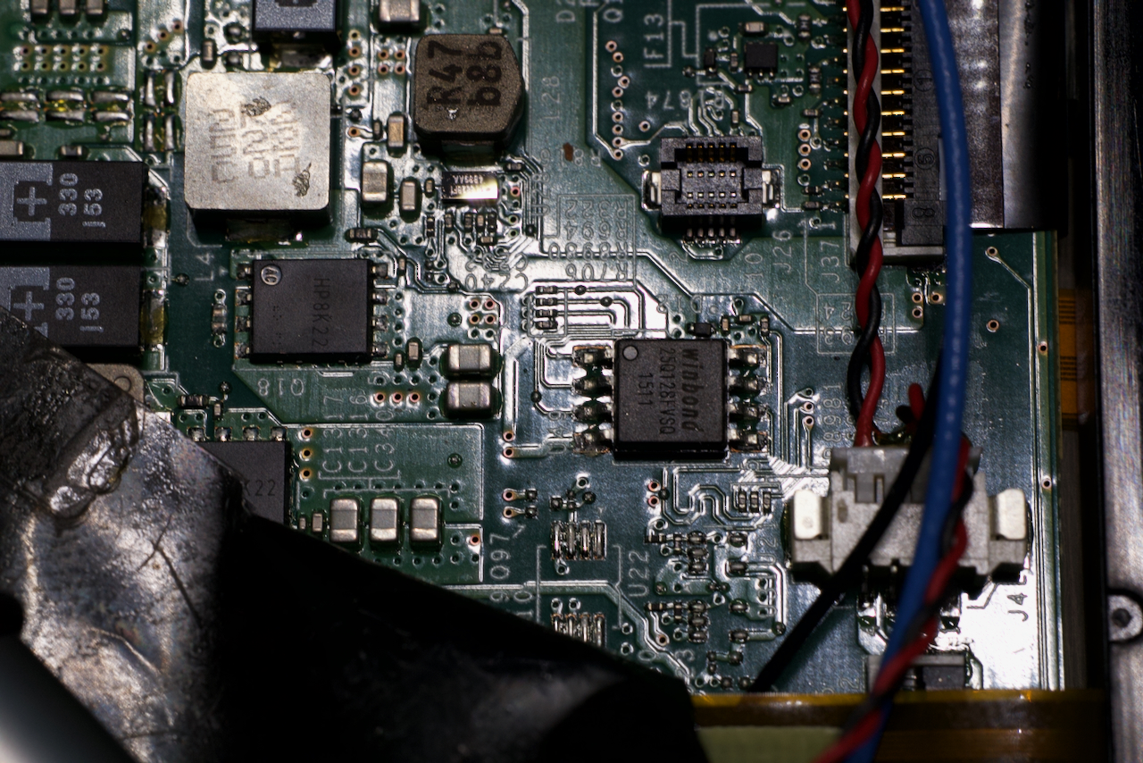

      Re: LENOVO BIOS AUTO-PATCHER for Supervisor Password Removal
      Originally posted by Markus1741
      Are the resistors that lead away from the chip okay? Not that it looks like it. A photo of the current chip would be very helpful.
      Hi there! Thanks for weighing in on this.
      There isn't any physical damage apparent (to me).
      Here are a couple photos of the chip in question:
      Looks like 1511 version
