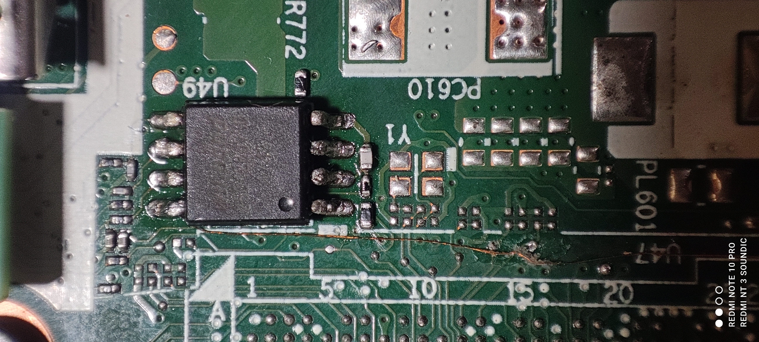

            T470
            I DUMP backuped ORIGNAL FILE AFTER CREATED THE patched.bin file with auto patcher
            erasing bios chip and flashed with patcher file
            and after this all this thing is gone which is write down
            below down all prosses compleated, in between i forget temper proof switch to pressed continue.in all this prosess
            pess F1 to enter setup: password 1234
            wait 20sec or more
            Press anykey to hardware Id
            Press 2x space
            tpm certificate changed
            turn off
            flashed with backup bios original .

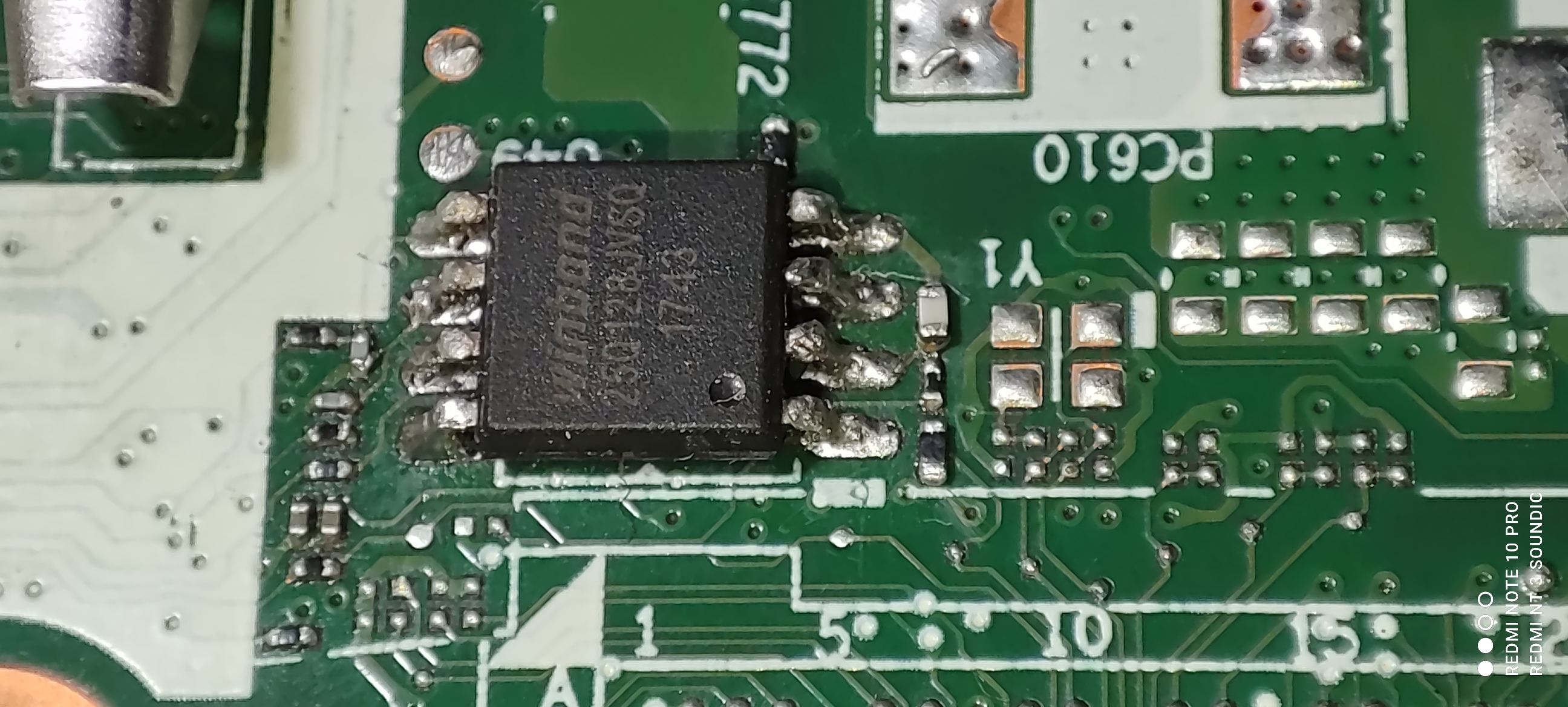

            but at right now my pc not showing any response with power button, no led light to showing with power button and no cpu fan running,
            when i connect charger power button green led 3 time blinking and goes to off and charging orange light continues show orange light ,,
            but no booting, power button is pressing nothing happen
            laptop is fully dead condition.
            please help me

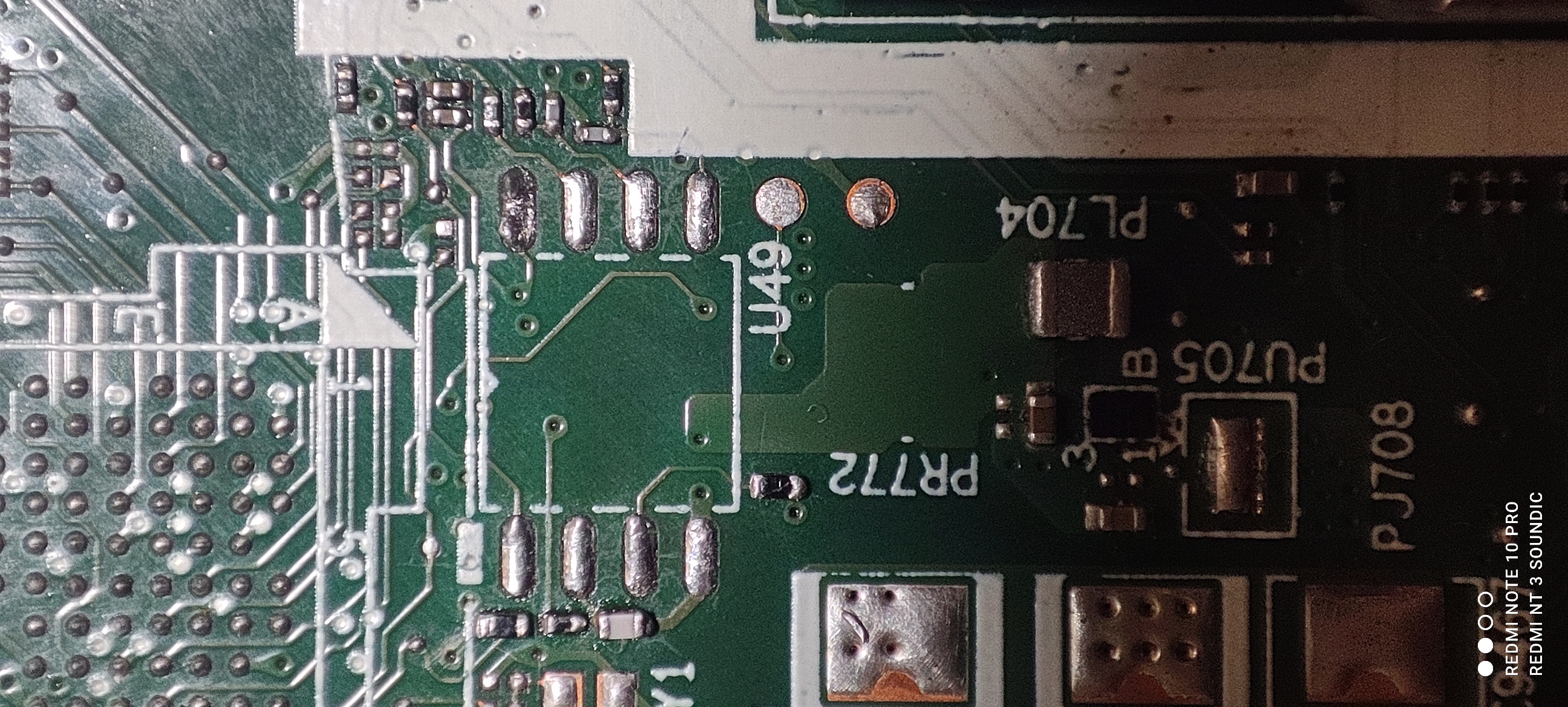

              T470
              wait 20sec or more
              Press 2x space
              turn off
              please help me

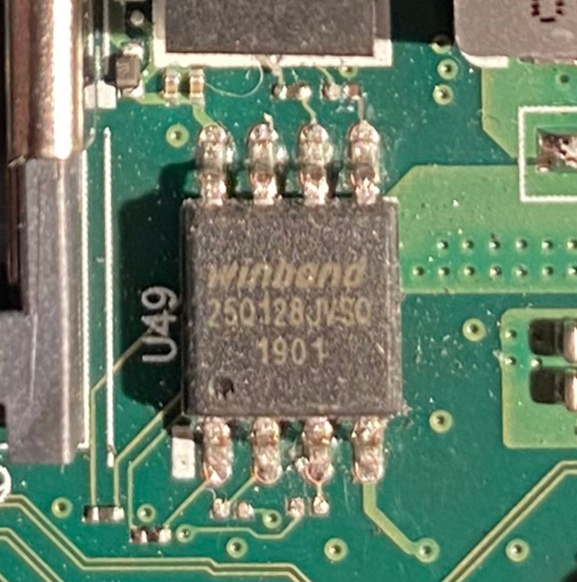

                  Hello, I don't know if this is helpful. But are all 6 resistors leading away from the EEPROM still intact? They're quite happy to be torn off by clip, not because it looks like this.

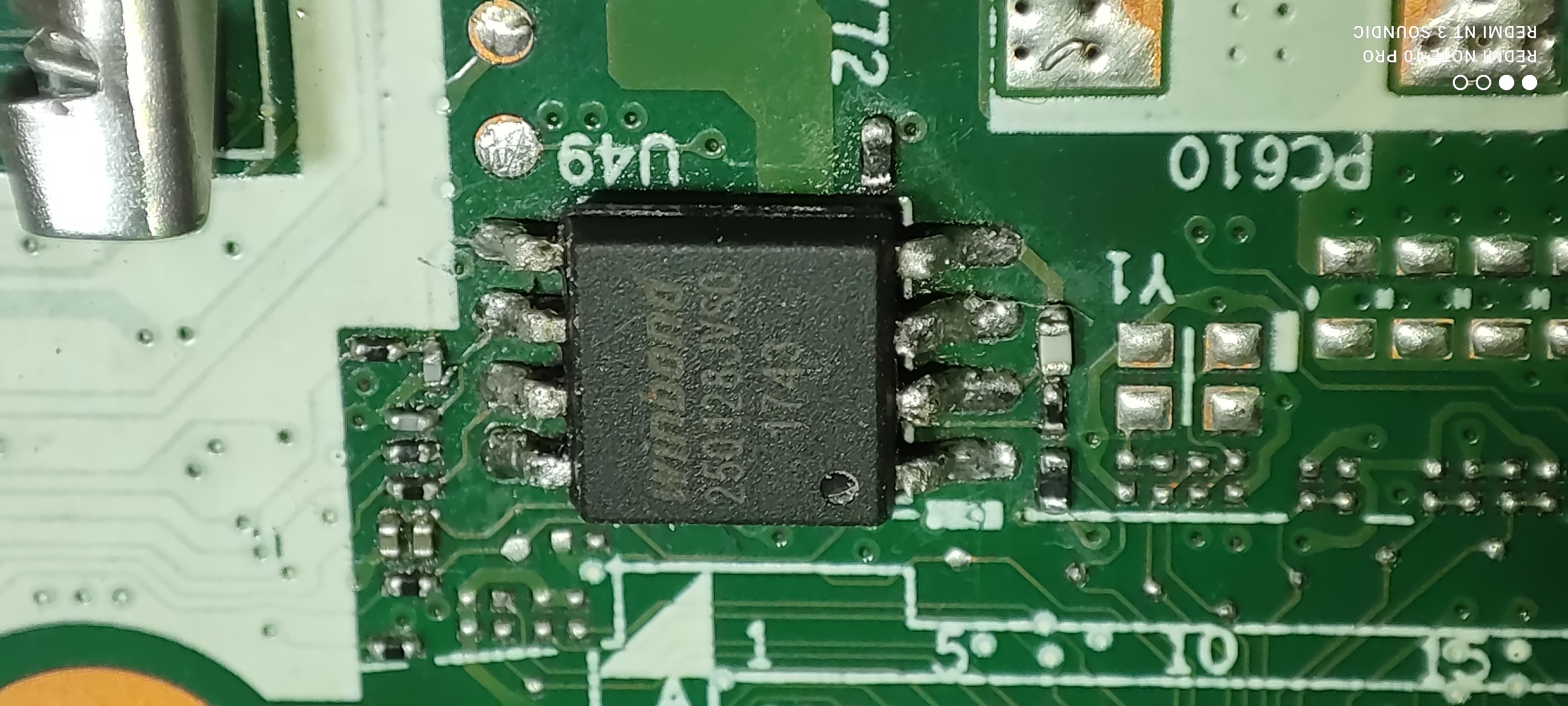

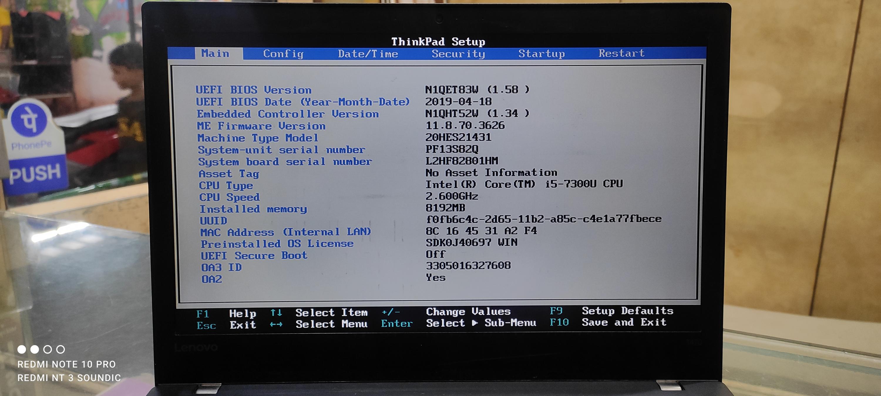

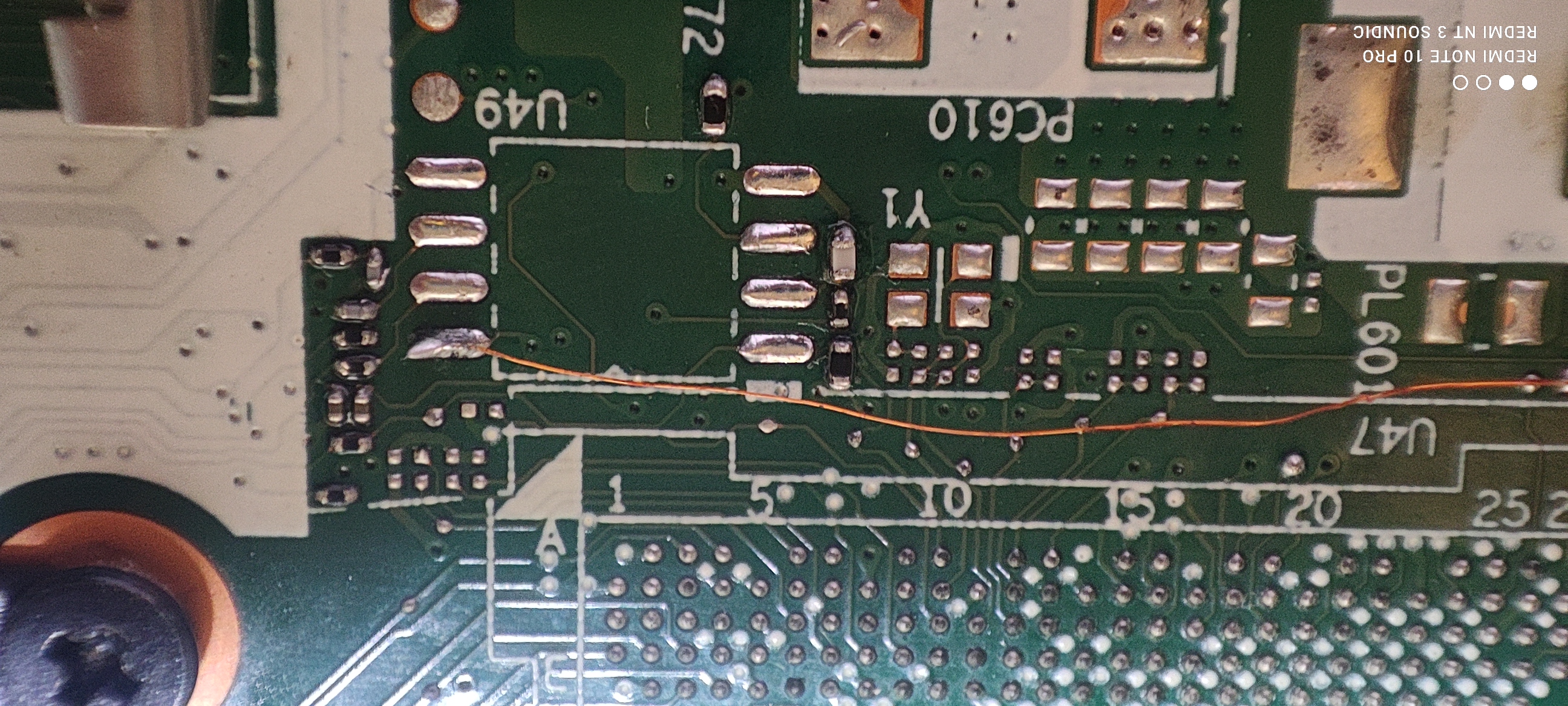

                        #1931
                        Re: LENOVO BIOS AUTO-PATCHER for Supervisor Password Removal

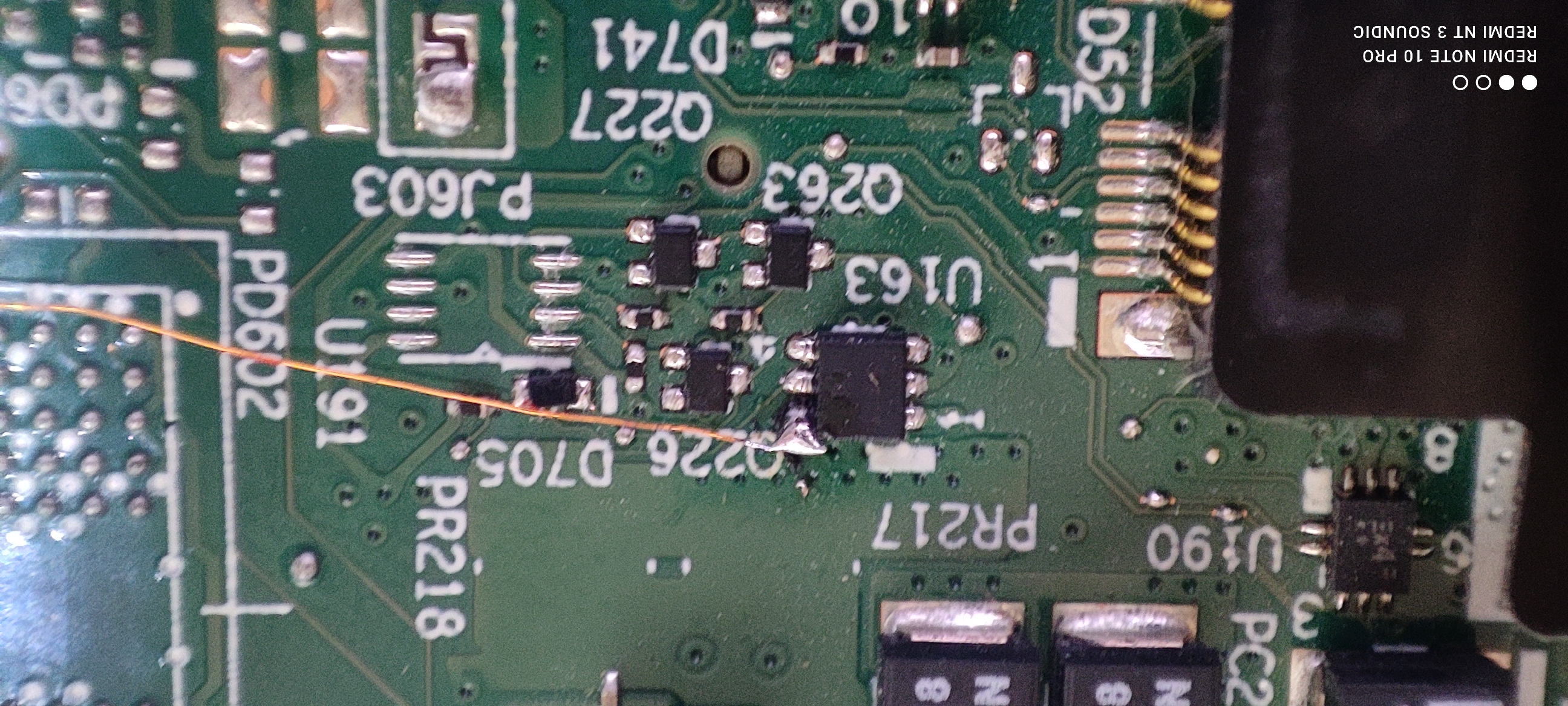

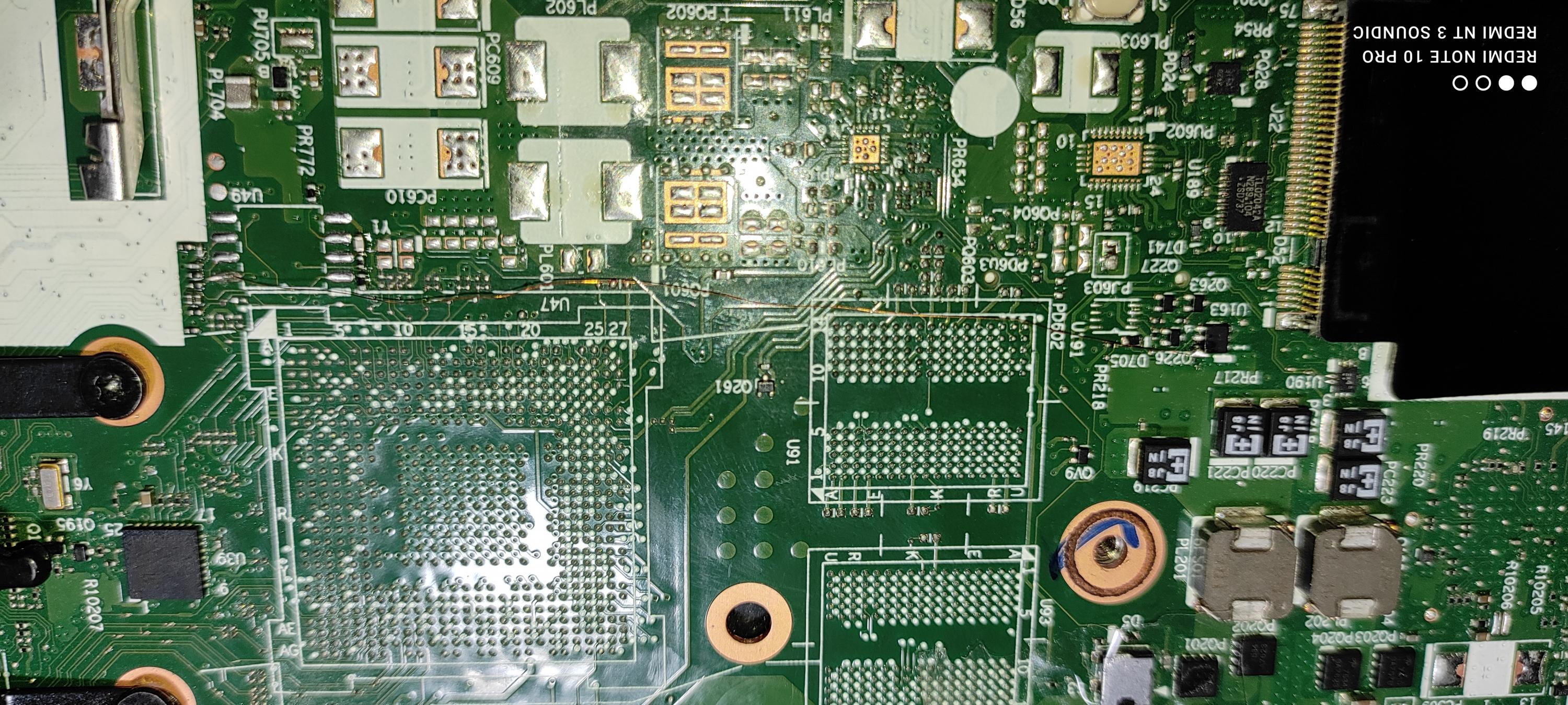

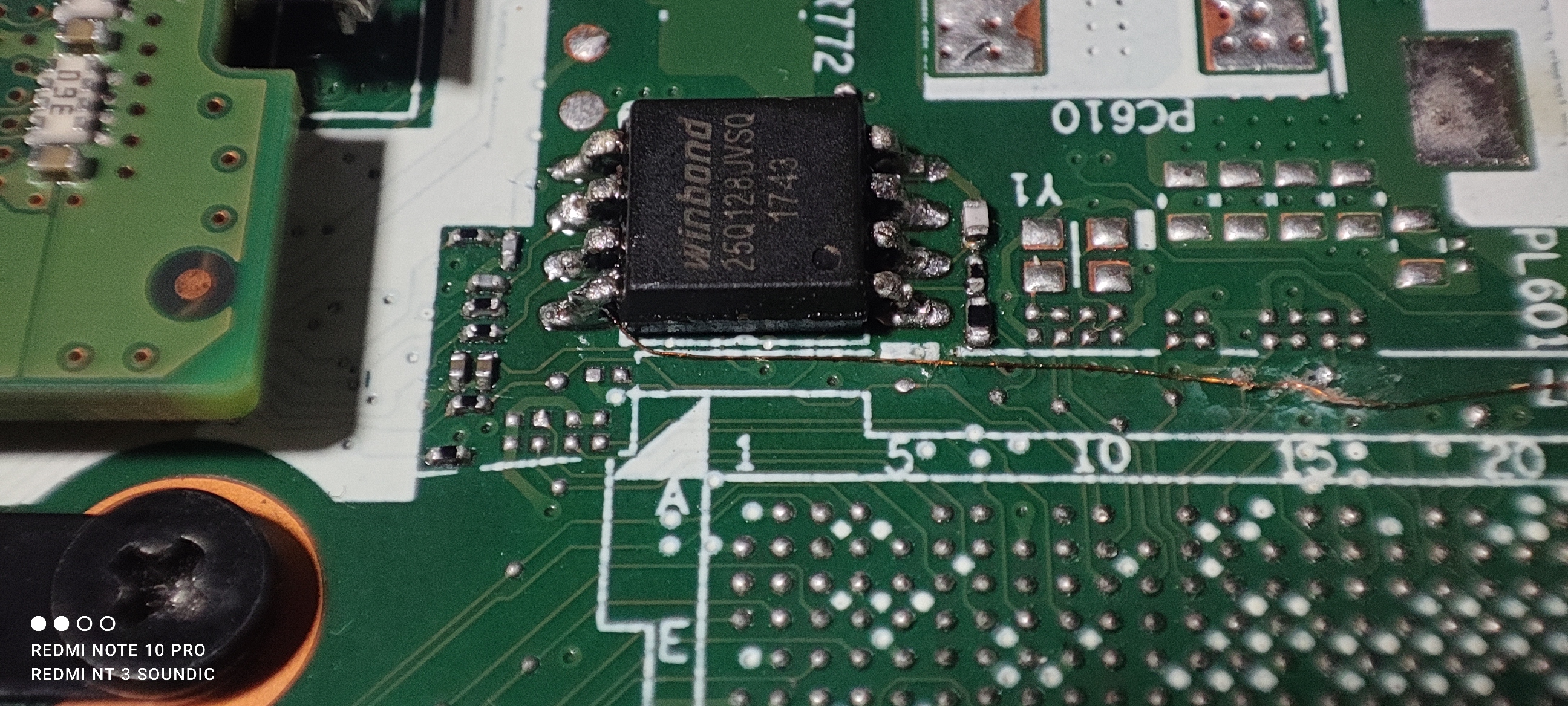

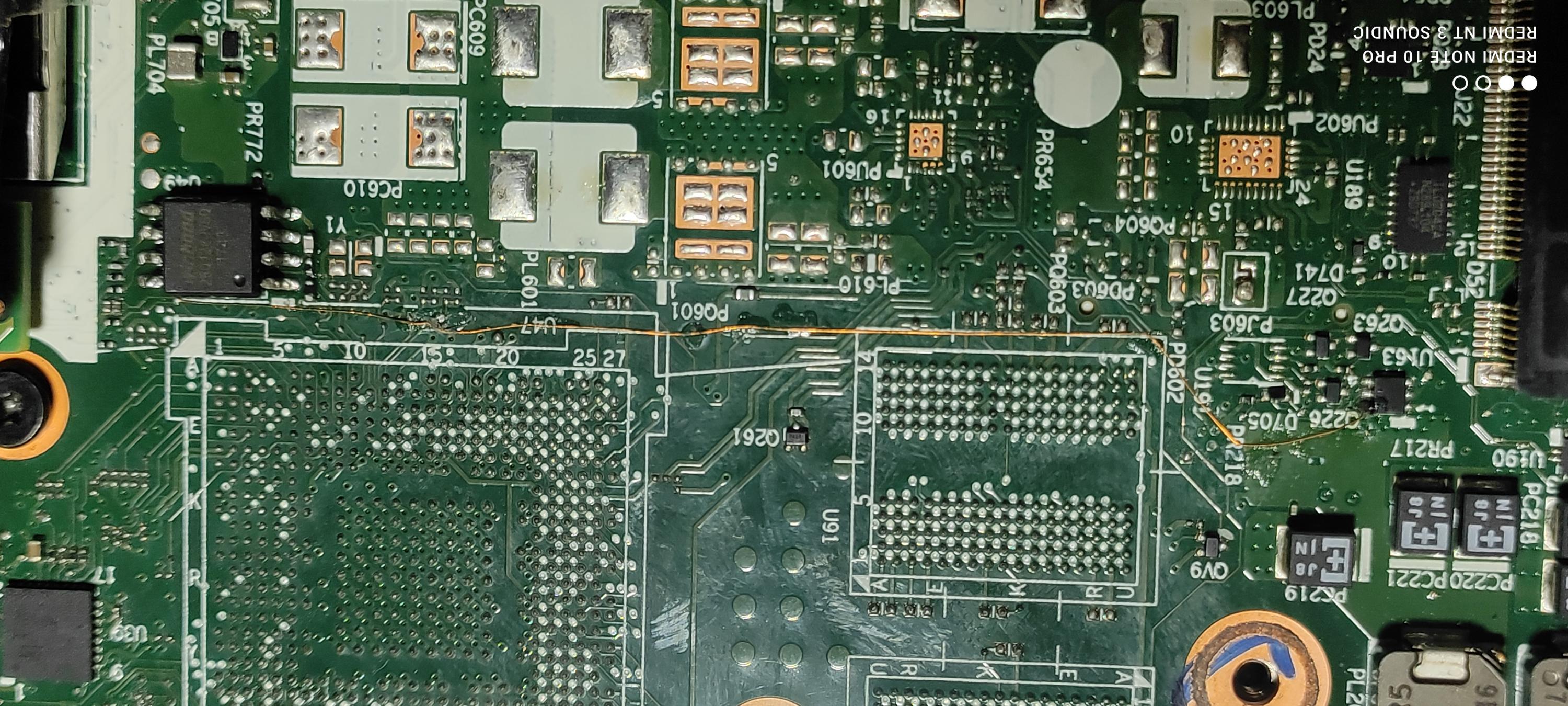

                        yes of Corse your write every line is helping everyone
                        1st my 1 resistor is missing which one i placed already before posting and reading rply msging
                        but my system not powered by button,
                        i found my bios chip with multimeter no- 8th pin vcc pin is showing no value
                        and finding daigram of CT471 PIN SUPPLY WHER TO COMMING THIN PIN SUPPLY OF VCC, then i jumperd seeing by schematic daigram
                        AND NOW I AM THE WINNER
                        AND WORKING WELL DONE AND BIOS ALSO CRAKED
                        ALSO I AM ATTACHING PIC..

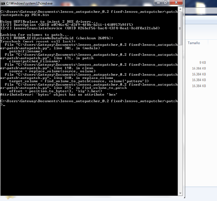

                                  #1936
                                  i got this error , create the file but with this errors friends any idea ? i download again and still same error
