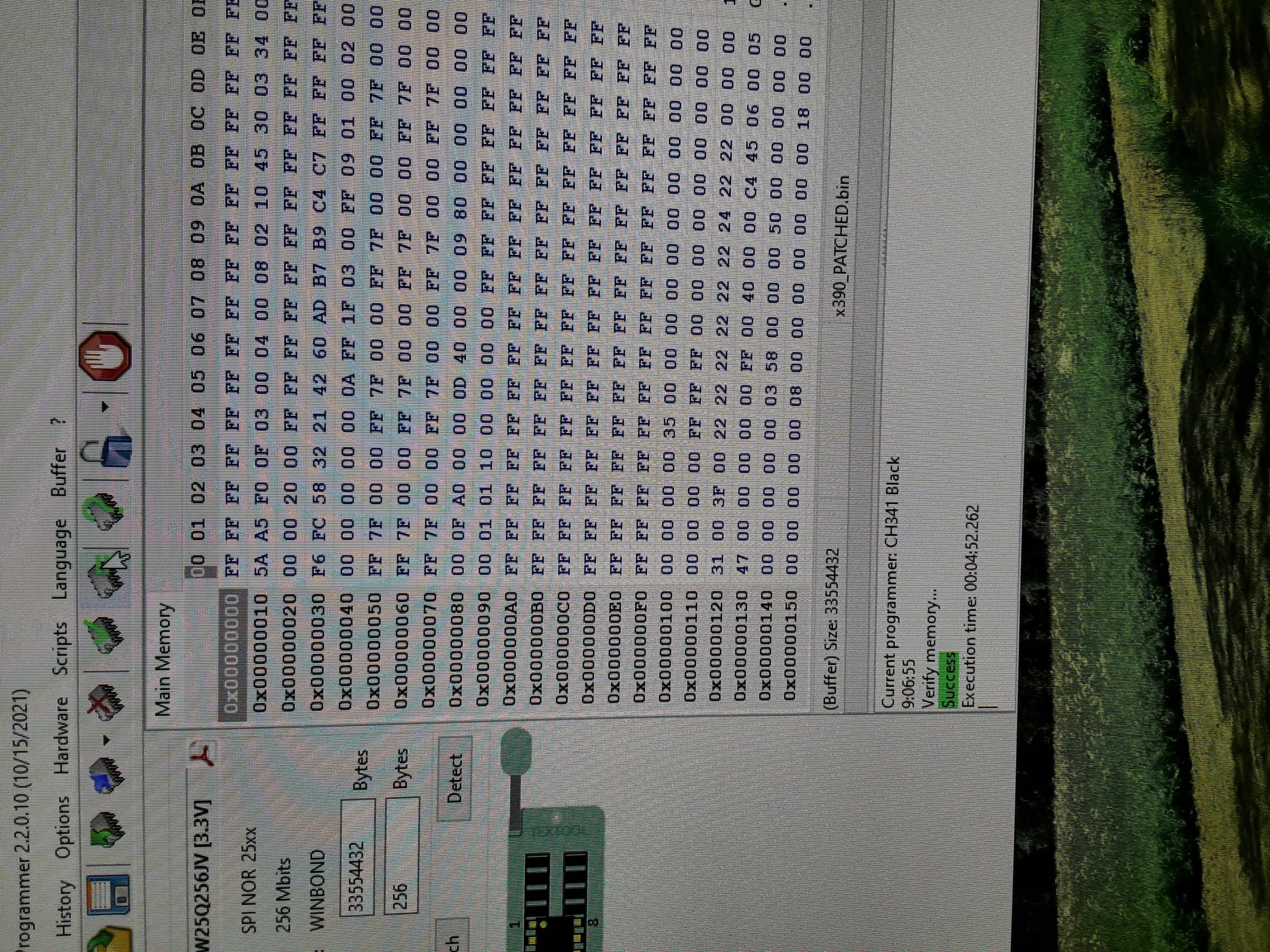

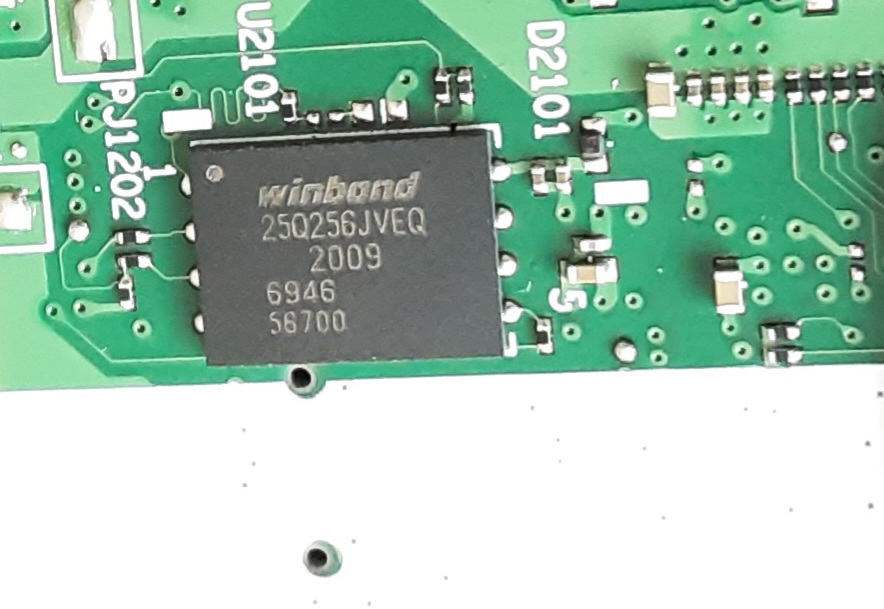

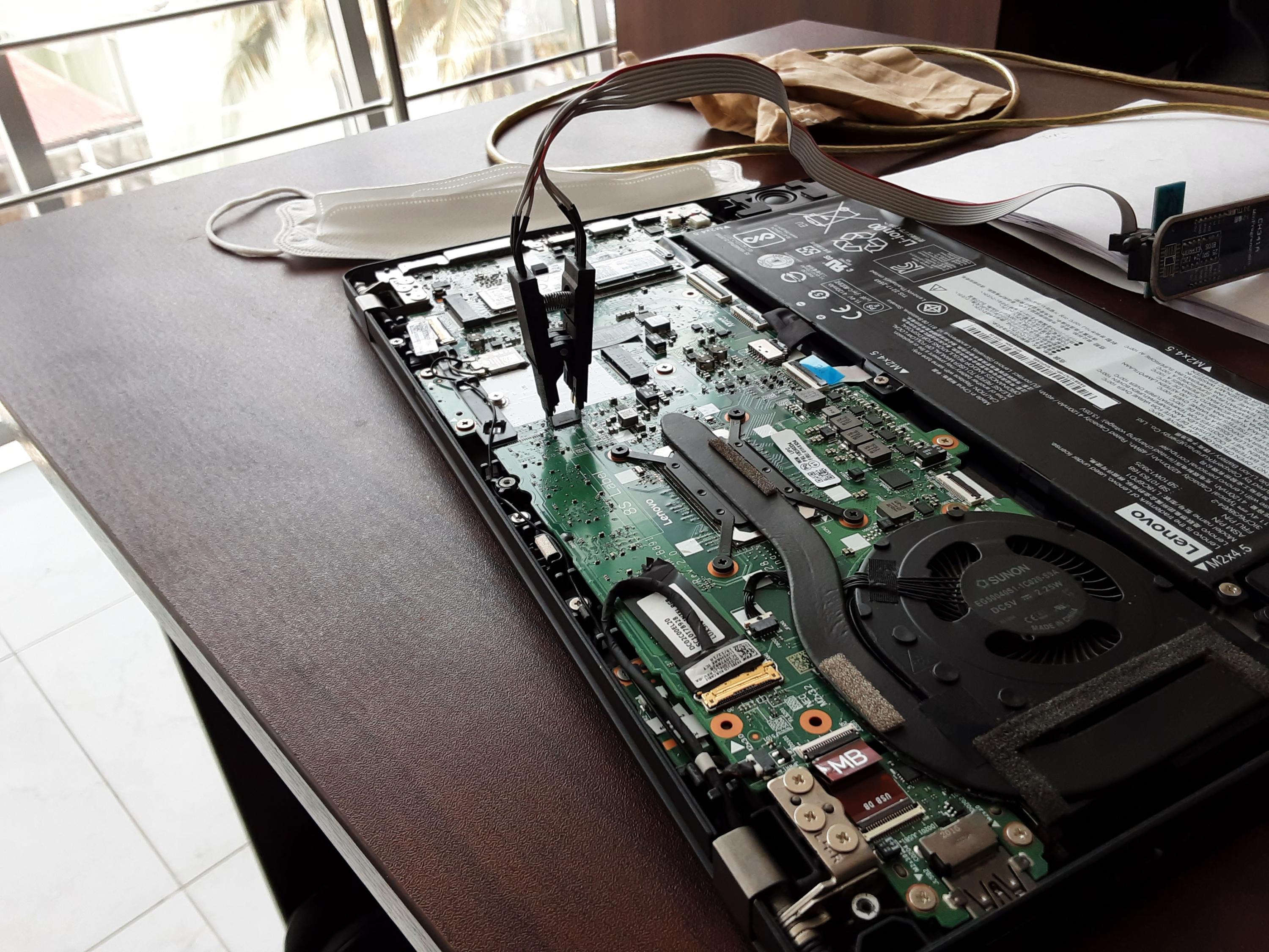

    Hi Thanks very much.
    did find it ( image)
    managed to use Colibri and did a few reads,
    use auto patcher and was happy to see it doing its thing and the good luck msg.
    with Colibri only able to select 25Q256fv ( the chip says 25q256jv)
    but thought was good enough.
    after writing the patched file only got black screen continued beeping and a small tune and beeping again.
    wrote back a patched file i found on the forum but then no responce no tune.
    had battery , cmos battery removed.
    now I tried neo programmer as it has the 25Q256JV) and programmed with an original i found on the forum as well as a patched but looks fully bricked.
    the programmers even veryfy the data and match well right now
    appreciate your assistance folks
    Originally posted by AAAC
    @Dimuth Rubesinghe
    By the model number you should be looking for a 256Mbit chip (32MB) close to uProcessor or at a side of memory slot(s), if Winbond look for W25Q256, or MX25L256 if Macronix… but the DXE driver patch does not work on 9th Generation ThinkPad models (with a couple of exceptions).
    What you need is a EC/KBC if you want to unlock it.
          @Dimuth Rubesinghe
          What I meant is that what you need is an EC/KBC programmer if you want to unlock it, as BIOS have Self-Healing feature that does just that. The BIOS have a running BIOS copy and a backup BIOS copy, if you just patch the second BIOS it will self-heal with the first BIOS; in this case you do get a black screen as the utility is patching both BIOS copies.
