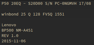

                Hello, is this thread still active ?
                The software says that my dump is corrupted or does not contain a valid dump. I Have quadruple checked it and the checksum is OK.
                winbond 25 Q 80 BL N10 1711
                P50 20EQ - S20D00 S/N PC-0NGMVH 17/08
                Lenovo
                BP500 NM-A451
                REV 1.0
                2015-11-06
                • Merlinox

                    @Merlinox
                    That error is because your chip dump is only 1MB, you need to look for other chip that may be located near uProcessor, RAM slots or EC/KBC chip.
                    • Merlinox
                      Thank you so much for your reply, it did strike me as weird that the dump was this small.
                      This chip was hard to find. It was indeed a 20Q128 instead of a 25Q80
                      The chip is under the keyboard for lenovo P50 20EQ. You HAVE to take a part the heatsink.
                      Cheers, you saved my day !
                      Last edited by Merlinox; 07-31-2022, 01:24 PM. Reason: I didn't find the chip. And then I did.

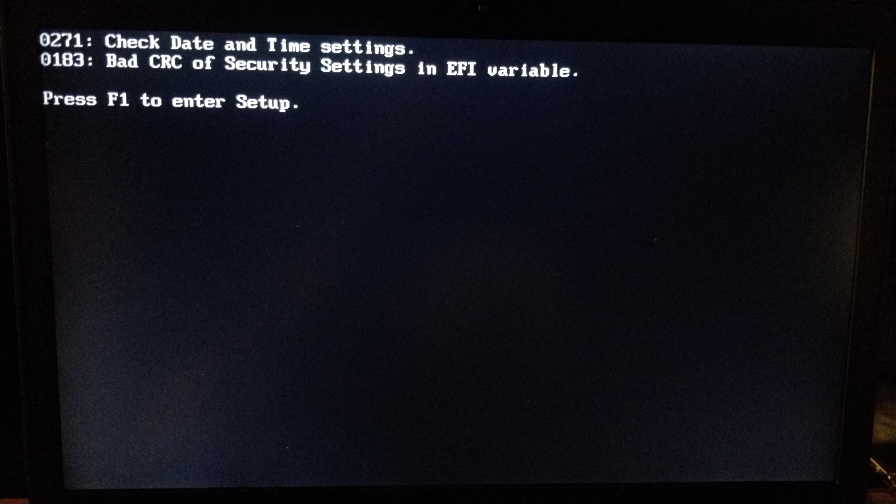

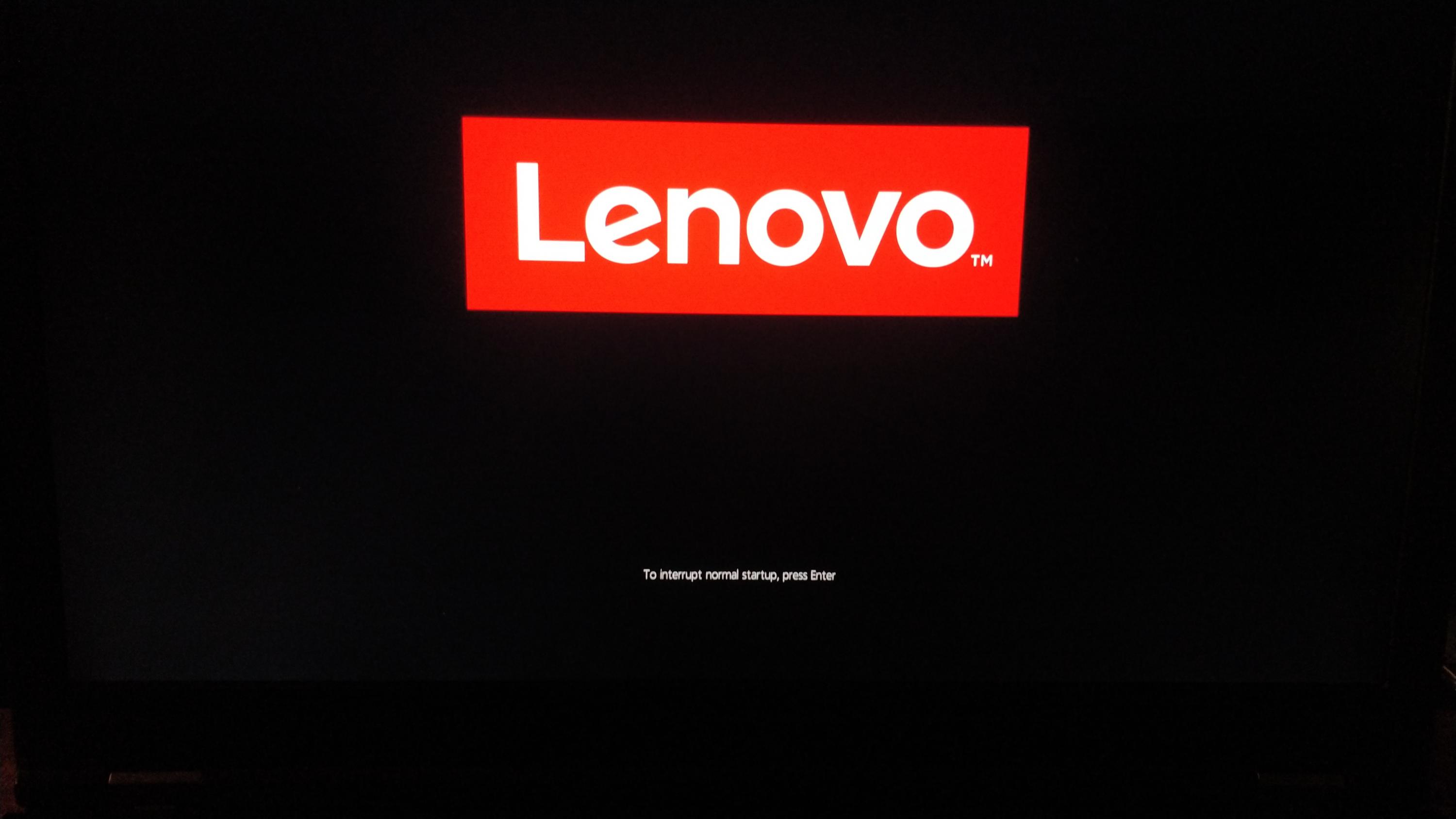

                          Re: LENOVO BIOS AUTO-PATCHER for Supervisor Password Removal
                          I have successfully patched the BIOS dump and flashed it. Steps 1-7 went smoothly,
                          I was told "TPM certificate changed. Turn it off." during the process.
                          @AAAC pointed out that this means that the laptop is unlocked.
                          After rebooting, the laptop posts, I can press enter to enter the setup, then the laptop beeps 4 times and shows the following messages:
                          "0271: Check date and time settings
                          0183: Bad CRC of security settings in EFI variable
                          Press F1 to enter setup"
                          Upon pressing F1 the screen stays backlit and the keyboard works (num lock toggle + fn lock toggle).
                          It stays like that indefinitely.
                          The issue persists with or without SSD plugged in.
                          What more can I do ? Did I miss a crucial step ?
                          I scrupulously proceeded with data integrity checks at every possible step.
                          edit (solved):
                          STEP 8: Restore original BIOS
                          means reflashing the first BIOS dump
