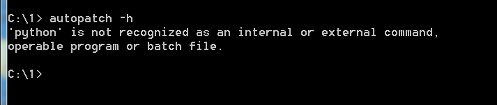

                                hello guys, i'm trying to use the script but i'm getting this error, i did install python 3.8 , and i'm using w7
                                What am i doing wrong?

                                  rename your bios to 1.BIN
                                  autopatch.cmd 1.bin
                                  GOOOD LUCK

                                    Add Python exe to your windows path.
                                    If you don't know how to do it copy and paste the previous like I wrote into Google. There are maybe 300,000 articles explaining how to do it.

                                      i copied the whole python program to that folder and it worked.
                                      However the resulted patch did not work, the laptop did not post, there was no image on the screen. I ended up using a patch made for a different l480 and that worked
                                          the patch must clean Nvram because with python 2.xx it doesn't work, you need python 3.xx.
                                          patch result ok but black screen
