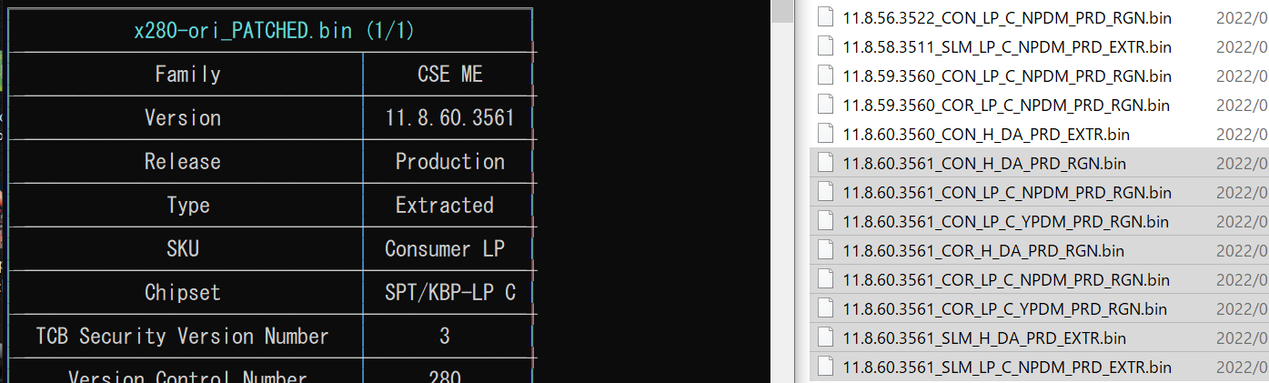

                        Re: LENOVO BIOS AUTO-PATCHER for Supervisor Password Removal
                        hi
                        lenovo x280 Intel 8th gen bios passworded.
                        have read the chip several times, gave me same md5.
                        here is one of the original bios dump...
                        could you please verify that this file is indeed not corrupted ?
                        and also would you please provide me the patched version ?
                        thanks a lot.
                        I have tried using Lenovo patcher in the first page, after flashing the patched file laptop became unable to turn on. Reverting to original dump doesn't restore the laptop functionality either....

                          #1332
                          Originally posted by ss45
                          hi
                          thanks a lot.
                          Try clear ME patched file.

                            #1333
                            Wow thanks.. btw coul you please point out which me file to choose ?
                            NPDM ? YPDM ?
                            • hoaca388
                              Badcaps
                              • Jan 2022
                              • 12330
                              #1334
                              NPDM ? YPDM ?
                              I usually choose NPDM.
                                Thank you.
                                Btw this BIOS image was pulled from the same board.
                                Why would I need to clear me region ?
                                Isn't it the case if only I change PCH or flashing bios from other mainboard(same model of course ) ?
                                Have you ever found yourself in this situation ?
