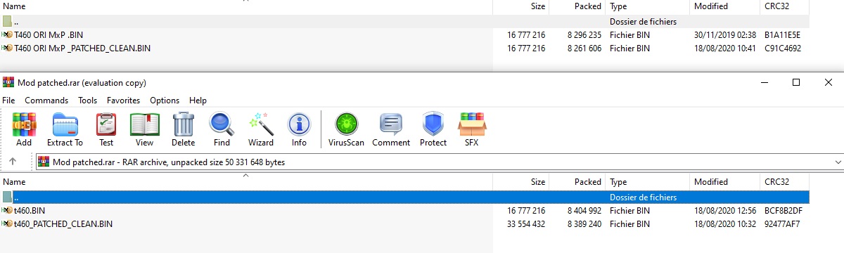

    This is the patched file using python27.
    Could you help me try patching it using your setup? T460.bin is the original file.
      your file t460 patched 32 mo
      my ori t460 patched 16mo
      very weird
      I don't understand why your file is 32mb while mine of the same model (t460) is only 16mb

          Oh wait, you mean you tried to patch my original file, but it is showing 32mb too right.
          Mmmmm.... I tried to patch using manual replacement of "lenovotranslate" and "bootoption", my machine can power on, but there is no display.
          • Maxpower3
            Bad Veteran
            • Feb 2018
            • 1355
            • France
            #45
            Re: LENOVO BIOS AUTO-PATCHER for Supervisor Password Removal
            yes if I patch your file, it is 32mb.
            and if I take one of mine it is 16mb.
            you can try my patch file for your machine that should unlock the Password.
            there is something else to modify than boot and translate for this model.
            nvram must also be cleaned up

                                OK... I found the reason why your file was doubling in size.
                                I rewrote the cleaning step of the script and modified the process. It should work as intended now.
