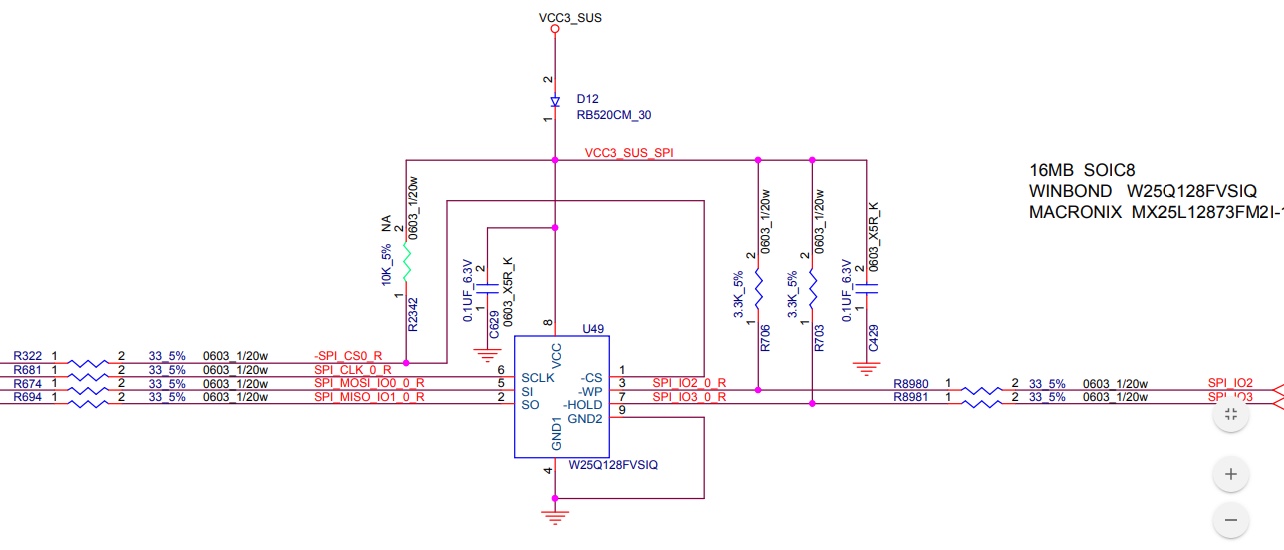

                            Hello, i was trying to remove supervisor password from x240 and its looks like i break something.
                            I desoldered w25q128fv and created backup and patched image using ft2232h and flashrom.
                            When i flashed patched bios and soldered chip again motherboard is turning on but there is nothing on the screen fan is working for a while and its turning off. so i desoldered bios chip again and flashed backup and its still not working? Is it possible that something broke by running patch? or is it something with soldering?
                            • Vesko356

                                • AAAC
                                  • Jan 2020
                                  • 458
                                  • Mexico
                                  #756
                                  Re: LENOVO BIOS AUTO-PATCHER for Supervisor Password Removal
                                  @jku131
                                  The resistors connected in series to chip DATA lines are 33 Ohms, PULL-UPS are 3.3k and the one for CS is 10k. Use picture as reference.
                                    Originally posted by AAAC
                                    @jku131
                                    It looks like elements on motherboard are good. I flashed back bios backup and after running it in x240 I read it again and it changed. So its looks like motherboard is able to communicate with this, but i dont know why its not booting and modifying bios.
                                    Diff: https://pastebin.com/0d4VxNDd in backup i have "ffff ffff ffff ffff ffff ffff ffff ffff" after running it its changed. What may be causing it not working?
