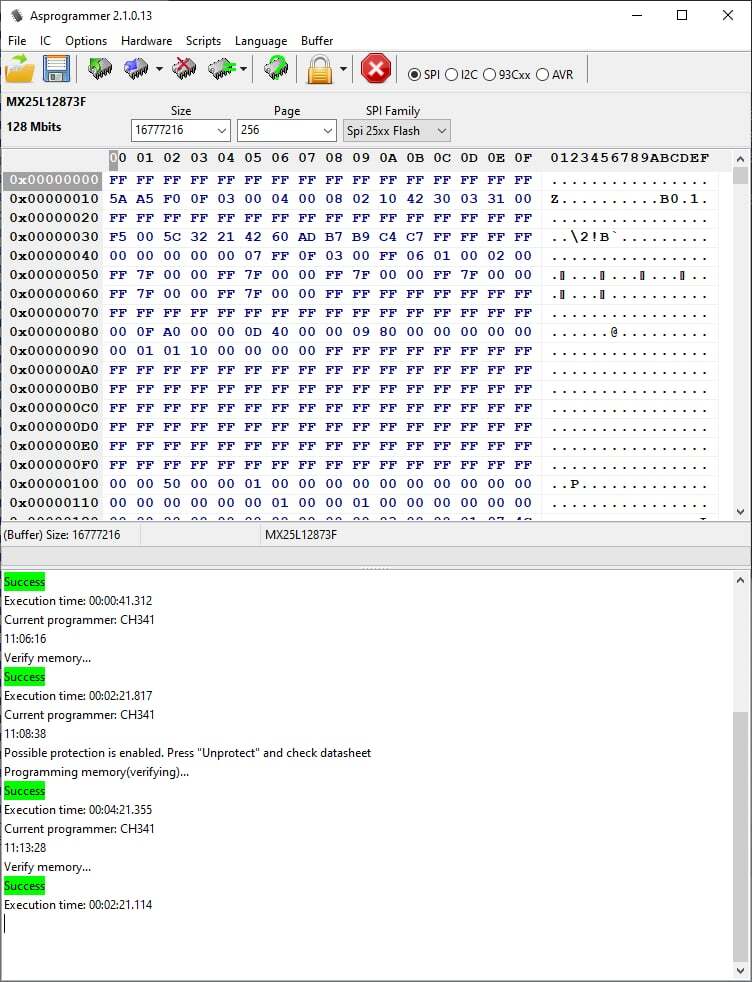

                          Hello!
                          I used autopatcher, rewrote the patched file in the bios, but as a result, when I press the power button, nothing happens.
                          I performed the first part (uploading patched bios and passing through empty fields, pressing the spacebar twice, etc.) using a clip.
                          While clearing memory before uploading the original batch, clip started failing (applications were freezing – neoprogrammer, asprogrammer, etc.).
                          So I desoldered the chip, cleaned it, uploaded the batch from the backup, and then verified it (I've attached a photo).
                          Unfortunately, the laptop wouldn't boot.
                          Only reaction is red LED (the one next to charging port) lighting up after connecting charger to any USB-C charging port.
                          Can someone help?

                            Originally posted by spink90
                            Hello!
                            Can someone help?
                            Laptop Lenovo X1 Yoga 3rd GEN
                            Type 20LE-SFO0X
                            Serial R9-0T1L2P
                            Original bios, backup bios, patched bios:
                            Try again with Autopatcher.

                              #3994
                              I'm asking just to be sure.
                              Should I desolder the chip, clean it(erase), check if it's empty(blank check), and then upload(write) bios from you on this chip, then solder it again?
                              Thank you for taking the time to respond.

                                  #3996
                                  @hoaca388
                                  After uploading your file, the laptop reacts as follows:
                                  Keyboard LEDs (FNLock/ESC) light up - LEDs light up for a moment (after connecting the charger - the BIOS battery and the laptop battery are disconnected).
                                  White LED next to the charging port lights up.
                                  Fan doesn't spin.
                                  Screen is black (no backlight).

                                    After flashing the patched BIOS (which worked yesterday it prompted me to enter the password (1234), then the hardware ID(enter), space 2 times, and then to turn off the machine, as instructed).
                                    Today I only get the power button to illuminate three times on white (a non-repeating sequence).
                                    I tested it with the BIOS/laptop battery disconnected - no change.
                                    • spink90
                                      • Sep 2025
                                      • 8
                                      • Poland
                                      #3998
                                      I compared this motherboard with same motherboard, and it turns out I'd probably ripped out one resistor (33 ohms) from the R2105 slot with clip.
                                      This might be why the computer isn't waking up?

                                        I pulled out second computer, identical to the one I tried before.
                                        I repeated the entire procedure.
                                        Patched BIOS booted, and I went through the process.
                                        I desoldered the chip and soldered the same chip from where the previously readed BIOS(2nd lenovo X1 3rd gen).
                                        As a result, both computers are dead – they won't boot, the fan won't spin, and the monitor won't backlight.
                                        I used lenovo_autopatcher_0.2.
                                        Type: 20LES3FQ0X
                                        Serial: R90T1L30​
