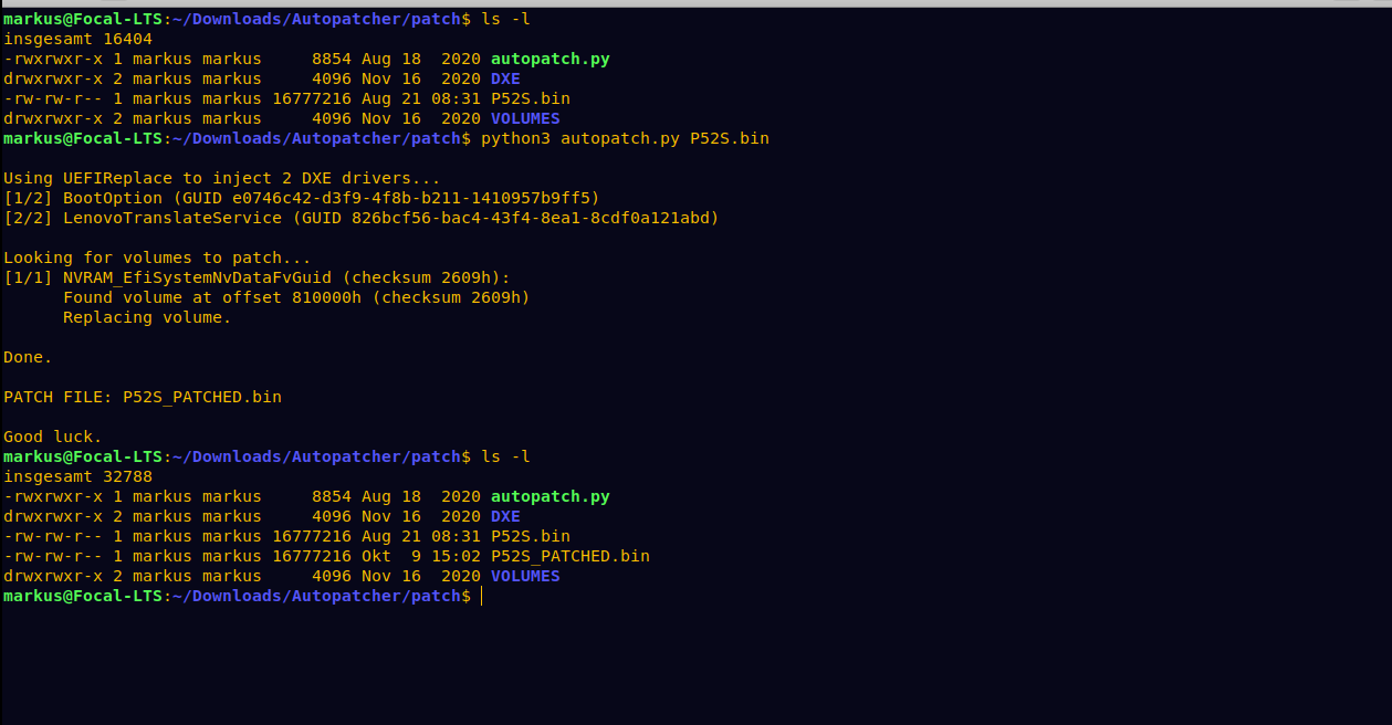

      Hello, I'm trying to use the auto patcher in the bios of my p52s but it gives me the same file or I can't find the new bios generated.
      Can someone please explain to me how to apply the patch correctly?

          #2864
          Re: LENOVO BIOS AUTO-PATCHER for Supervisor Password Removal
          Originally posted by Bbull
          Thanks Markus!
          PS: Might be a problem running it on ubuntu 22.04. It has Phyton3 out of the box. Therefore I had to change the script from phyton to phyton3. Furthermure I gave execution rights to "autopatch" and both UEFIReplace-Executables. But then still I get the above libQt5Core.so.5 error. Does anybody have an idea how to fix this?
          But you start the right script with the command:
          python3 autopatch.py P52S.bin
          Please don't ./autopatch P52S.bin, that won't work.
          Maybe my screenshot will provide some clarity, so of course I've been doing this all the time with a shell script.
          • bryanpku
            • Aug 2023
            • 2
            • Peru
            #2865
            Originally posted by Markus1741
            Try ....
            Thank you very much for the help
            I managed to remove the password and access the BIOS. I thought that by logging in I could correct the BIOS ACPI error but I couldn't
