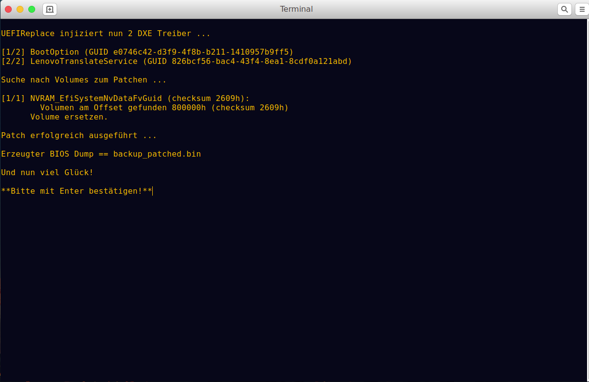

                                    • Bbull
                                      • Sep 2023
                                      • 2
                                      #2858
                                      Re: LENOVO BIOS AUTO-PATCHER for Supervisor Password Removal
                                      Originally posted by Knucklegrumble
                                      Finally, I would be grateful if you could report any bugs, errors, problems, or general feedback in this thread so that I can make improvements to the script.
                                      Txs 4 the great tool.
                                      However, I get the following error message on ubuntu 22.04:
                                      ./autopatch backup.bin
                                      Using UEFIReplace to inject 2 DXE drivers...
                                      [1/2] BootOption (GUID e0746c42-d3f9-4f8b-b211-1410957b9ff5)
                                      /home/thinkpad/flash/lenovo_autopatcher/patch/../tools/UEFIReplace: error while loading shared libraries: libQt5Core.so.5: cannot open shared object file: No such file or directory
                                      backup.bin is corrupted or does not contain a valid dump.
                                      There was an error... Aborting.
                                      But I think my backup.bin looks good (attached). Or what am I doing wrong?

                                        • Markus1741
                                          • Sep 2020
                                          • 847
                                          • N/A
                                          #2860
                                          It works ...
