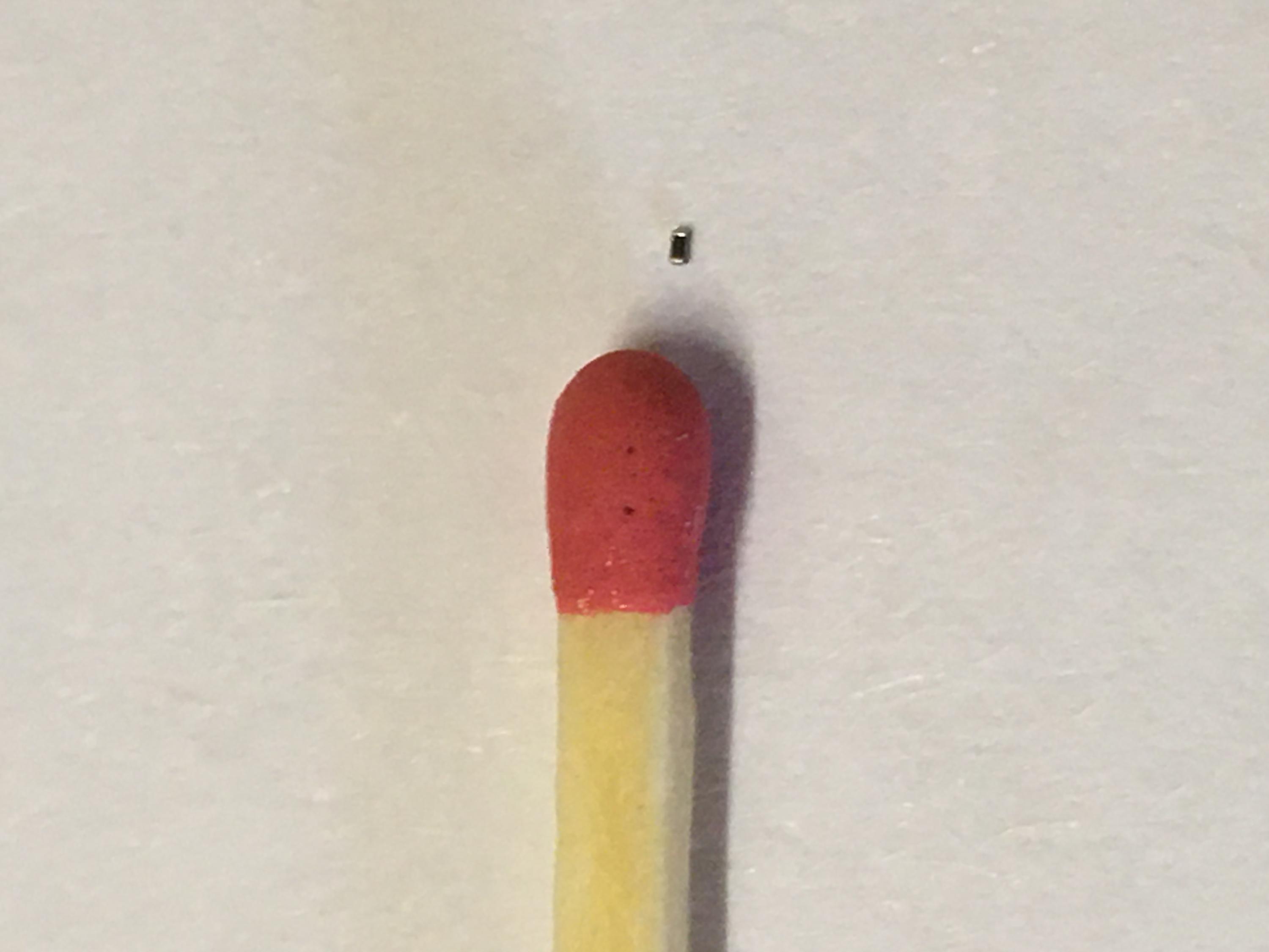

    Originally posted by Markus1741
    Oh the Lenovo T480s model is tricky the resistors are placed way too close to
    the EEPROM they can be damaged very quickly with the clip.
    This interrupts the signal path so that the BIOS can no longer start.
    Please be sure to look at the pictures, I've already had to repair it.
    Good luck ...
    looks like i did exactly what you said and knocked off resistors with the bleeping clip should have read this post and waited for my hot air station to arrive. Is it poosible to fix? will bridging the pads work? these things are so tiny i cant imagine fitting new ones

        #2823
        Re: LENOVO BIOS AUTO-PATCHER for Supervisor Password Removal
        Hello, you can try to bridge the resistance with a solder bridge.
        I can't guarantee that it will work.
        I've also read that this was done.
        It's all too good that these resistances are very small.
        Design 0201
        Here is a size comparison.
        Good luck.
