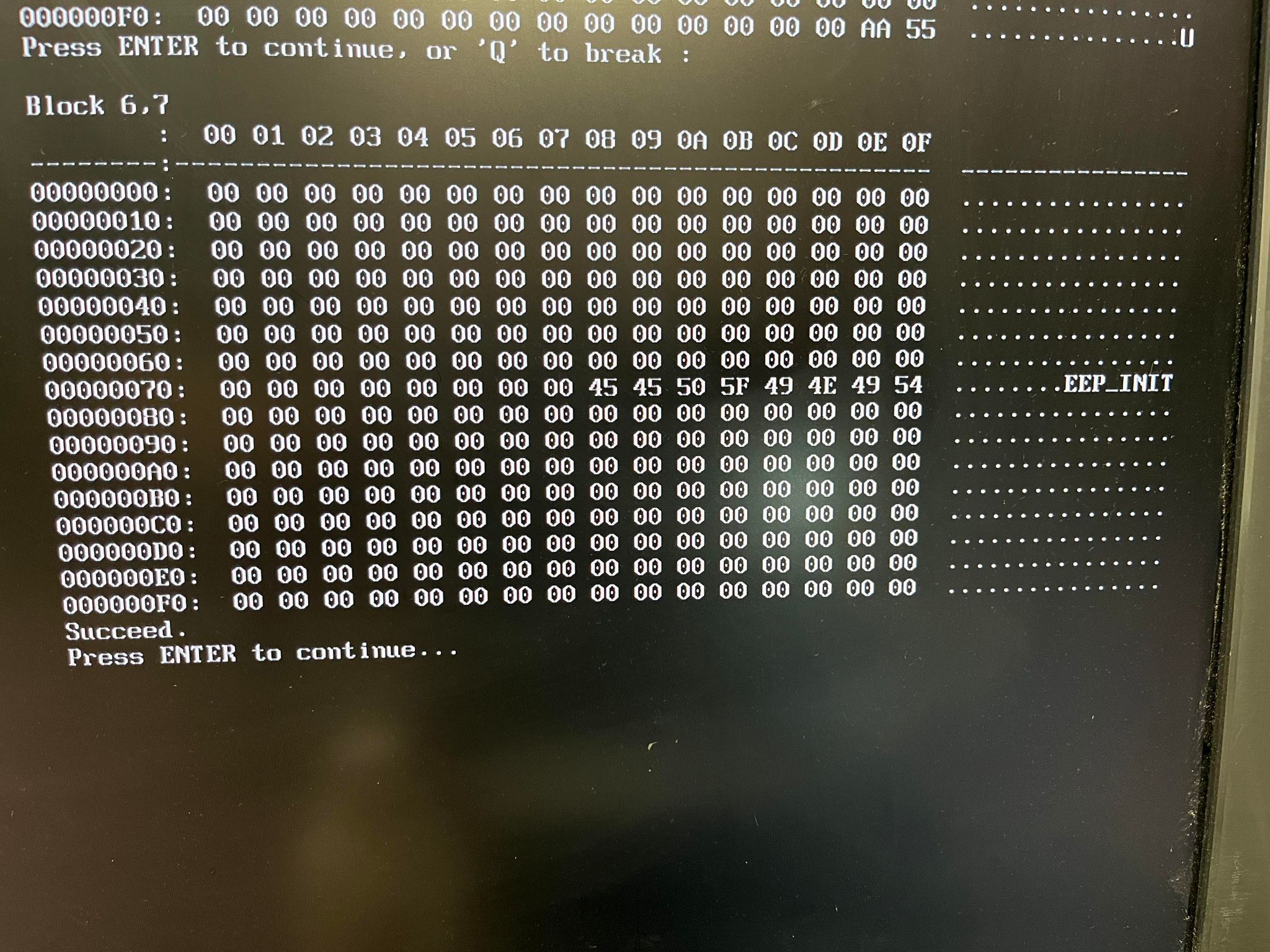

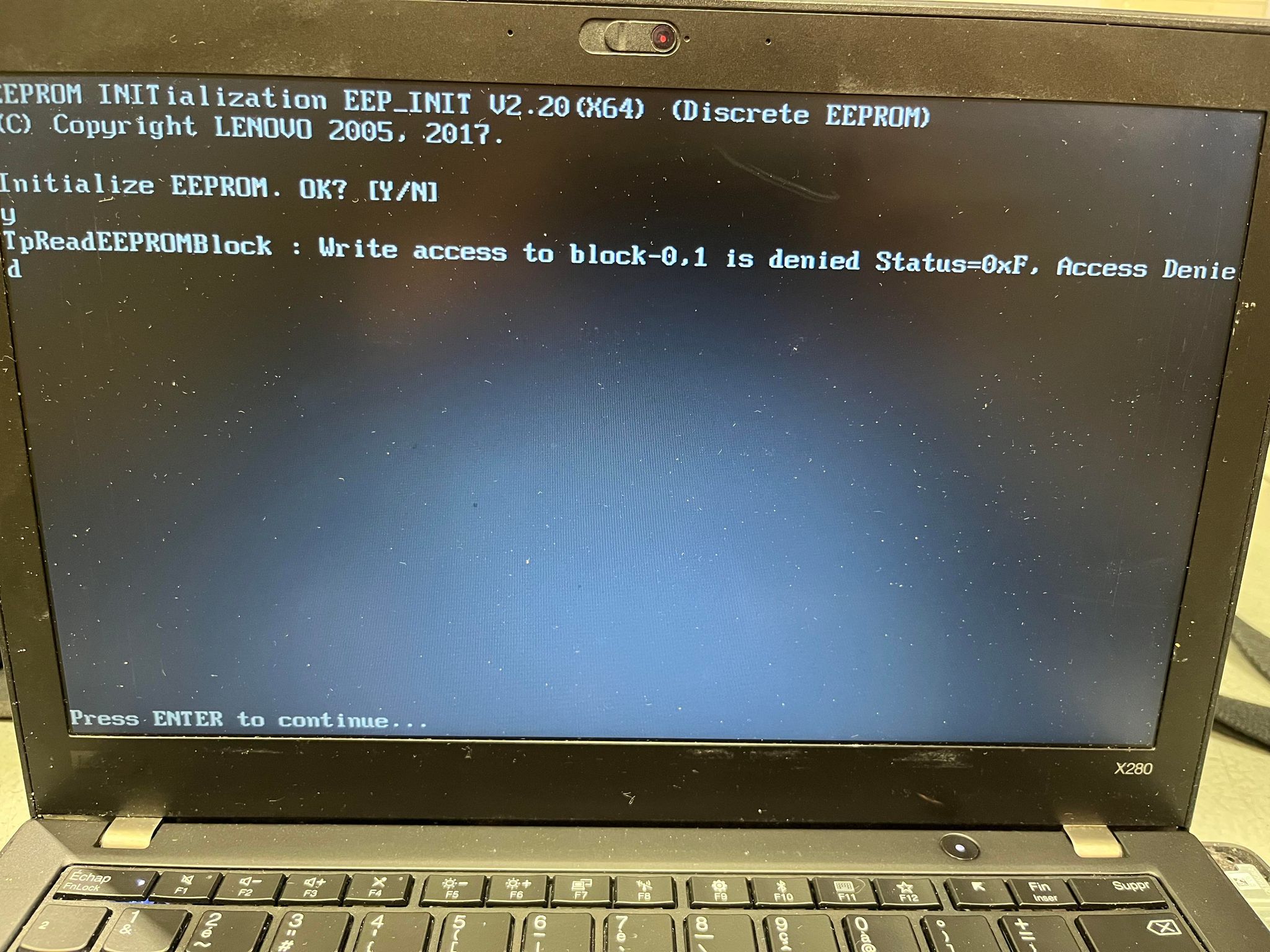

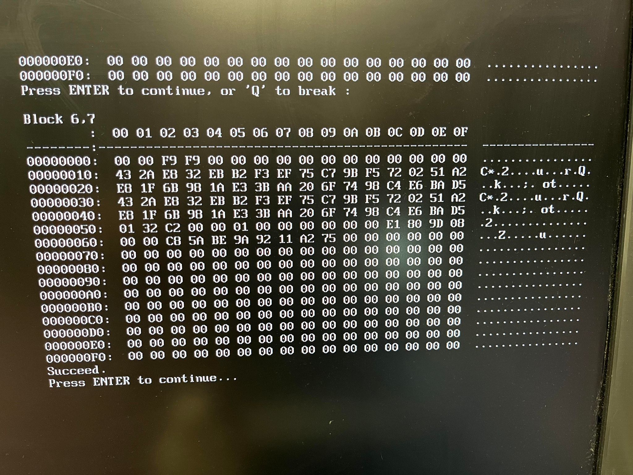

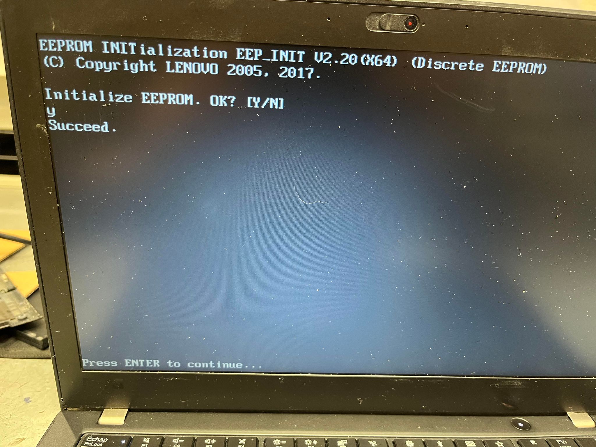

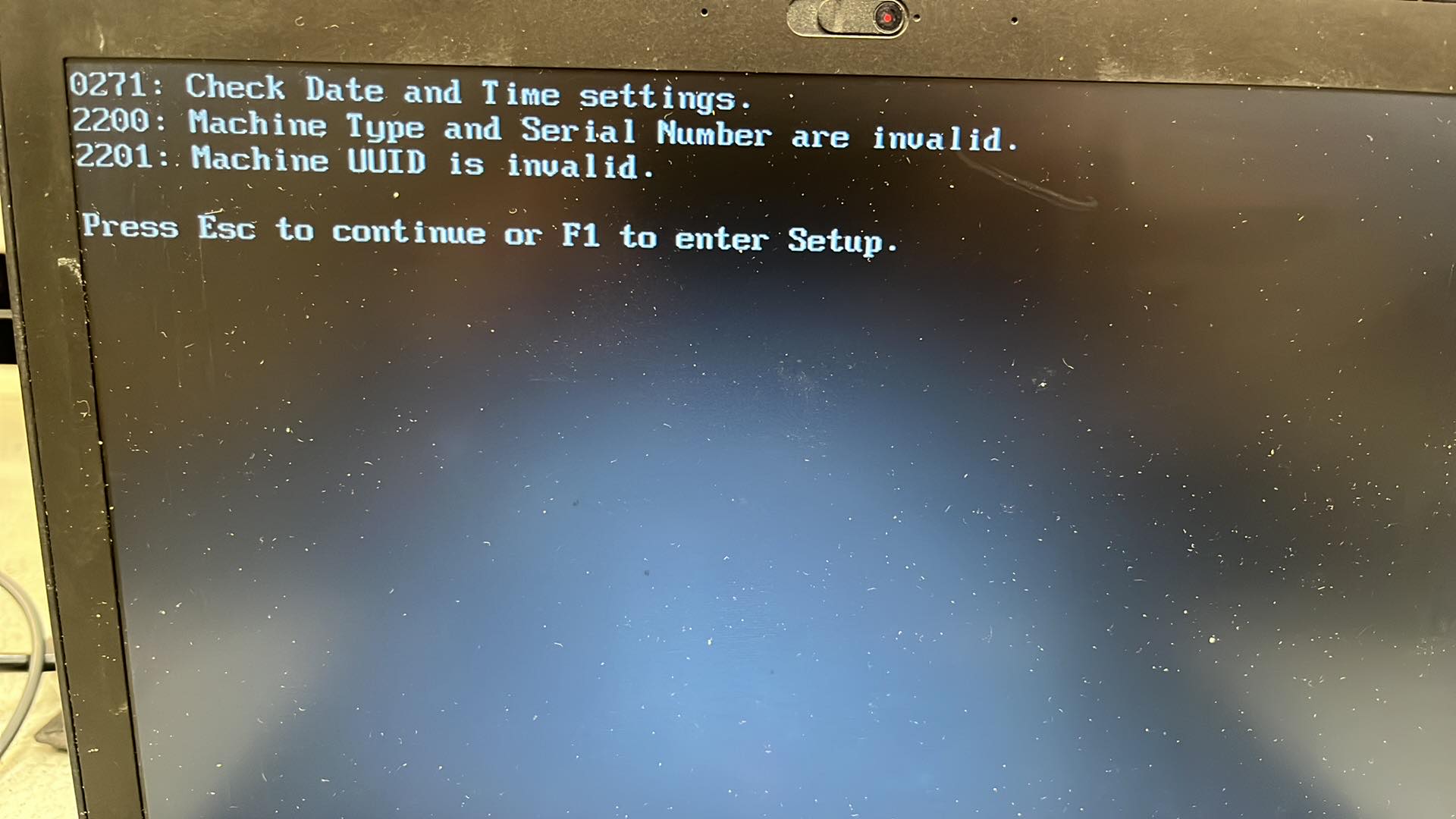

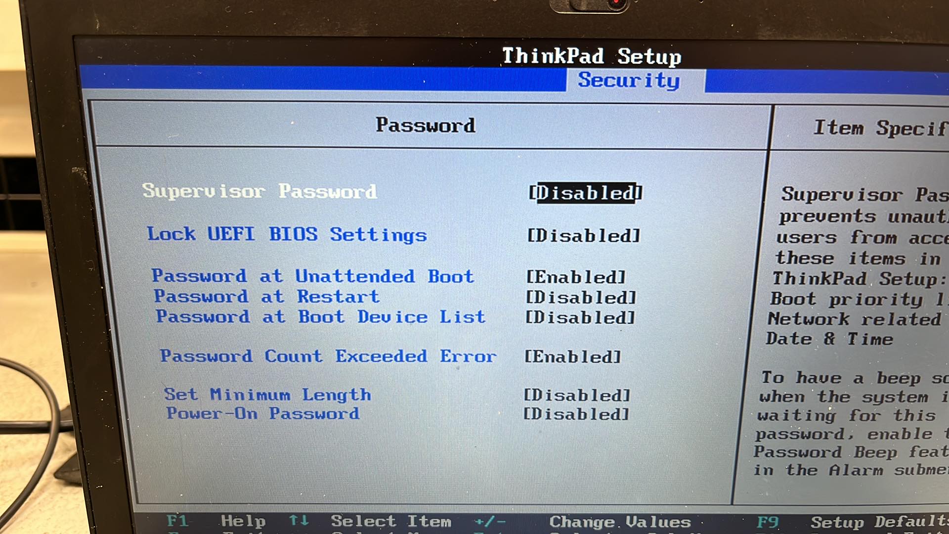

    I will use the SUCCESSOR programmer to read and write MEC1663 to unlock the SUCCESSOR of Lenovo's 8th generation cpu, but MEC1503 NPCX897KA0BX cannot use the successor to read EEPROM, can you use the USB disk to unlock it?Can you give us a general idea
    The maintenance disc can perform a reset to EC or 24rf08 (for older models) and erase all content including password and DMI information.
    You will end up with an empty dump.
    ERRATUM:
    need permissions, I made a mistake, I will not perform the total power off and the read/write permissions were still active.
    after extinction I can no longer erase certain blocks
    look pics
    before and after clean
    exemple :t14s Gen1 I7 10th gen

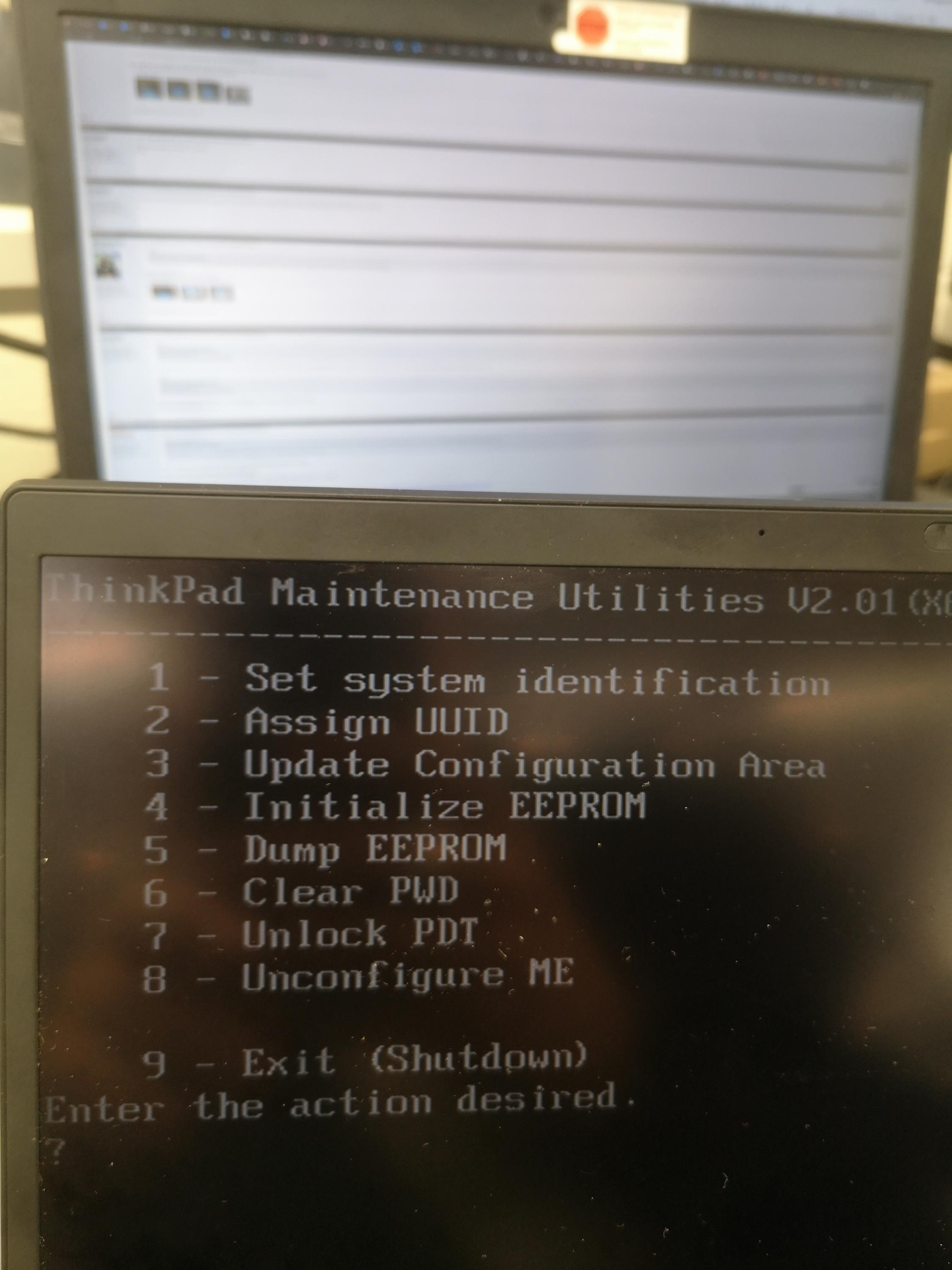

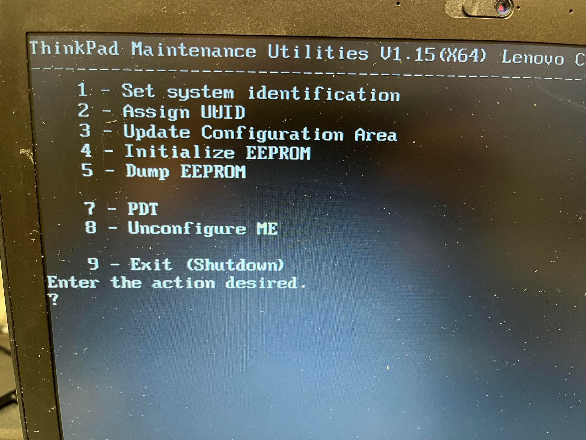

          I found the following information in ThinkPad Maintenance Utilities, I wonder if it will add progress to our research
          [advanced features]
          ; hide_adv = 0 ; Advanced Menu
          hide_adv=1 ; Traditional Menu
          hide_eep_init = 0 ; show "5 - Initialize EEPROM"
          ; hide_eep_init = 1 ; hide "5 - Initialize EEPROM"
          ThinkPad Maintenance Utilities can erase the password area when the correct super administrator password is entered, ThinkPad Maintenance Utilities will disable reading and writing the password area when the password is present, We need to remove the ThinkPad Maintenance Utilities that forbid reading restrictions, so that the USB key decryption success
                [advanced features]
                I found this but it does not unlock 6: reset PWD.
                that's why I was fooled because the word was still in my memory and the clean was working.
                we lose the planar function on the other hand if advanced menu is active
                Edit:sometimes I manage to bypass the security and it works after multiple restarts. I still haven't understood why?
                The battery and battery are removed to be sure of unlocking

                  ThinkPad Maintenance Utilities V1.19(X64)
                  • wuyaping
                    • Jun 2022
                    • 20
                    • china
                    #2709
                    Re: LENOVO BIOS AUTO-PATCHER for Supervisor Password Removal
                    Are you saying that you successfully bypassed the security measures and erased all DMI messages containing passwords using Initialize EEPROM?
                      just use the enter key
                      https://clipchamp.com/watch/9ZOGyad492i
