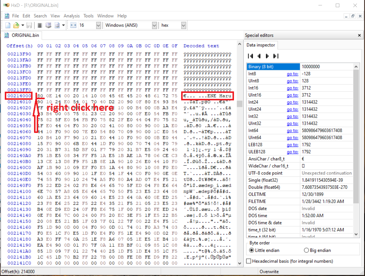

                    BL50 LA-D704P How to extract EC bios from Main Bios
                    Hello. Anybody knows how to extract EC firmware from Main bios? I have 8 MB main bios and I need to extract SIO bios because of SIO replacement. Thanks

                          It can be copied from your bios backup using a hex editor.Post your backup

                              Search for some words like ITE ,ENE,HARU,J7IFT
                              214000 -

                                Re: Hp bdl50 la-d704p rev:1.0
                                Please, try to be more clear.
                                There are several parts of the file with the writing "ENE" (in this case): which of these to consider?
                                Once I found the correct one, what should I do to get only the part for the EC (I suppose it should be of 128 KB)?

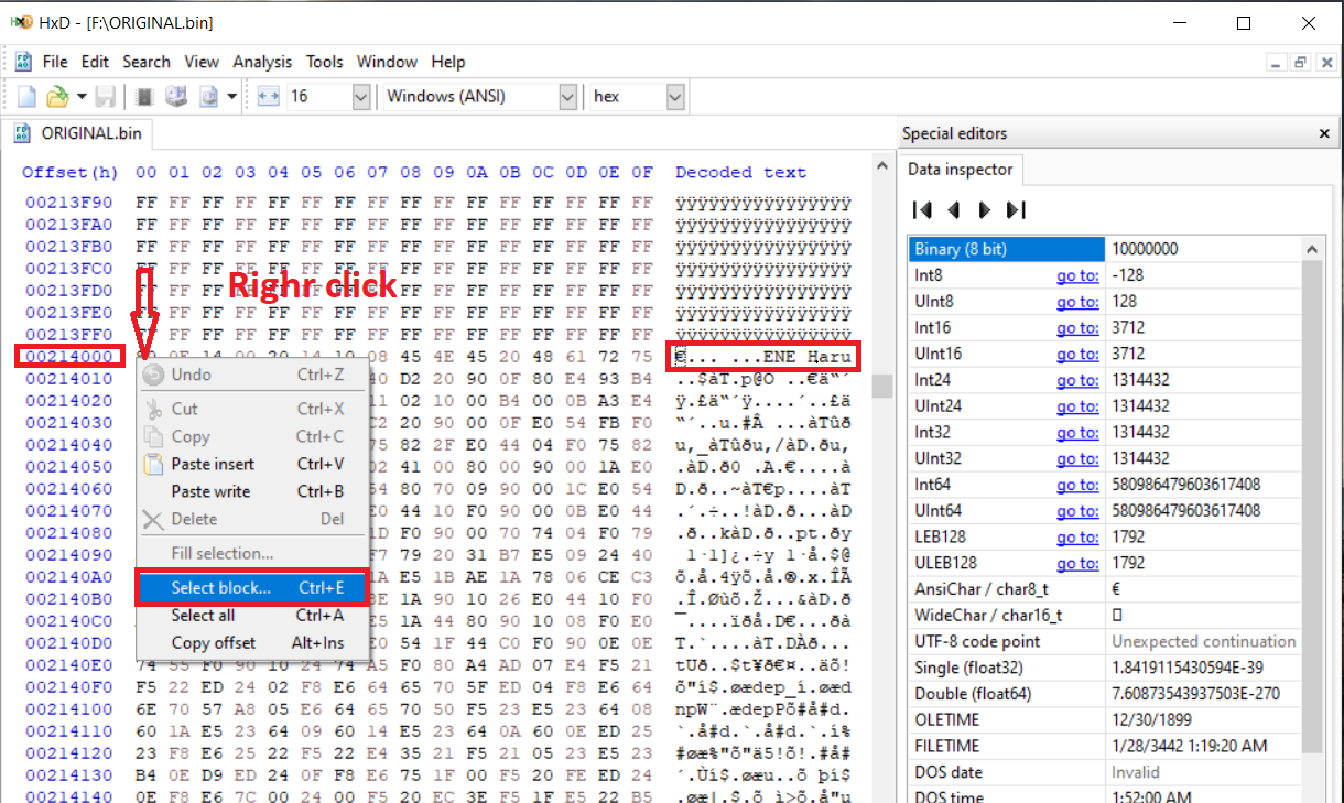

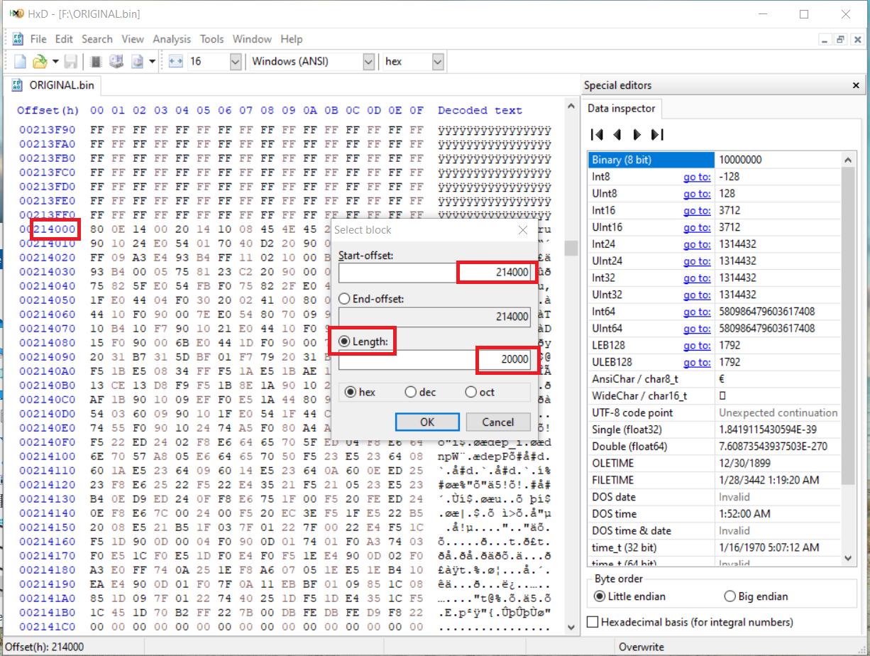

                                  try this..
                                  use the HxD program..entert the bios in the program, type search..ENE ... KEY f3 UNTIL YOU REACH THE VALUE 214000 and then check 128kb or (20000) new copy-paste
                                    please, try to be more clear.
                                    There are several parts of the file with the writing "ene" (in this case): Which of these to consider?
                                    Once i found the correct one, what should i do to get only the part for the ec (i suppose it should be of 128 kb)?
                                    20000 = 128kb
                                      All clear now. Thanks guys
