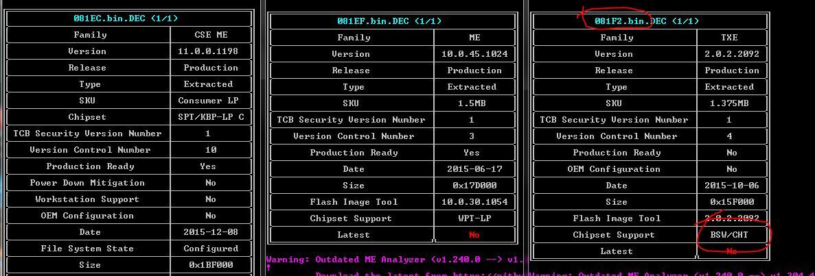

          • 20898
          Originally posted by m041633n
          Tried the First One 081EC From the 5 BIN file's (081EC, 081ED, 081EF, 081F2, 081F3) which was extracted and decrypted already with the BIOS Update Utility from HP.
          But still the Same issue
          The 15-be002tu has a Braswell (BSW) N3710 CPU -> https://support.hp.com/au-en/document/c05161809
          The 081EC bios has ME 11 firmware,so it is the wrong bios. Check all of the 5 extracted bios with ME Analyzer ,the chipset support should say BSW/CHT

            Tried it! But it didn't work πŸ˜• πŸ˜ͺ
            It's still the same.
            Checked the Old Bios Backup with ME Analyzer it says BSD/CHT on the chipset support and checked the New BIOS 081F2.BIN it was matching the same chipset support
            How to start checking with the multimeter on which component with what settings on the multimeter. I don't know component level checking. It would be better if someone has the same board and same issue like mine and explain how did they resolved it. Please Help 😊 desperate to solve this case.
