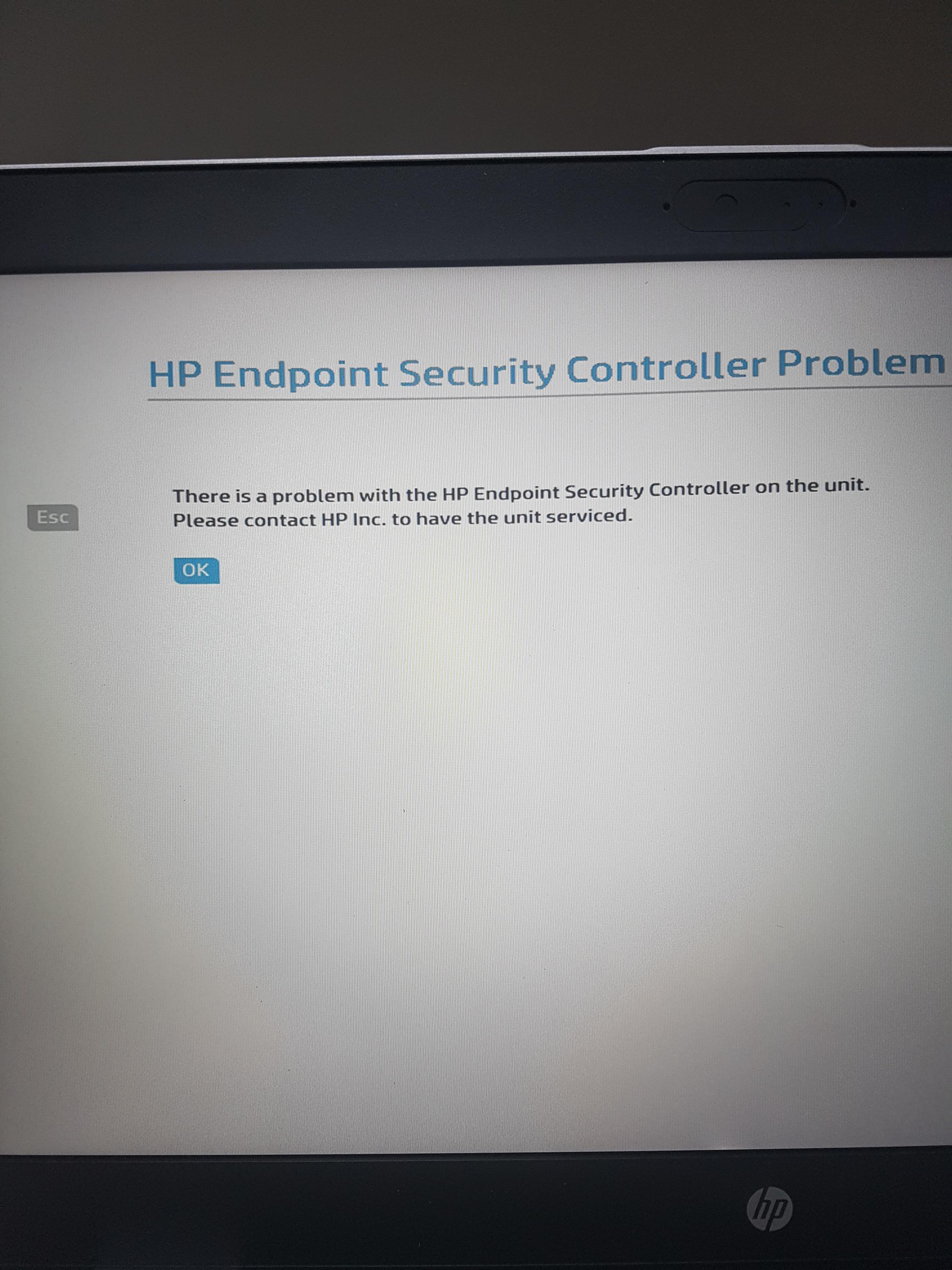

                  i have found the same board coconut 6050a3028501-mb-a01
                  i have copied bios and ec but i get an error
                  can someone clear me?
                        any sulution ????????
