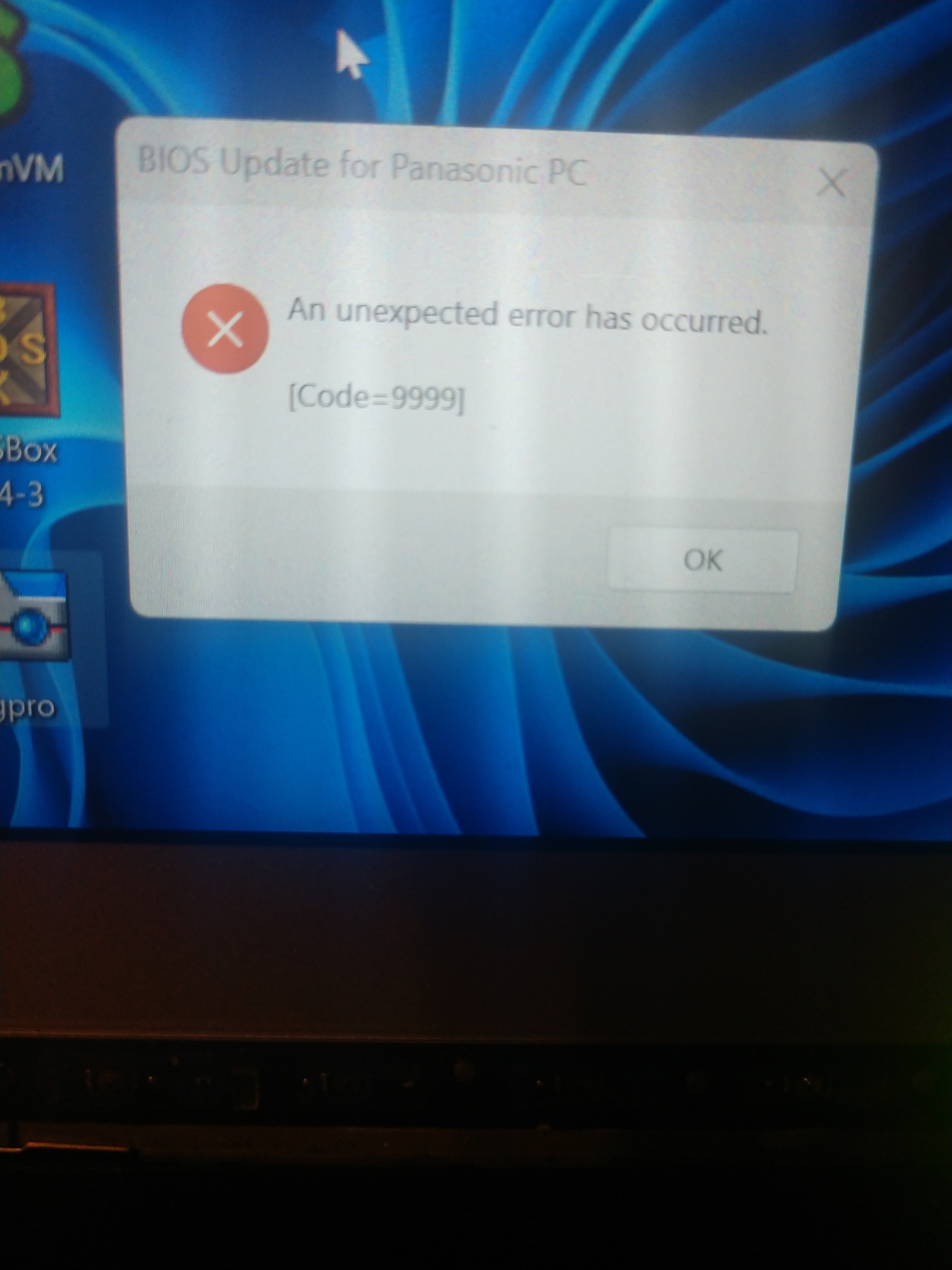

    Need help... BIOS is not locked, system starts and perfectly works from USB but device hangs during POST if any SSD presents in its M.2 slot inside the case instead of connecting via USB3 and USB-M2 adapter as I have to work for now.
    This issue has appeared after macOS update (yes, a third system on it is Hackintosh).
    First time I've got this problem after same action - the seller simply changed a whole device by warranty. I've thought it was a hardware problem with SATA controller. So now I think that system updater rewrote some UEFI areas - CMOS battery removing didn't help. BIOS update program fails with unknown error (code 999 IIRC).
    Panasonic CF-20mk2
    Model CF-20G5-05VM as printed on label (or CF-20G5108VM / CF-VEK206LM as shown in BIOS setup)
    Serial 9FKKC22343 as printed (2nd serial in BIOS setup after slash is 9FKKC22328)

      Flashed back. Totally same.
      Flash update error looks like this.
        SMDFlea commented
        Editing a comment
        You must flash the bios with an SPI programmer

      I did. Screen pgoto just demonstrated firmware update error after soldering BIOS back.Main promlem did not solved and I can use internal SATA only with another BIOS dump from this thread: https://www.badcaps.net/forum/troubl...41#post3298641 . Anyway I still have to inject an ME region manually.
