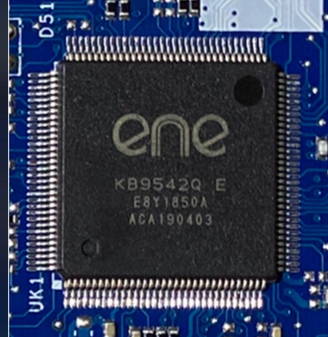

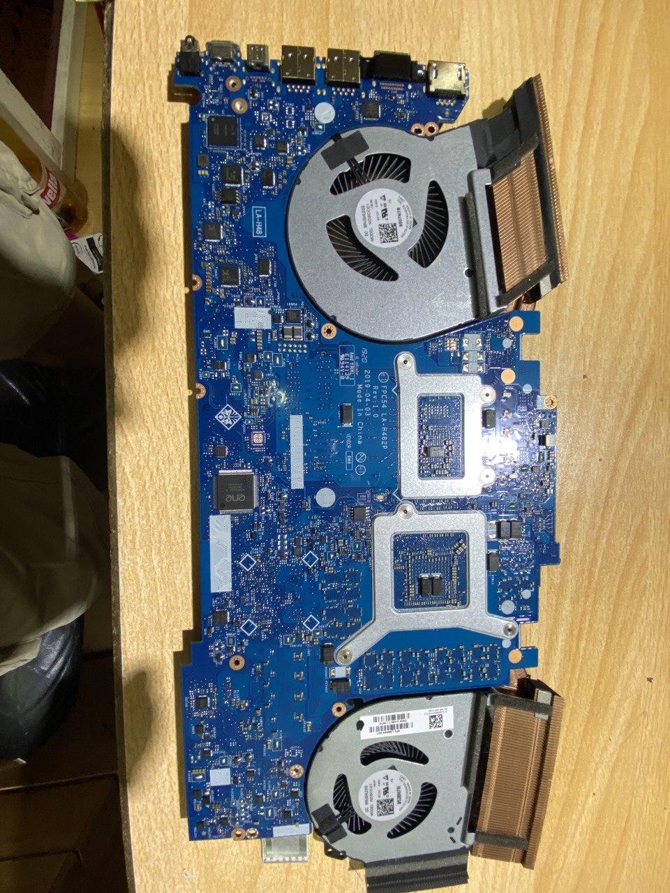

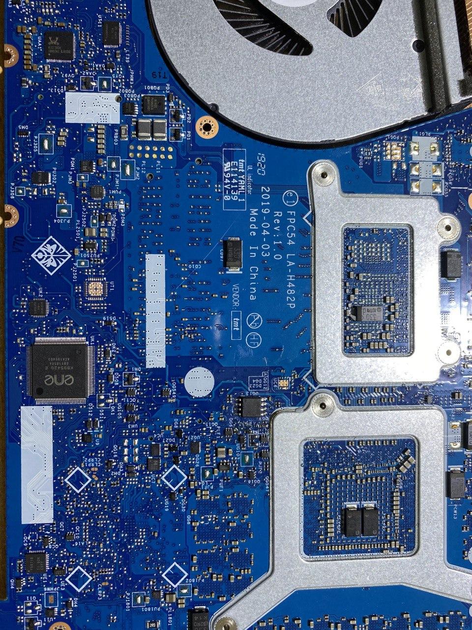

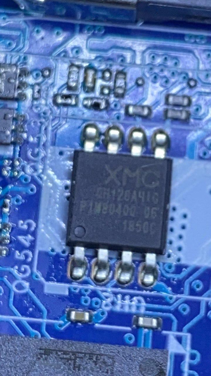

    i have a HP Omen model number 15-dh0904nz
    i have add a power-on password .
    just make the update of the bios ,now the pc dont start tell me wrong password
    now i dump the bios .with SVOD3 .the bios have same size of the bios in hp support site
    pls can any one help to unlock it

    Your bios is corrupt. Download the bios update from HP: https://support.hp.com/us-en/drivers...model/29625666 .Run the EXE and make a USB recovery drive. Try the recovery method first,if it doesn`t work run the exe again,select copy. There are 4 different bios, yours is 08600.bin (or copy it from the recovery drive) .You will lose DMI info by flashing a virgin bios and youll need to use HP BCU bios config utility,or nbdmifit to add the missing info ,serial etc .

          All the info you need is on the sticker on the case or in the battery compartment ,you can look through the old bios as well with a hex editor. See this video for HP BCU https://www.youtube.com/watch?v=r2ubpyeUOB4
          EDIT: If you can use a hex editor you can copy the DMI info from the old bios, 351000 - 351FFF (length 1000)
