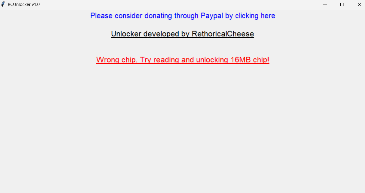

                                #57
                                RCunlocker on my laptop is not readable. can you make one for me please?
                                Click image for larger version  Name:	Screenshot 2025-08-05 201955.png Views:	0 Size:	45.7 KB ID:	3698025

                                  #58
                                  16MB chip, on the other side of the board U366

                                    #59
                                    Can someone help me remove the BIOS password and serial number? I'm going to flash it on several HP 830 G6 laptops.
                                    Model : HP Elitebook 830 G6
                                    Serial : -
                                    Problem : Remove Bios Password & Serial Number
                                    on the other hand there is only a BIOS that is 1MB in size (W25Q80DV)

                                    #60
                                    Motherboard : CATALONI-6050A3022401-MB-A01 (A1)
                                    Ok my BIOS 32MB, but HP unlocker / RCUnlock must 16MB
                                      SMDFlea commented
                                      Editing a comment
                                      If you have U366 use RCUnlocker if it`s 16MB. If it`s 32MB post it here
