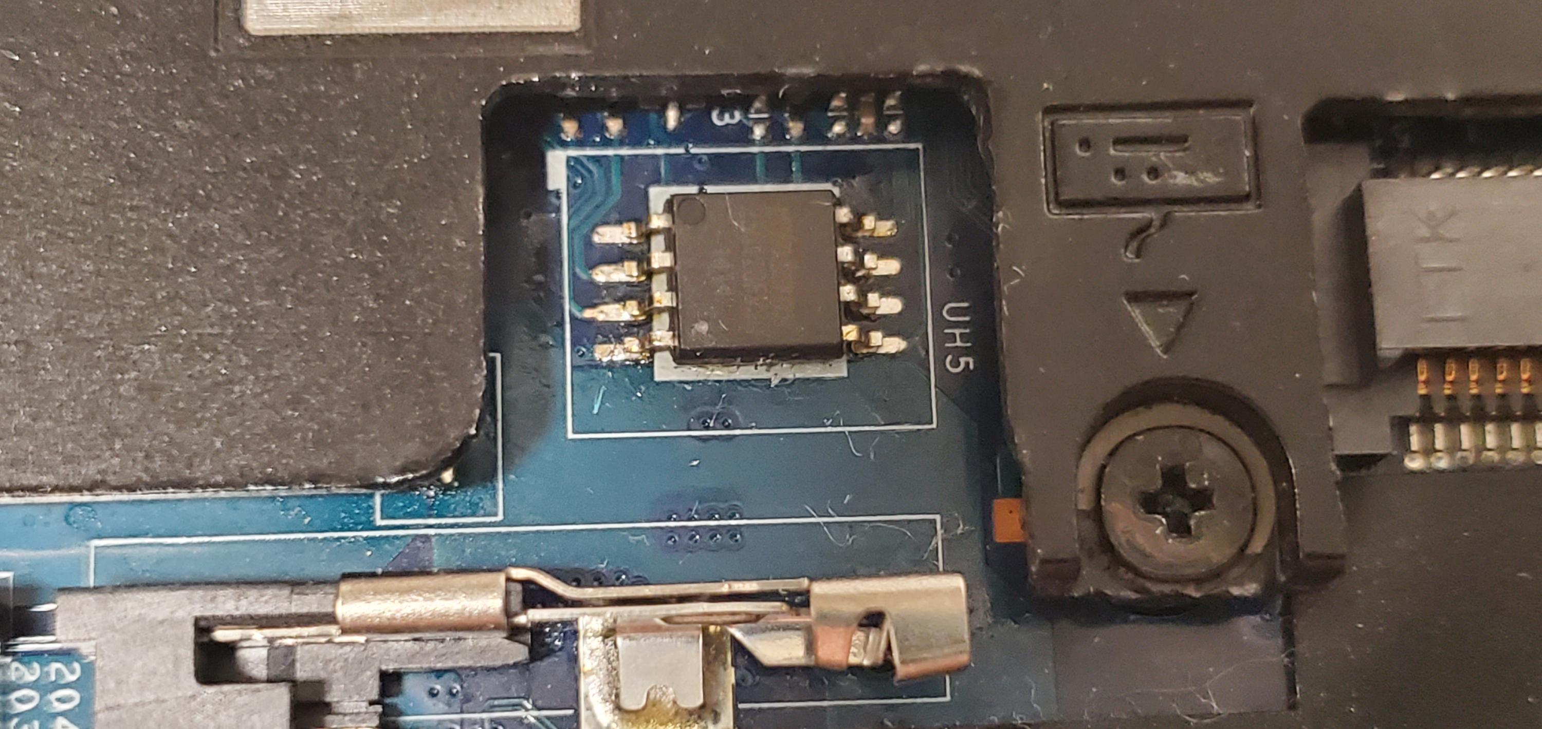

    Hello everyone. I need EC and BIOS dumps for HP Zbook G1, board number LA-9241P. My old dump is crashed. I need dump with MPM unlocked, because I need to move DMI informations like serial number etc. Thank you.

      Thank you for reply. Unfortunately I have not the dumps. I bought new EC and BIOS chip to reprogram it, but I have not old backup. It's my mistake, I was thinking if are crashed are just useless. But in the attachment I have dumps, which are tested by me and working. Only problem is no possible of DMI informations change.

            I tried this dump. Notebook trying to work, but only all LED's are on, fan working at full speed and nothing else. Can you clear ME Region in dump, which you sent me?

                  Hello again. This dump work just perfect. MPM is unlocked for 10 power-on cycles and I can change DMI informations. Thank you and peste for great help. I am very grateful.

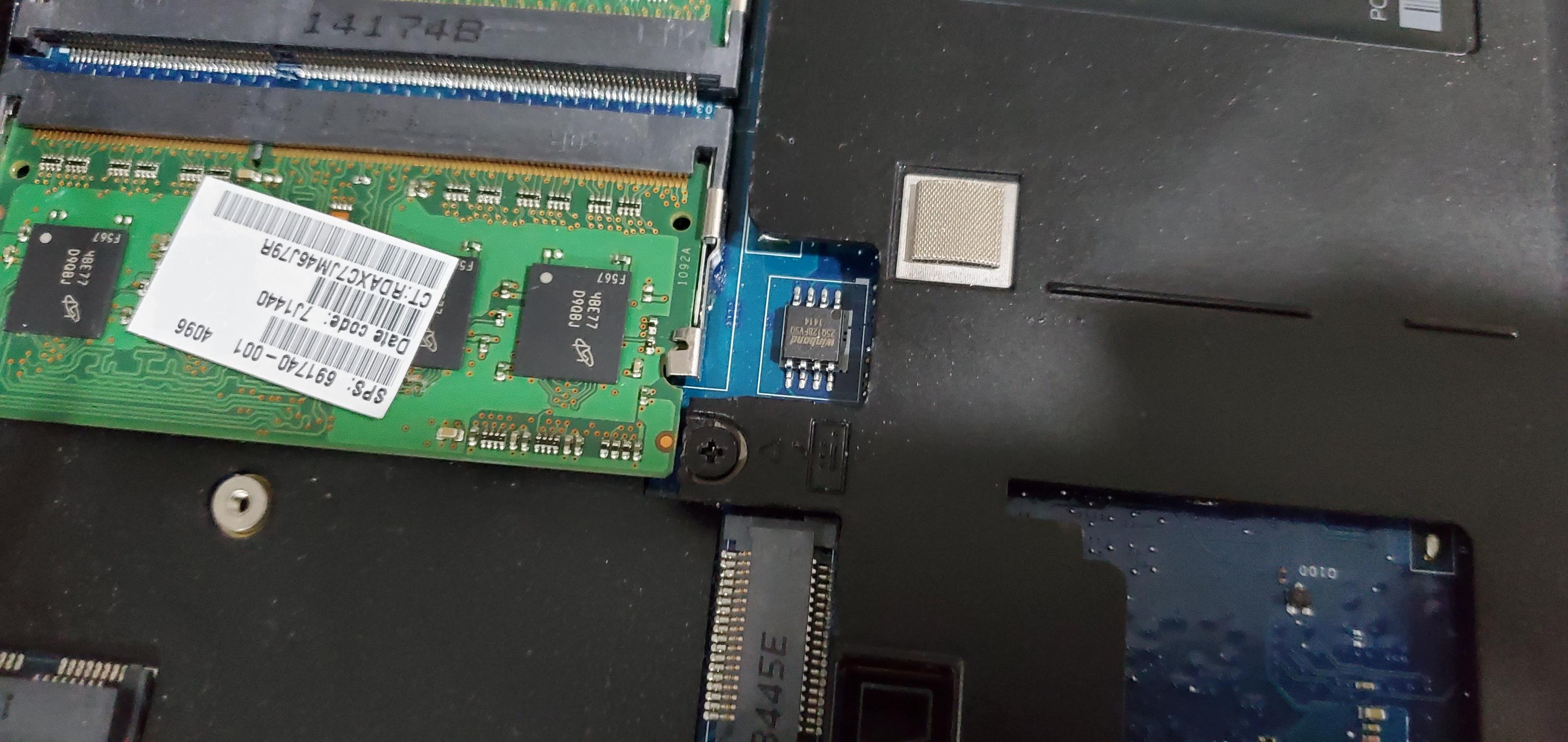

                            Hello, I have HP Zbook 15 G1 that uses Winbond 25Q128FVSQ. Just recently, I disabled my Hybrid Graphics option through BIOS then after reboot, I'm getting 4 blinks of Capslock and numlock meaning I have Graphic interface controller error, from HP troubleshooting guide. I already removed the CMOS battery hoping it will reset to default but not working. I also tried to use their USB BIOS Recovery but to no avail.
                            Would reflashing BIOS dump will make this go away? or is there another way to restore my default settings?

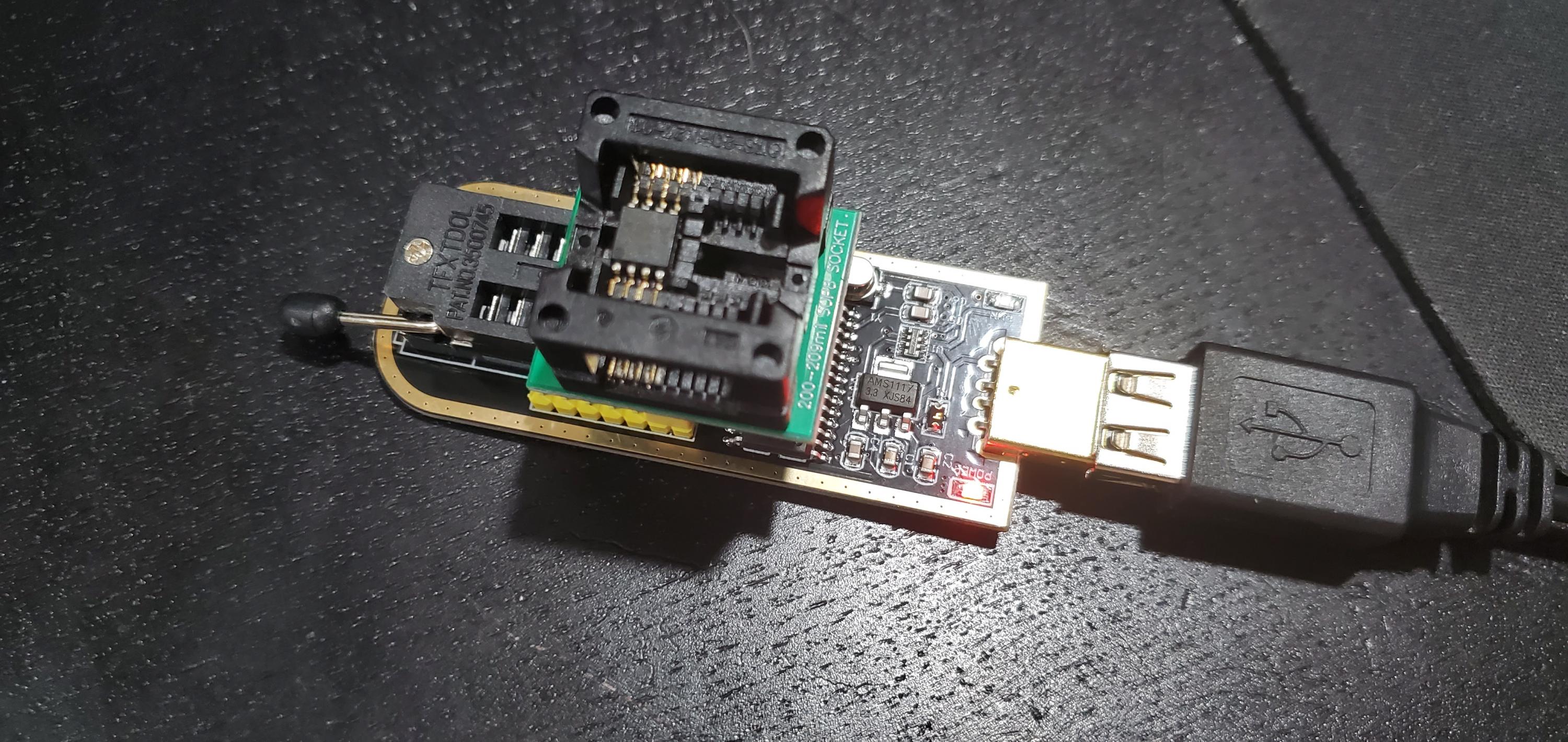

                                Thanks for replying! About the original corrupted BIOS file, I just ordered CH314a to read my bios Winbond 25Q128FVSQ 1412. I'll keep you posted. I'll use this thread instead.
                                By the way, are you guys taking off the motherboard inside the laptop before you reflash or i just need to disconnect the CMOS batt and laptop batt?

                                  ideally, remove the bios chip from the board and put it in the programmer ... if you don't have desolder ...solder wires between the motherboard and the programmer ... don't use the clip, you might have errors. ..use these programs ..
                                  https://www.youtube.com/watch?v=DWWigscuQDY
                                  https://www.badcaps.net/forum/showpo...6&postcount=10
                                  https://www.badcaps.net/forum/showpo...04&postcount=7
