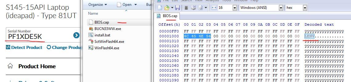

                            Hello.
                            Lenovo S145-15API 81UT, gs440&gs540 nmc511 rev 1.0
                            The laptop's LED was flashing and it wouldn't boot. I uploaded the bios from the Internet and the laptop started up. Unfortunately, I can't cope with copying DMI to the new bios. Can anyone find the DMI in the old bios?
                            EDIT
                            sn PF1XDE5K

                              Originally posted by Dominiks1980
                              Hello.
                              You must post the laptop serial number - https://www.badcaps.net/forum/troubl...before-posting
                              Is the bios you attached the original one,the DMI is corrupt.Find another S145-15API bios in this thread to use with someone elses DMI in it (and the windows key),the laptop will work.If you want to change it try the U1 tool and Thinkpad config info utility - https://www.badcaps.net/forum/troubl...ls#post1622424

                                I added the serial number to the post
                                The bios that I attached to the post is a bios downloaded from a laptop, I don't know if it is original. Searching for the serial number in the hex editor does not find it. Could this not be the original bios?
                                  The DMI is encrypted so you can`t see the serial in the bios.The Offsets are 1000 - 2FFF ,starts with the word LENV. Sorry i didn`t look at it more carefully earlier,it looked like it was empty but there is some code there.If you want to copy the DMI yourself you`ll find everything you need at post 342

                                    #397
                                    I already copied 1000 - 2FFF before adding the post, unfortunately it didn't help.

                                      #398
                                      In post 326:
                                      "The DMI and Key is at these offsets DMI 520000 - 5207FF , Key 62D000 - 62D03F​"
                                      Only it's not in my bios 5207FF​ and 62D03F
                                        In post 326:
                                        I edited my post ,its at post 342 now,that post used to be at 326 ,two threads might have been merged together. Anyway here`s your bios + DMI .If its not wiorking you can try older versions ,and if they don`t work you have a hardware problem

                                          #400
                                          The bios I added to the post does not work. This is the bios that was in the laptop. I searched the Internet and downloaded the BIOS which works. Now I want to experience DMI from the Bios that I added to the post, to the BIOS from the Internet that works.
