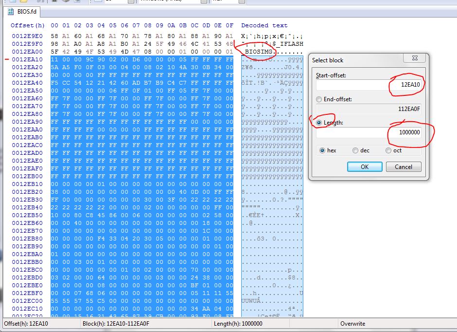

                                Originally posted by Vesko356
                                I need the latest one.
                                just like this one from DKCN55WW Update but I don't know how to extract it.
                                  • 21641
                                  #336
                                  Re: lenovo IdeaPad S145 bios needed
                                  Use a hex editor,search for the word BIOSIMG ,the line below that is the bios. See the picture for the start and end off-sets ,copy into a new file then save.If you want to copy your DMI see post post 342​
                                  HxD Hex Editor -> https://mh-nexus.de/en/hxd/
