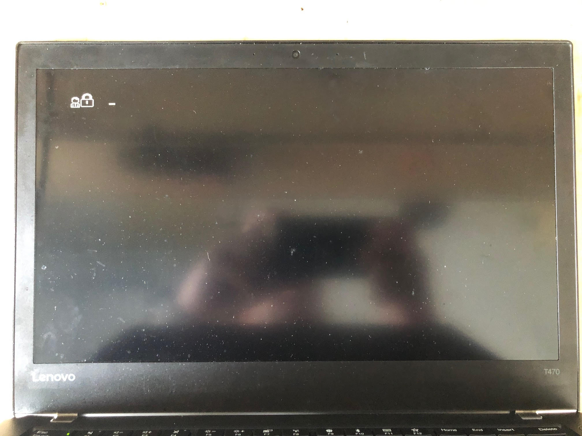

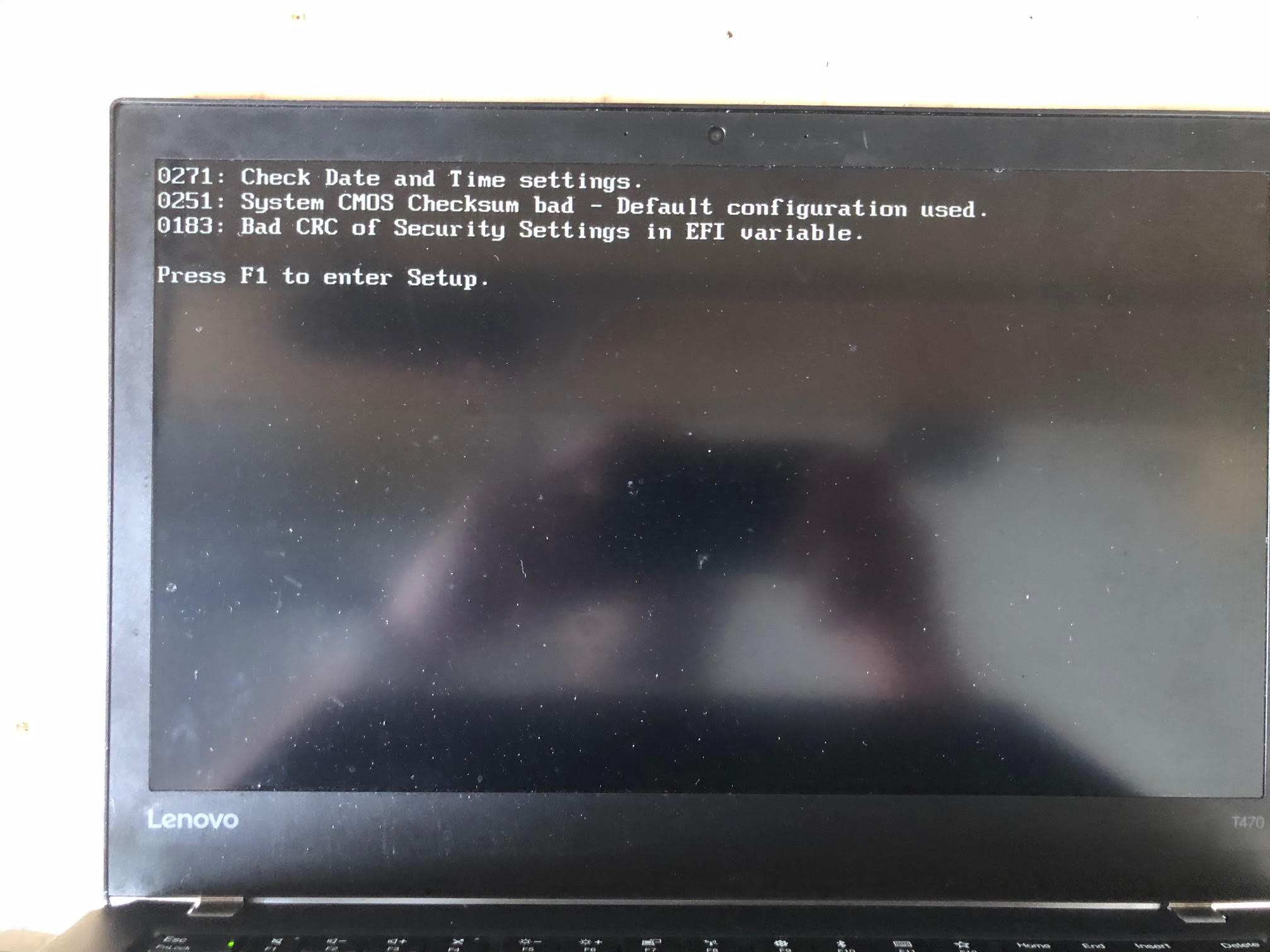

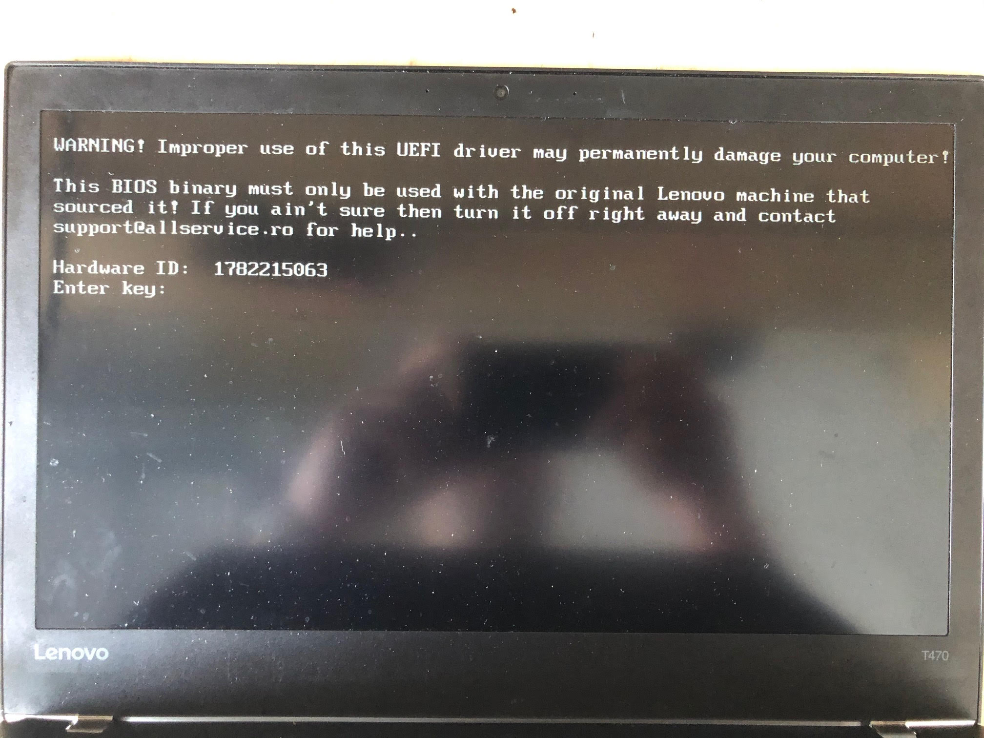

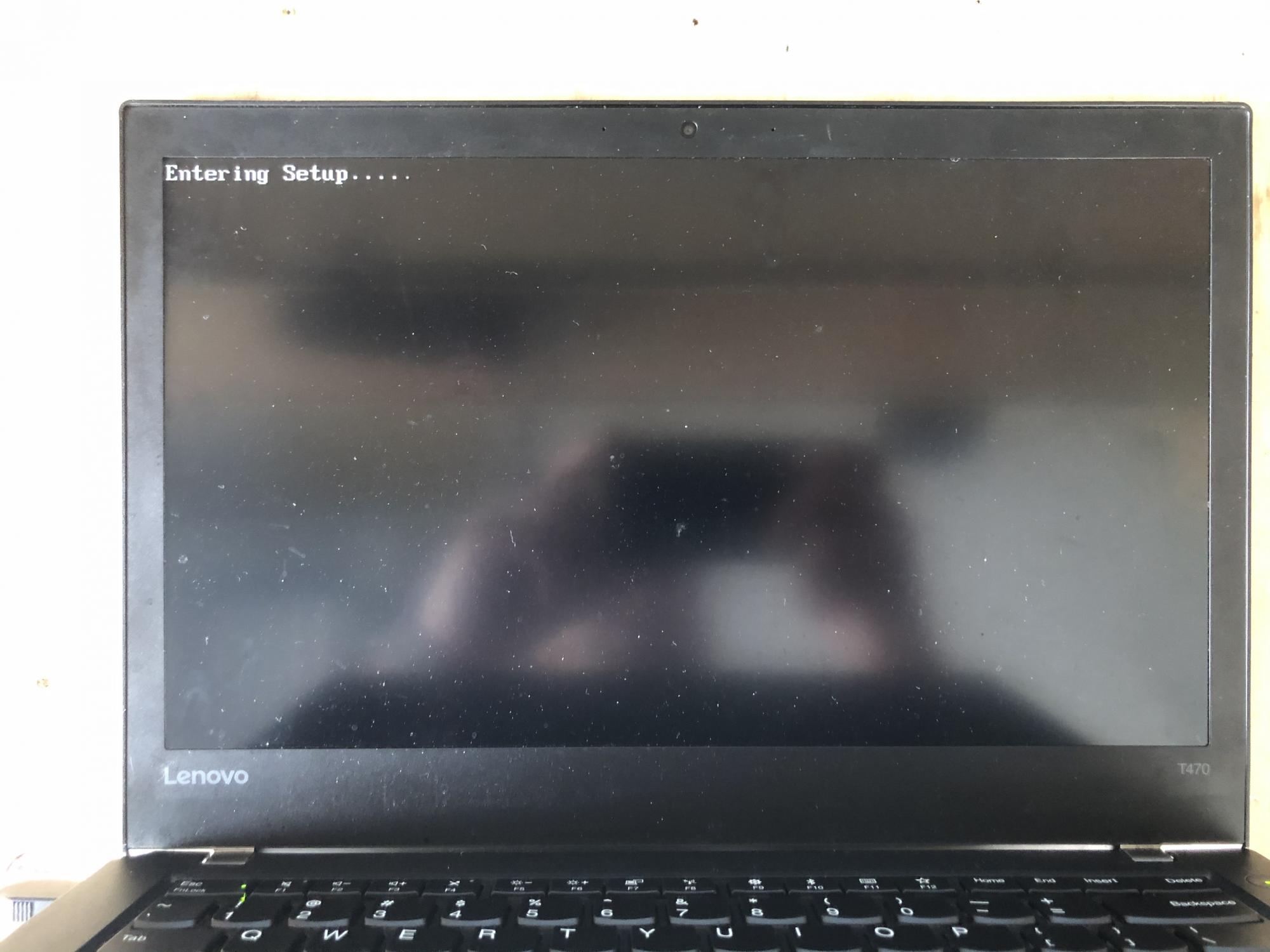

      Re: Lenovo Thinkpad T470 20JM Supervisor password
      Hi
      I have uploaded patches, i type in 1234 as the password. now it is asking for a key as per the pictures i have uploaded
      • ttdkr3w
        • Nov 2020
        • 10
        • new zealand
        #43
        I just entered enter, and it asked to press space a bunch of times, and said to switch off. Turning back on after I press f1 to enter setup it hangs with entering setup.... (the fan turns off whilst)
        Appreciate your help
        • ttdkr3w
          • Nov 2020
          • 10
          • new zealand
          #44
          Working mint, Thankyou so much.
          Followed this guide https://www.badcaps.net/forum/showthread.php?t=87588
          Restored original dump and it removed password!!
