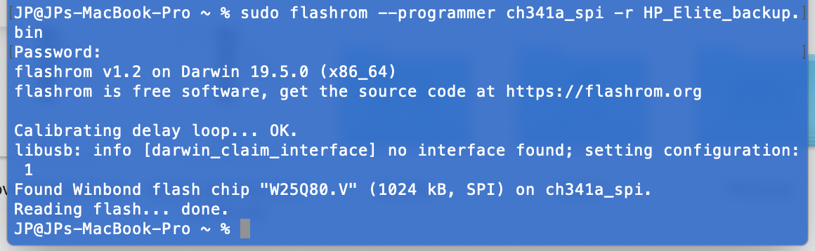

    Looking for a clean BIOS file to flash to a HP Elite X2 1012 g2. Please let me know if more info is needed. Many thanks!

    You want to clean or to unlock !
    HP elite wrong size!

      Sorry, I'm new here. What's the difference between clean vs unlock?
      The size of the HP Elite is what was given by flashrom - what could be wrong?

          • 21666
          Re: HP Elite X2 bios
          The bios chip you need to backup is W25Q128FV ,its a 16MB bios.

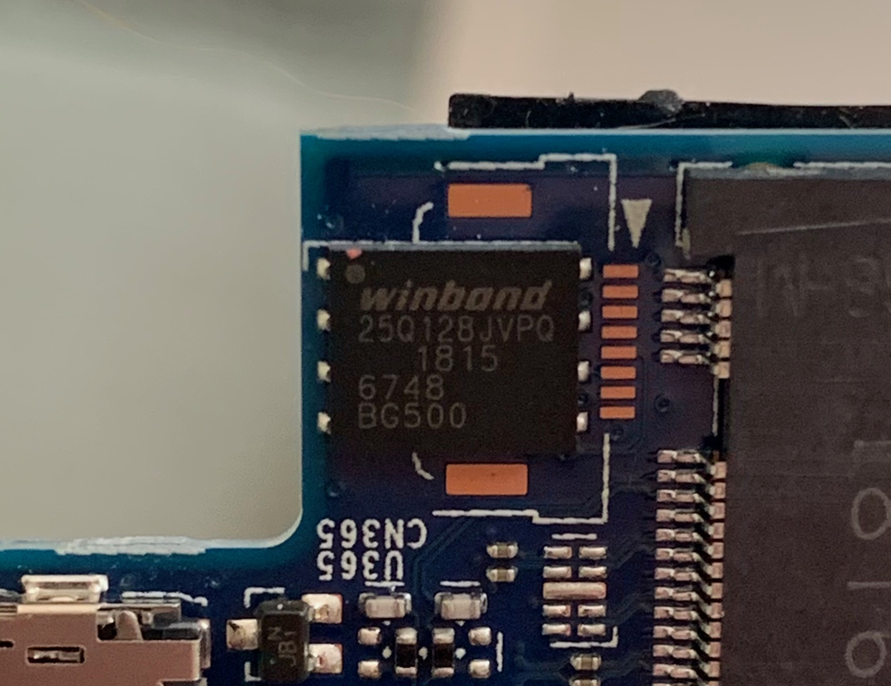

            I do not see that chip on the board. I do however have a 25Q128JVPQ - could it be this chip instead?
              yes that's it
                Originally posted by lapfix
                yes that's it
                Here should be the correct one. Thank you
