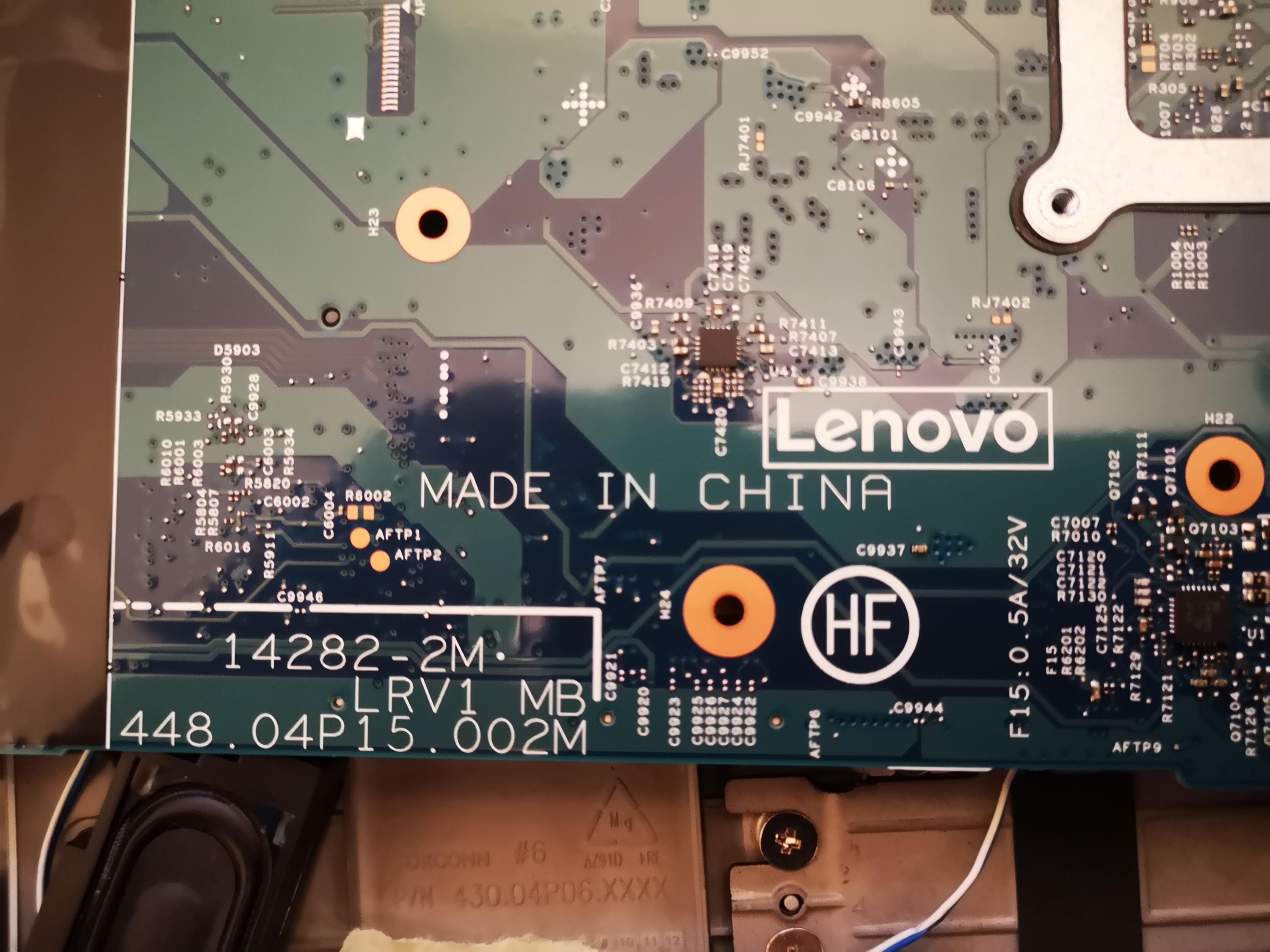

    I have a bios problem on a Lenovo X1 Yoga 1st Gen
    Reference : 20FR i7 6600U
    14282-2M LRV1 MB 448.04P15.002M
    I link you the bios which must be the original one (I'm not 100% sure since I have another one but normally it's the good one).
    So on this one no short circuit, nothing at the thermal camera, when I plug in the green power light comes on (and the fan starts) 1 second and then goes off, and continues to make this looping cycle continuously ...
    All the peripherals are unplugged, the bios chip is ok, I tried almost all the bios I could find here and always the same symptom...
    When I plug in a battery it charges well and if I start the pc only with the battery same problem.
    So please tell me if it can really be the bios? I'm more afraid it could be the ram or the cpu... ? :froncer les sourcils:
    Thanks in advance

      Do you have a serial number ?

        Yes: R90NHP5M or R90NH95M since I have two but they are the same
