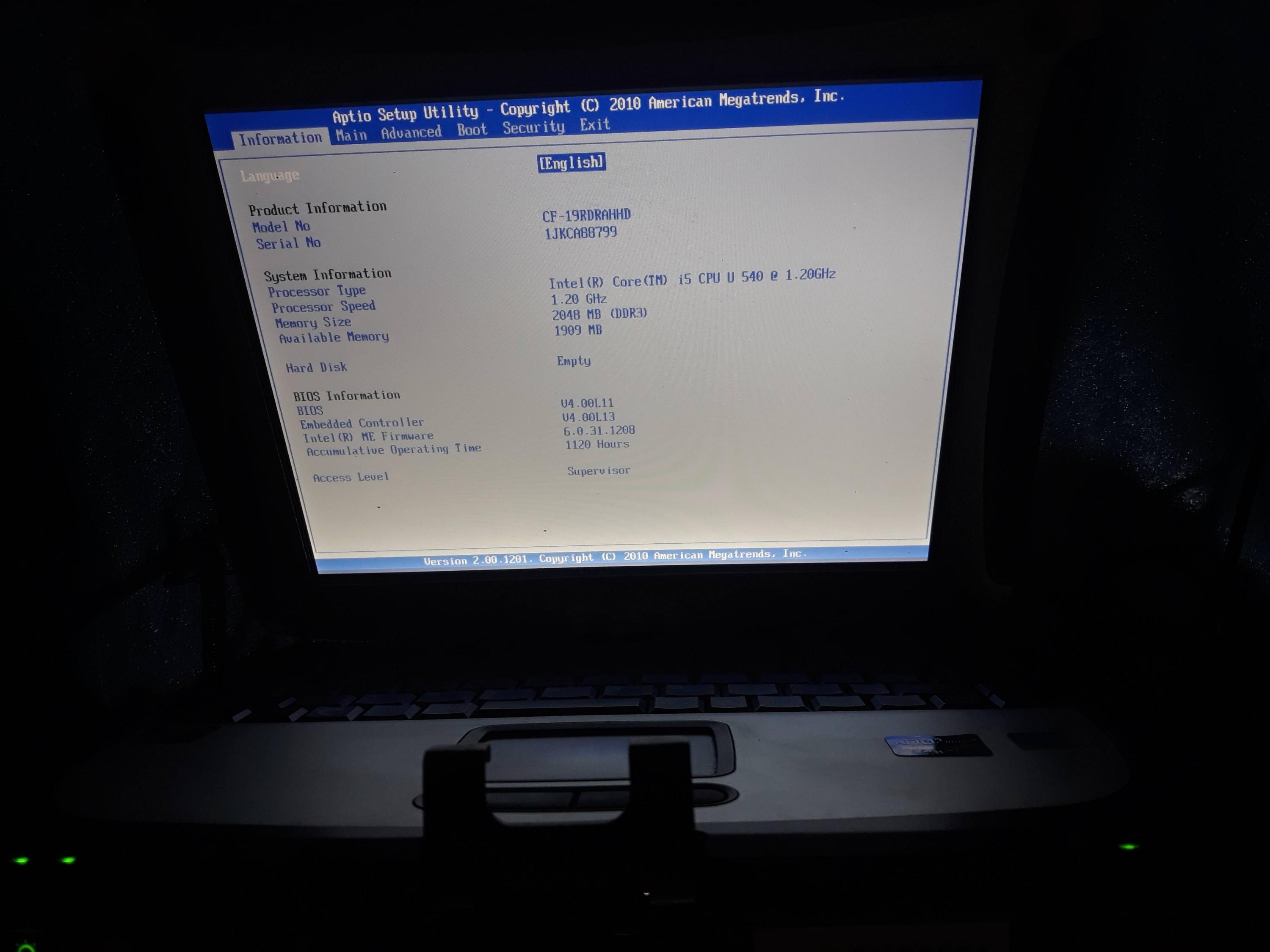

        Re: Panasonic CF-19RDRAHHD password
        Originally posted by Motherboard Repairs
        Try these files 1 by 1 if it don't work then i give up
        Tested 1 , only 1 green light on when connecting power but when switching on the laptop wont power on anymore staying with the same green led on and do nothing,
        Tested 2 , same as test1 , the chip is still ok , programer autodectecting ic, to be sure that chip is soldered good i used solder iron, testing 3
        Tested 3, found that when connecting power cord the light on , keep pressing power button the light goes off , so i put the chip off and connected power cord and its the some result, green light on = power on but no image , the laptop do nothing, testing 4
        Tested 4, some as 1,2,3 . Laptop power on when the power cord plugged but no image, when pressing power button for 4 seconds the green light goes off.

              • noname512
                • Oct 2018
                • 41
                • United Kingdom
                Now flashing spbios patched
                Tested laptop on , and asking for password

                                • noname512
                                  • Oct 2018
                                  • 41
                                  • United Kingdom
                                  #36
                                  Originally posted by imranromi
                                  Also try my file..
                                  This works, the first power on was in about 10-15 seconds with screen off then it power on normally.
                                  Thank you so much everyone!

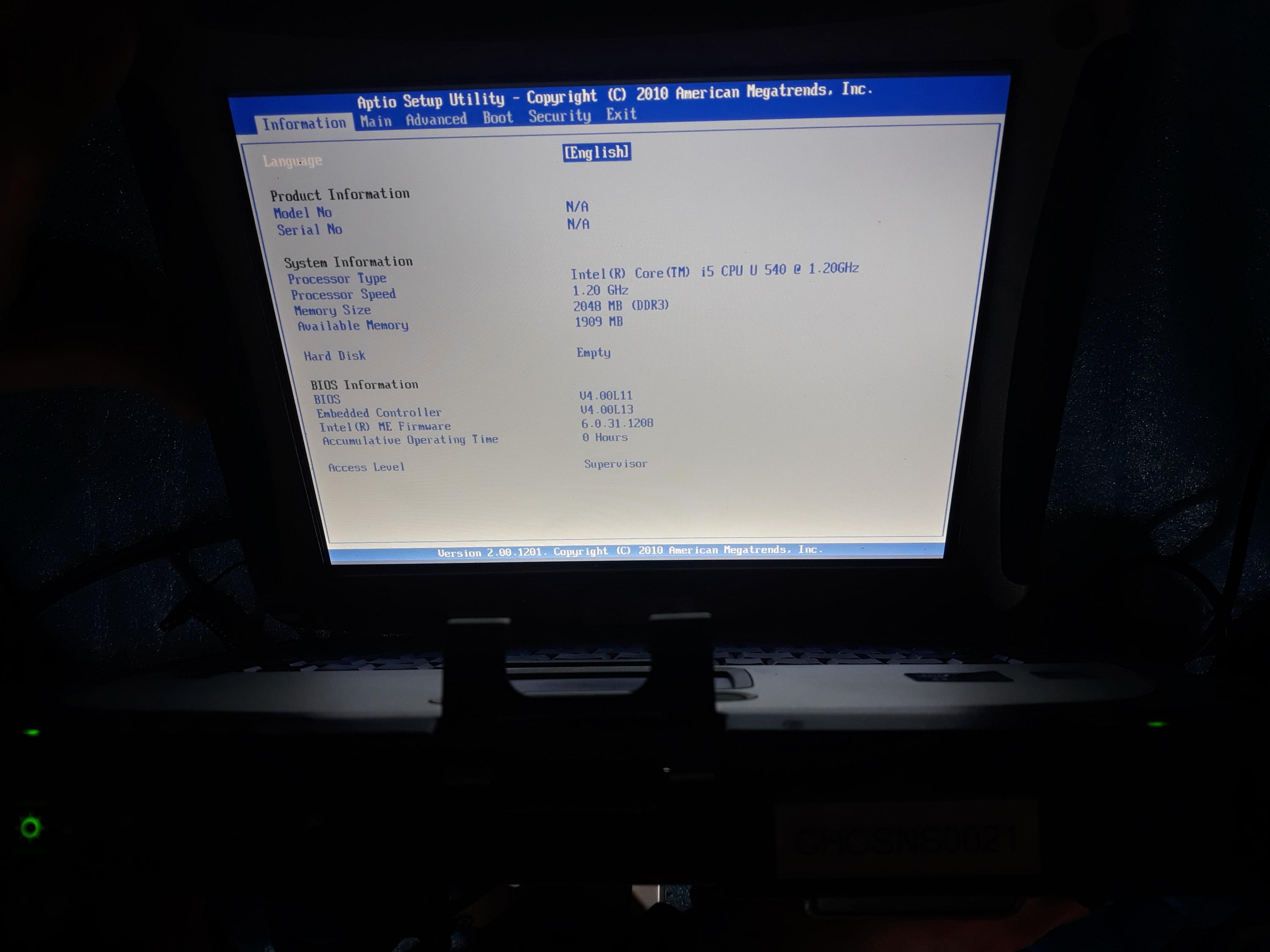

                                      • noname512
                                        • Oct 2018
                                        • 41
                                        • United Kingdom
                                        #39
                                        Originally posted by spbios
                                        did u tried my dump?
                                        Just tried your dump Panasonic CF-19 MK4._clean.zip. This work too, no more password! Thank you !
