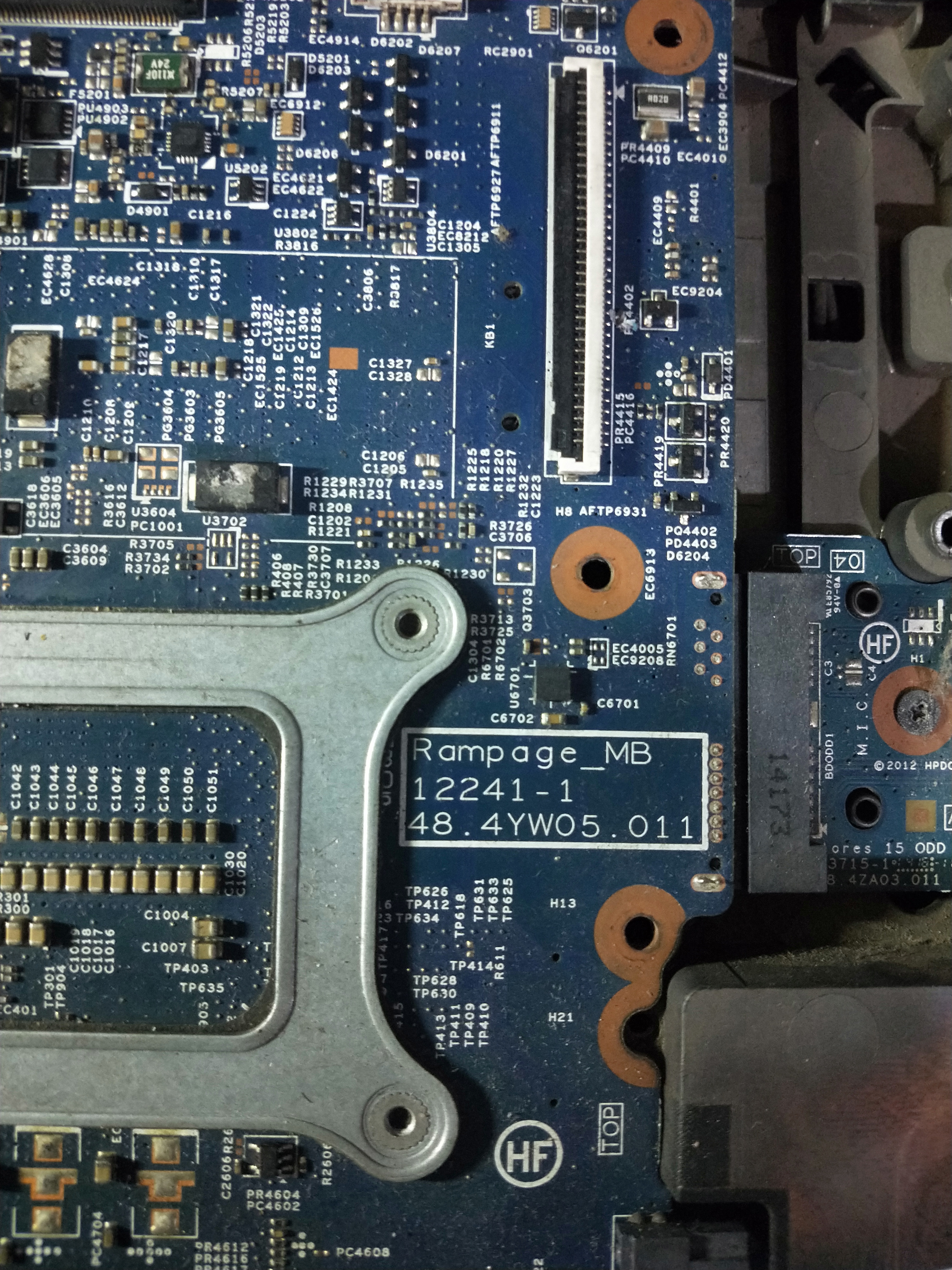

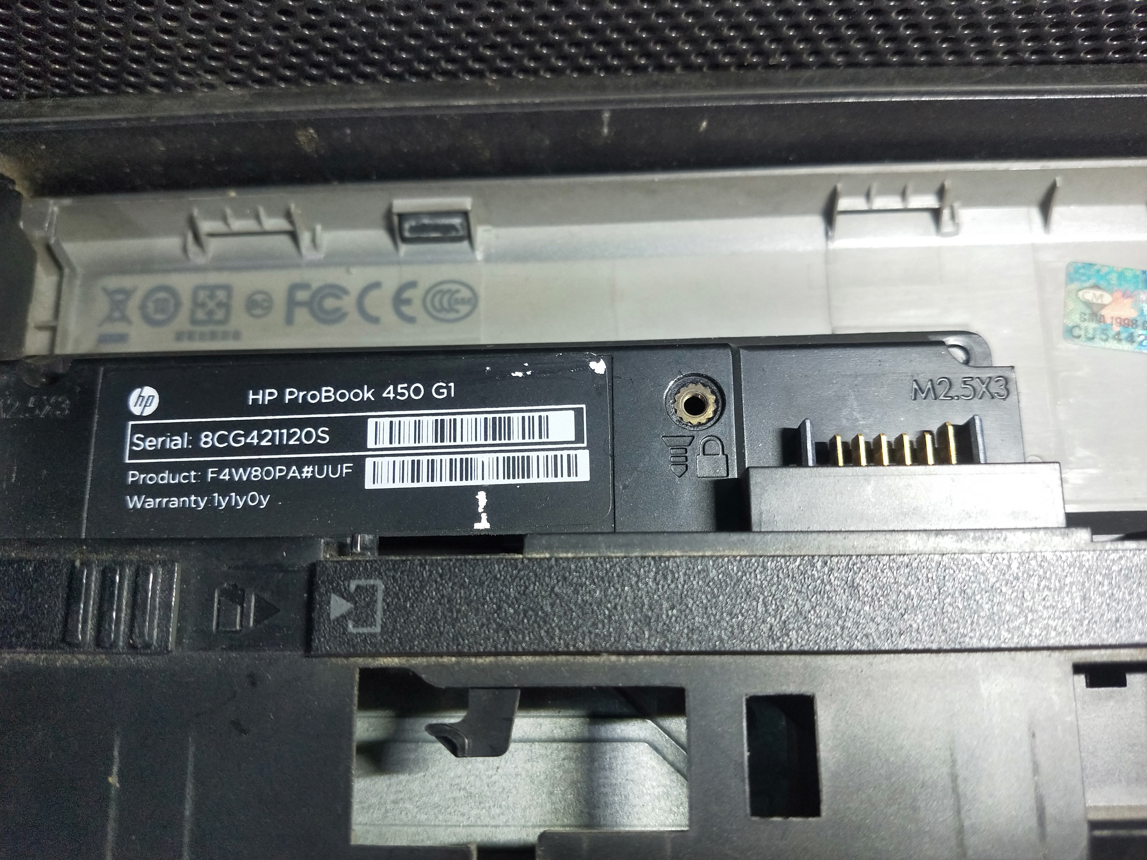

                      #30
                      Originally posted by kalilinux25
                      Can you share your unit serial number and the motherboard code or model
                      Hi pls pardon my late reply, there was political turmoil and massive internet shutdown(a long time) in my country and I was also busy irl.
                      Here is full details(photo attached)
                      Hp probook 451 g1 (intel i5 + AMD radeon dedicated graphics)
                      motherboard code: Rampage_MB 12241-1 48.4YW05.011
                      Unit serial no: 8CG421120S
                      product: F4W80PA#UUF

                        #31

                          #32
                          danito is this the original bios? and is the password clear? and is it 48.4YW03.011 or 48.4YW05.011?
                          • danito
                            • Jun 2016
                            • 1259
                            • Romania
                            #33
                            48.4YW05.011, original file, I don't think he has the password.
