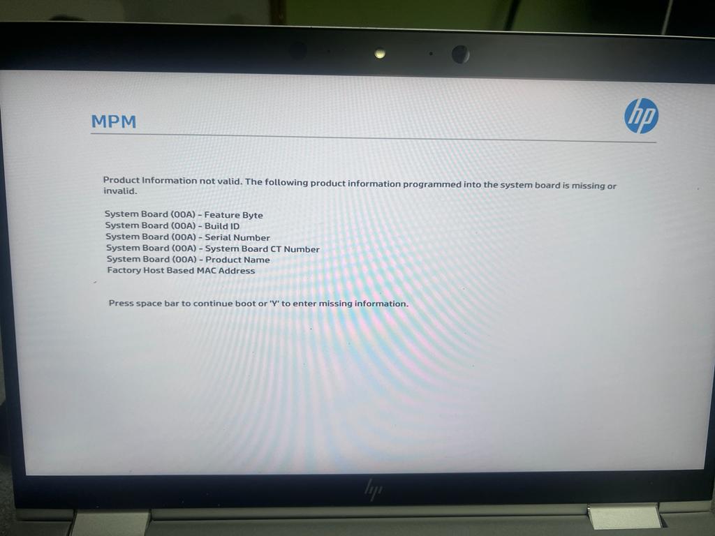

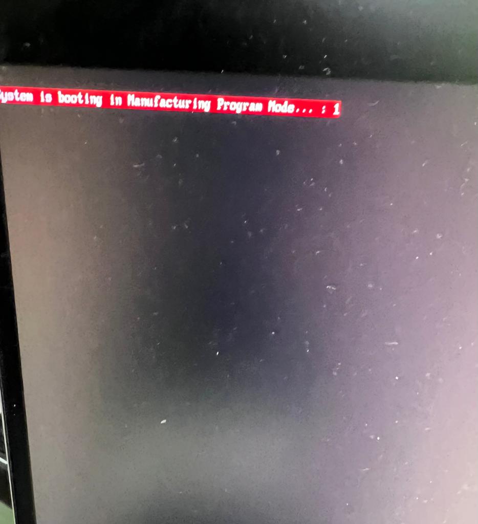

                          #52
                          Re: HP Elitebook X360 1030 G4 BIOS unlock request
                          hi
                          i need a help
                          ive got a elitebook 1030 g4
                          bios was locked and message on full screen while im use that the laptop is blocked by someone
                          i managed to unlock but now every time when i switch on the laptop its shows message product information not valid
                          system is booting in manufacturing program mode ....:1
                          i dont want to enter the original serial number or mac etc because it maybe block again

                            #53
                            Originally posted by macadam
                            hi
                            i need a help
                            try this..

                            • macadam
                              • Apr 2016
                              • 51
                              • United Kingdom
                              #54
                              Originally posted by peste
                              thanks
                              i can enter the info from laptop but the problem is, im thinking if enet the serial number and mac address it can block again when i connect to internet
                              • peste
                                • Dec 2016
                                • 12610
                                • ROMANIA
                                #55
                                thanks
                                well, if the password has been deleted, how to get it back...

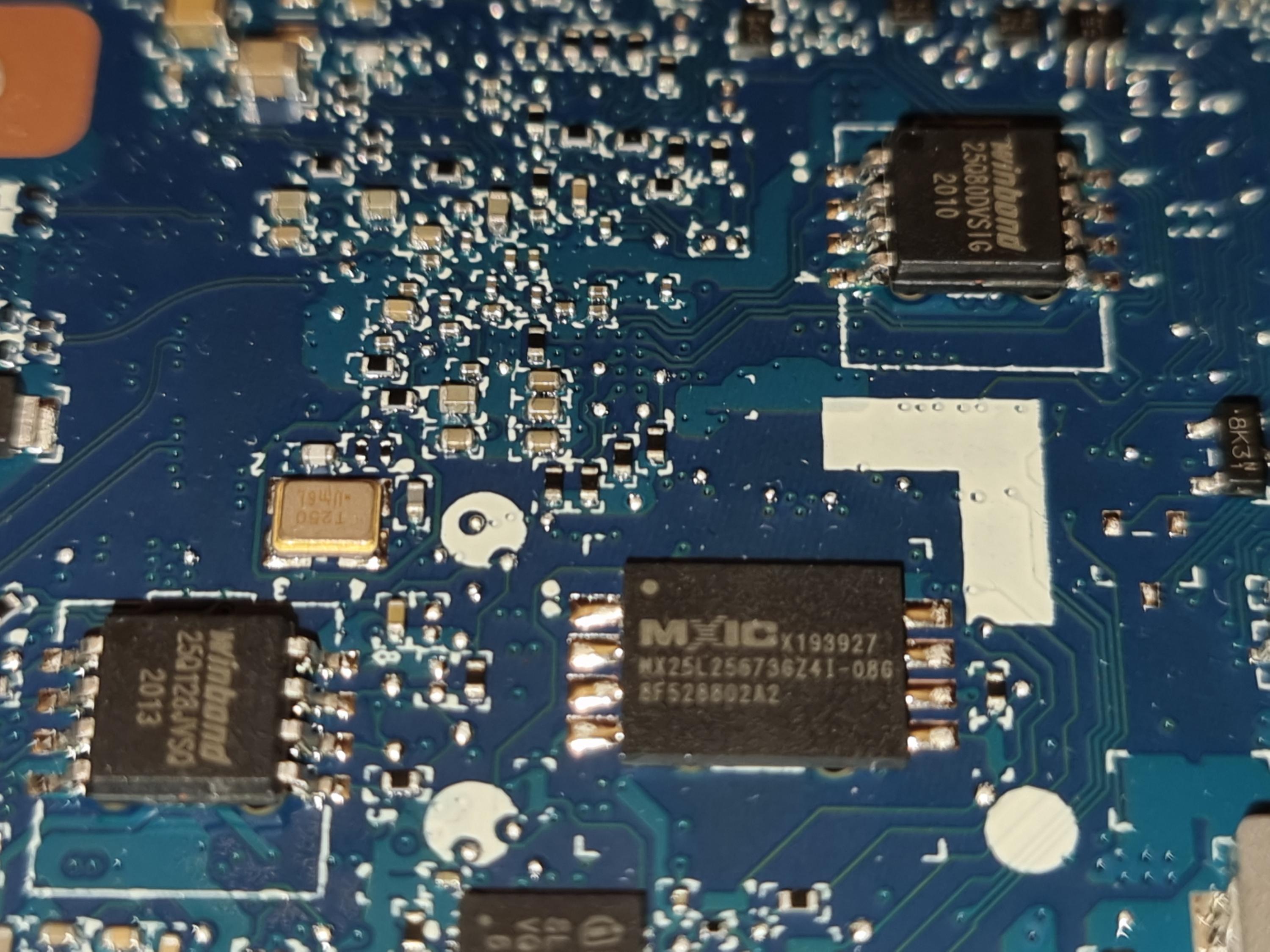

                                  I can see 3 BIOS chips on laptop, one is smallest in size, the one in the middle is 25c256jveq winbond and the last one next to it is another winbond 16mbs. I have ch341a programmer.
                                  My understanding I also need to reprogram the big winbond chip (I think it is 32mbs). Can my ch341a read this chip?
                                  Also which chips do I need to dump? (32 and 16?)
                                  Last question can I use RCUnlocker for these, if so which dumps needs to be treated (32 and 16?) ?
                                  • hardware1
                                    • Sep 2021
                                    • 2925
                                    • N/A
                                    #57
                                    Use RCUnlocker with your 16MB Chip that's all.

                                    • Vesko356
                                      VIP Moderator
                                      • Aug 2018
                                      • 4386
                                      • Bulgaria 🇧🇬
                                      #58
                                      No, your understanding is wrong.
                                      Yes, it can be read by the Ch341a.
                                      16
                                      Yes , you can.
                                      16.

                                      • wolf3d.exe
                                        • Jan 2023
                                        • 33
                                        #59
                                        16
                                        Yes , you can.
                                        16.
                                        Thank you, all done! Flashed 16mb. I was skeptical about 32mb dump because some people asked to post those as well. Also a question about surestart. What does 32mb chip hold? Is there a copy of locked bios? (that could be restored if sure start activated and detects tampering or difference between backup and actual)
