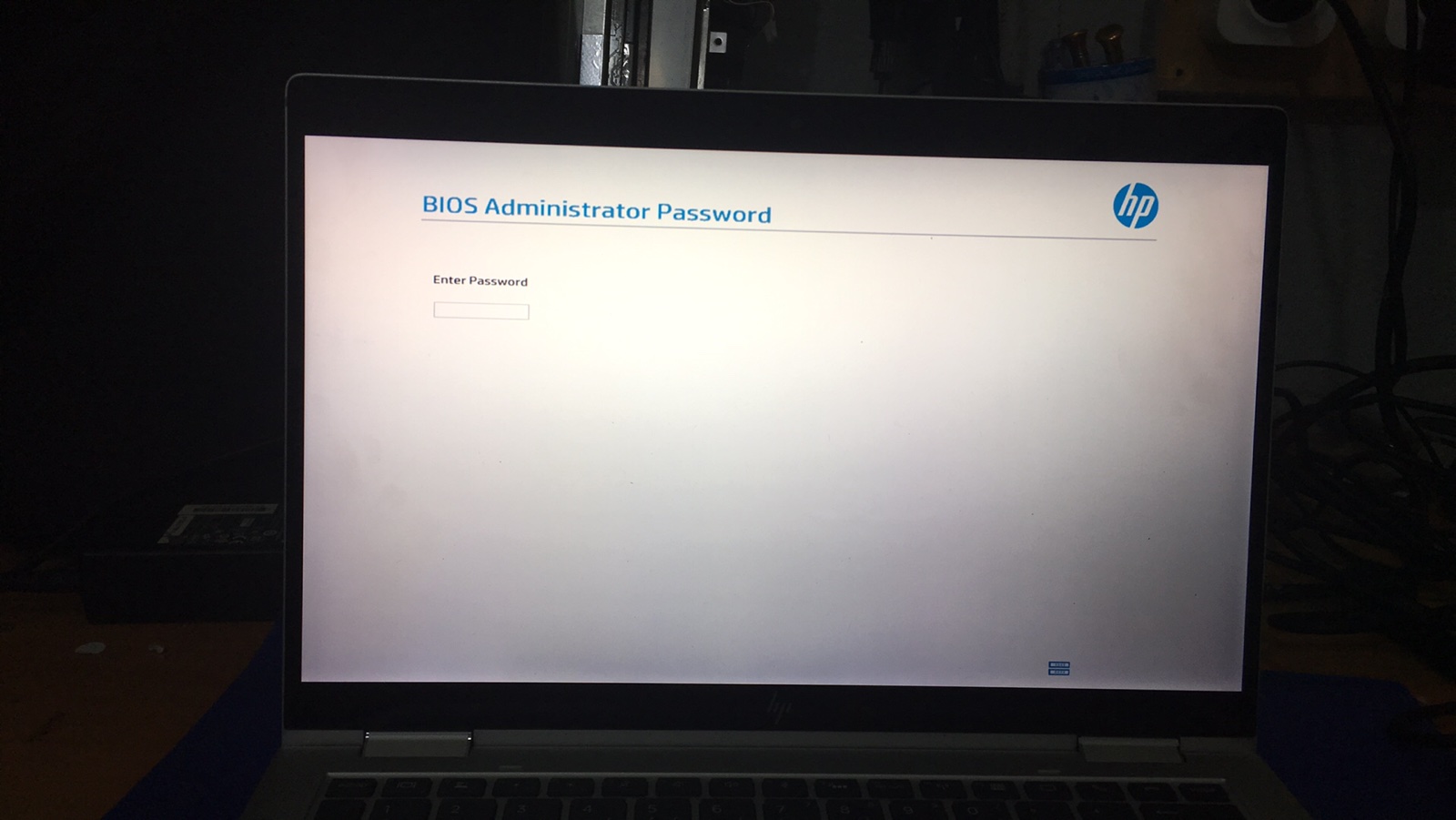

                            NEED HP Elitebook X360 1030 G4 BIOS unlock
                            need unlock HP Elitebook X360 1030 G4 BIOS
                            thank you

                                Re: NEED HP Elitebook X360 1030 G4 BIOS unlock
                                Originally posted by peste
                                try..
                                always password

                                  • Ghamidi
                                    • Mar 2020
                                    • 305
                                    • France
                                    try this too
                                    same problem always password
                                    thank u peste

                                      • Ghamidi
                                        • Mar 2020
                                        • 305
                                        • France
                                        Originally posted by omruu9
                                        Try this one
                                        no unlock with HP unlocker V1
                                        Thank you
