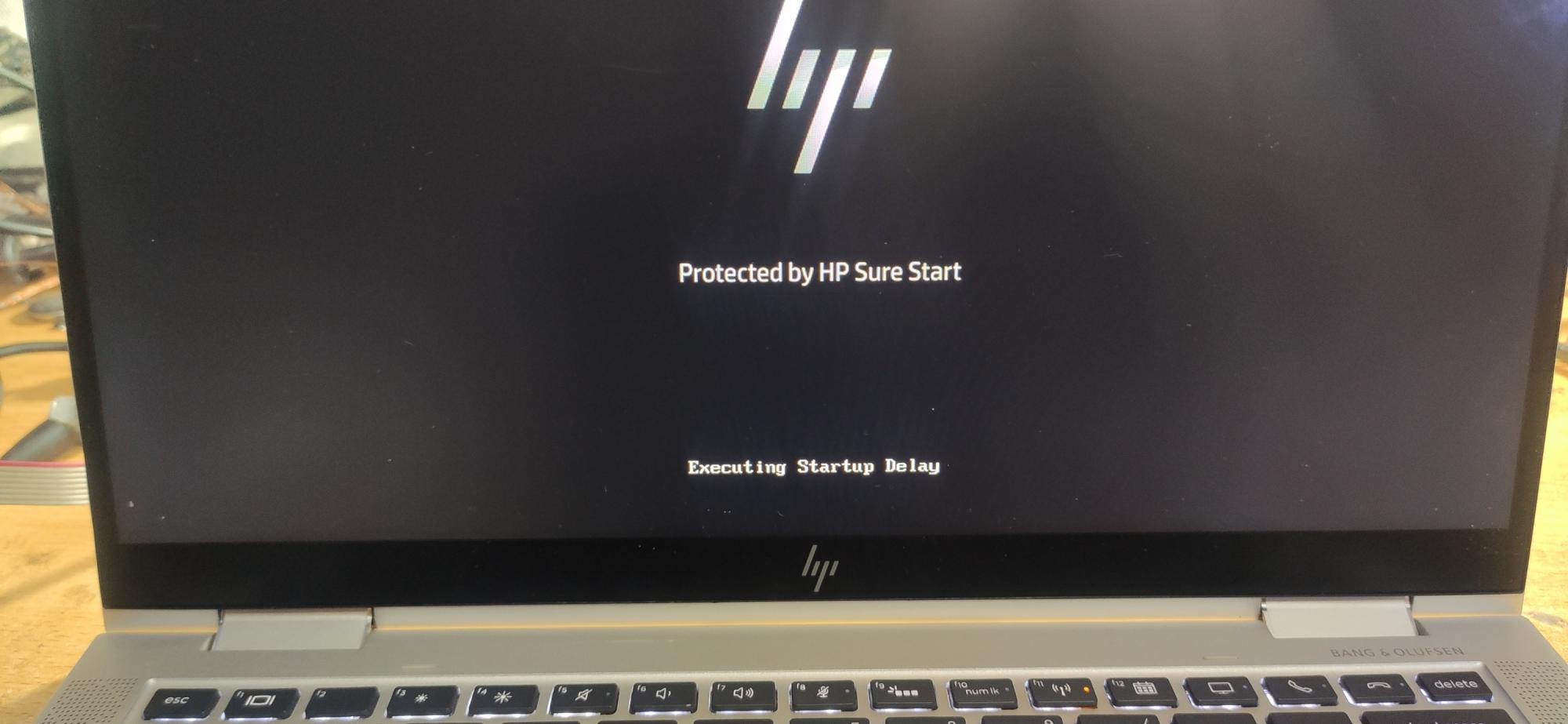

          I think there is an easier way to unlock these new X360 1030 G4 laptops, but I'm not specialist (and I also don't know how to get out of MPM mode). I shared with you what I know and what I've tested on 5 laptops.
          Hi. I used one of these but experiencing start up delay.

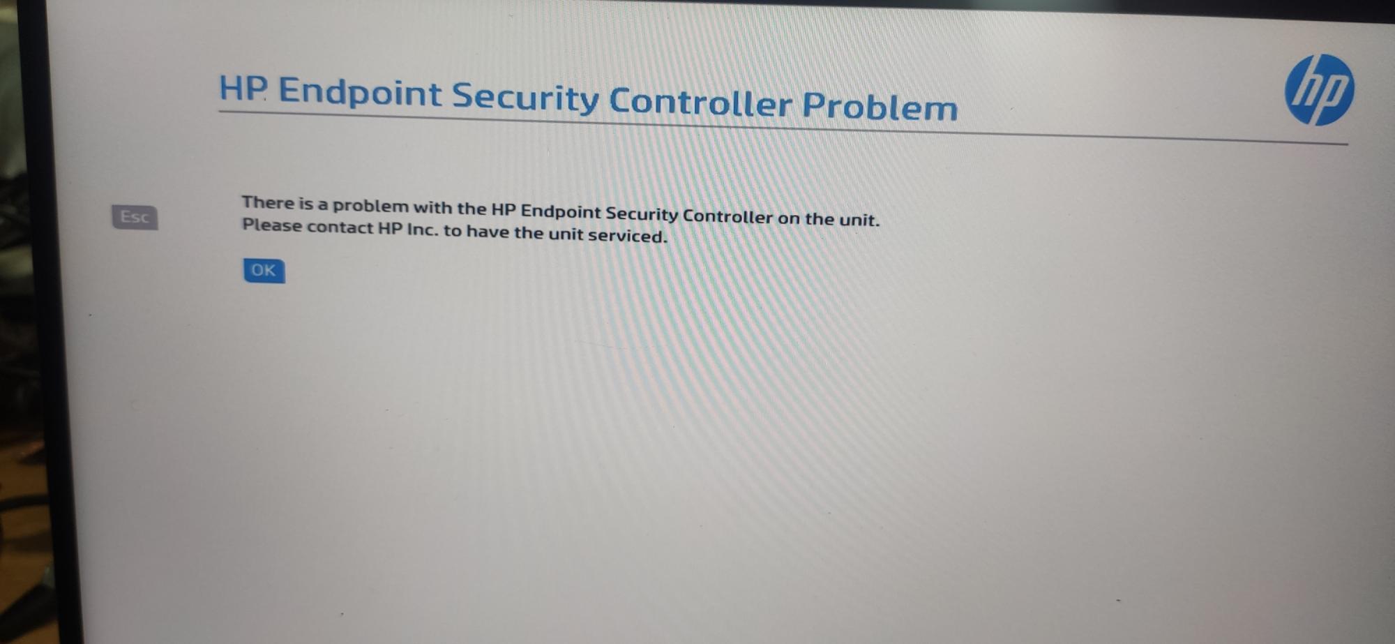

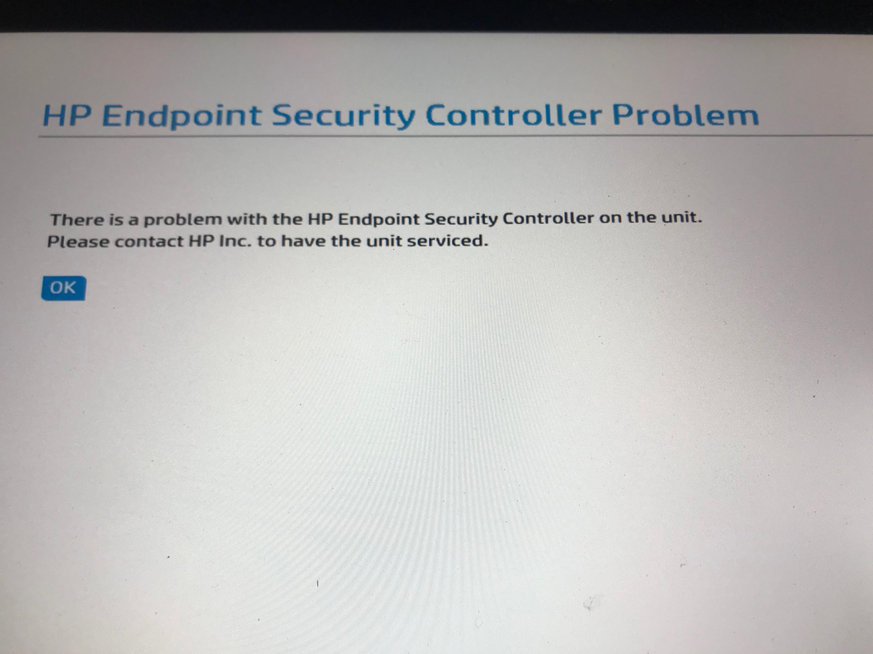

                    #29
                    Re: HP Elitebook X360 1030 G4 BIOS unlock request
                    Originally posted by qayyum786
                    try
                    Thank you very much brother, the password was deleted, I only get the message "Hp Endpoint Security controller, but that message was from before ... install the two files at the same time the 32mb and the 16mb ...
                    • qayyum786
                      • Aug 2018
                      • 1959
                      • INDIA
                      #30
                      happy to hear that its unlocked
                      Now Go in to bios and restore security setting to default and restart your laptop
