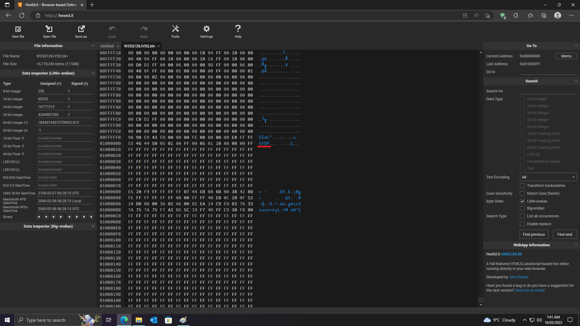

      Also I used Dataman 48UXP to read chip, is this okay or should I order and use the CH341A programmer?

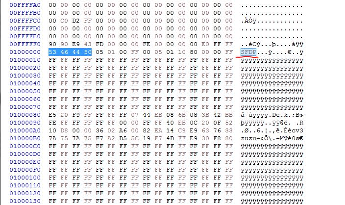

          It just needs the last 1KB trimming off. The programmer has saved SFDP timing information at the end.I googled what SFDP was so i could be wrong.

          Does the programmer have an option to save without SFDP ? ,can you use a hex editor to delete the unwanted 1KB at the end of the file

                  Hi I have found SDFP and removed it from file but I still get the same message.
                  Please see attachements.
                  Thanks.

                    Hi sorry pleae ignore my post above I misunderstood your post I deleted the last 1KB of the .bin file and now was able to use RC_unlocker.
                    However I have another problem the laptop does not seem to turn on. I get blinking orange and white light when I put it on charge and caps lock light is on all the time.
                    Do I need to reset CMOS settings somehow. Thanks.

                      recheck all your soldering and look for any damaged or missing parts around the bios chip if you used a hot air station. Does this model have a CMOS battery, did you remove it. did you remove the main battery.
                      Flash the old bios back and see if there`s any difference
