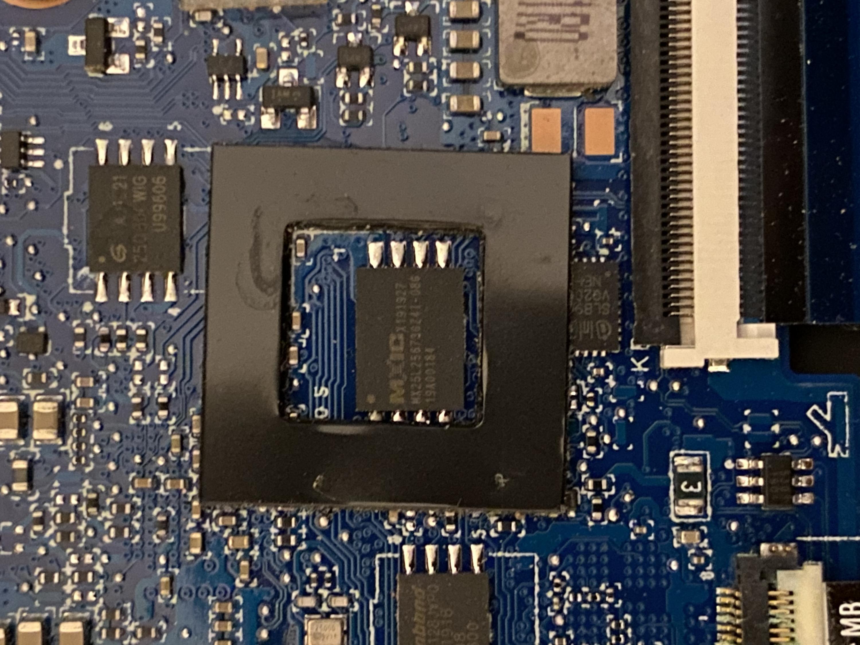

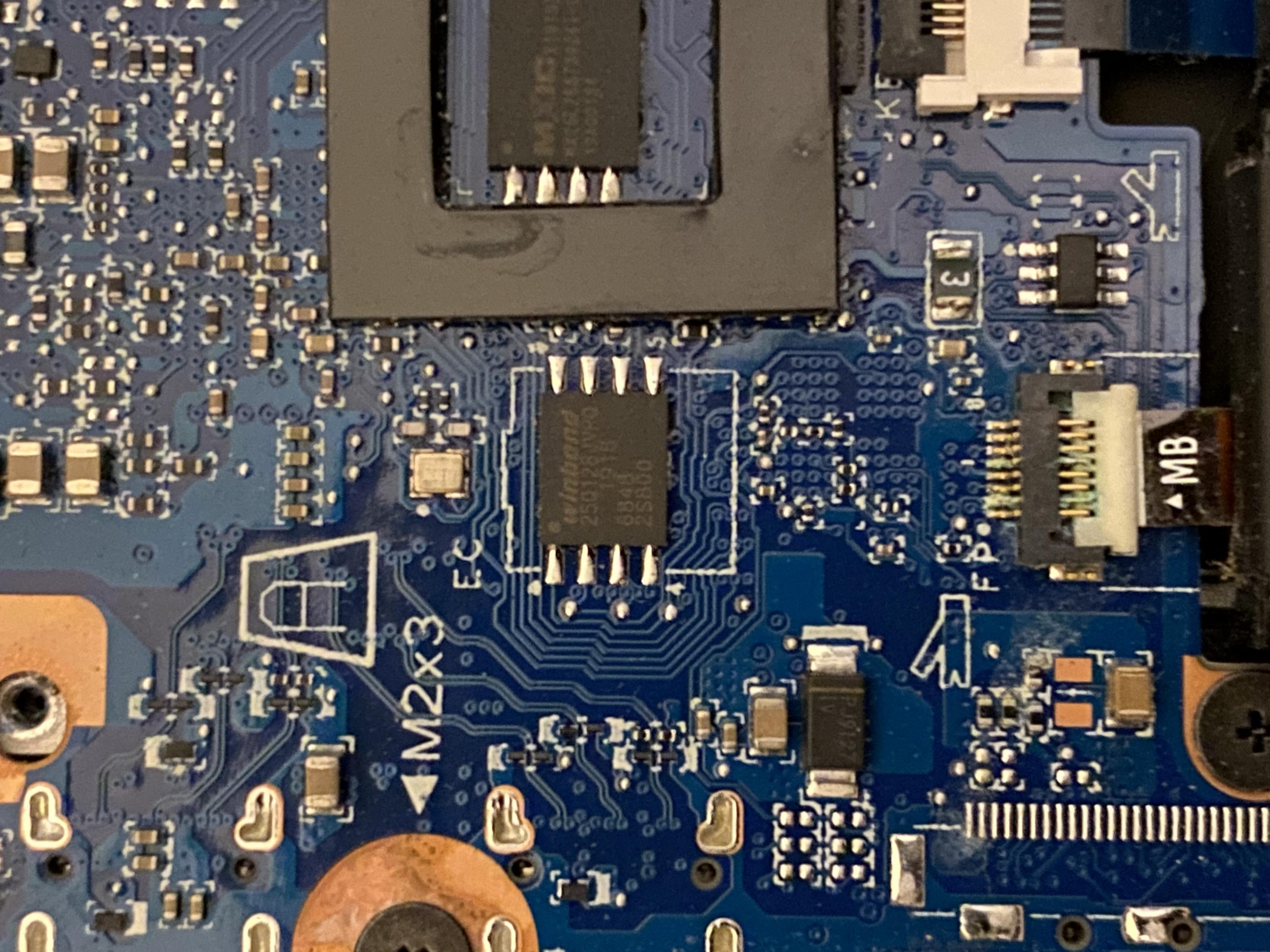

                      I'm sorry but i need your help please.
                      I have an HP Elitebook X360 1030 G3 with BIOS password (I bought it like this).
                      I have a Raspberry Pi 4 and i don't know what to buy for dump BIOS (chip clip), knowing that i don't have the material for desolder.
                      I believe that i have a WSON8 chip (see attached picture).
                      As you can see, there are two Chips, which one should be flashed ?
                      Many Thanks for your help.

                                    Hi, I have a HP EliteBook 1030 x360 G3 with BIOS password. As far as I know, the Elitebook has a BIOS and a EC chip on board.
                                    Can anybody confirm, if I have to unsolder and flash both chips or just one of the 2 chips?
                                    At the forum is talked about 2 chips, this guy unsolder only 1 chip:
                                    https://www.youtube.com/watch?v=sI7P39iHQlU
                                    Would be nice, if anybody could share his experience?
                                    Thanks!

                                      • livestrong
                                        • Jan 2023
                                        • 3
                                        Re: HP Elitebook X360 1030 G3 BIOS and EC unlock request
                                        After some research I guess I have to flash the 256Mb BIOS chip, should be the MX25L25673G. So I am new in this field, I have to buy some hardware to flash.
                                        I guess the cheapest way to start is to buy the CH341A set:
                                        https://www.amazon.de/KeeYees-SOIC8-...language=en_GB
                                        But unforutnately the MX25L25673G is not in the supported chips list. So does it mean that I can't read/flash the chip with CH341A or does it just mean, that I need another software to read/flash?
