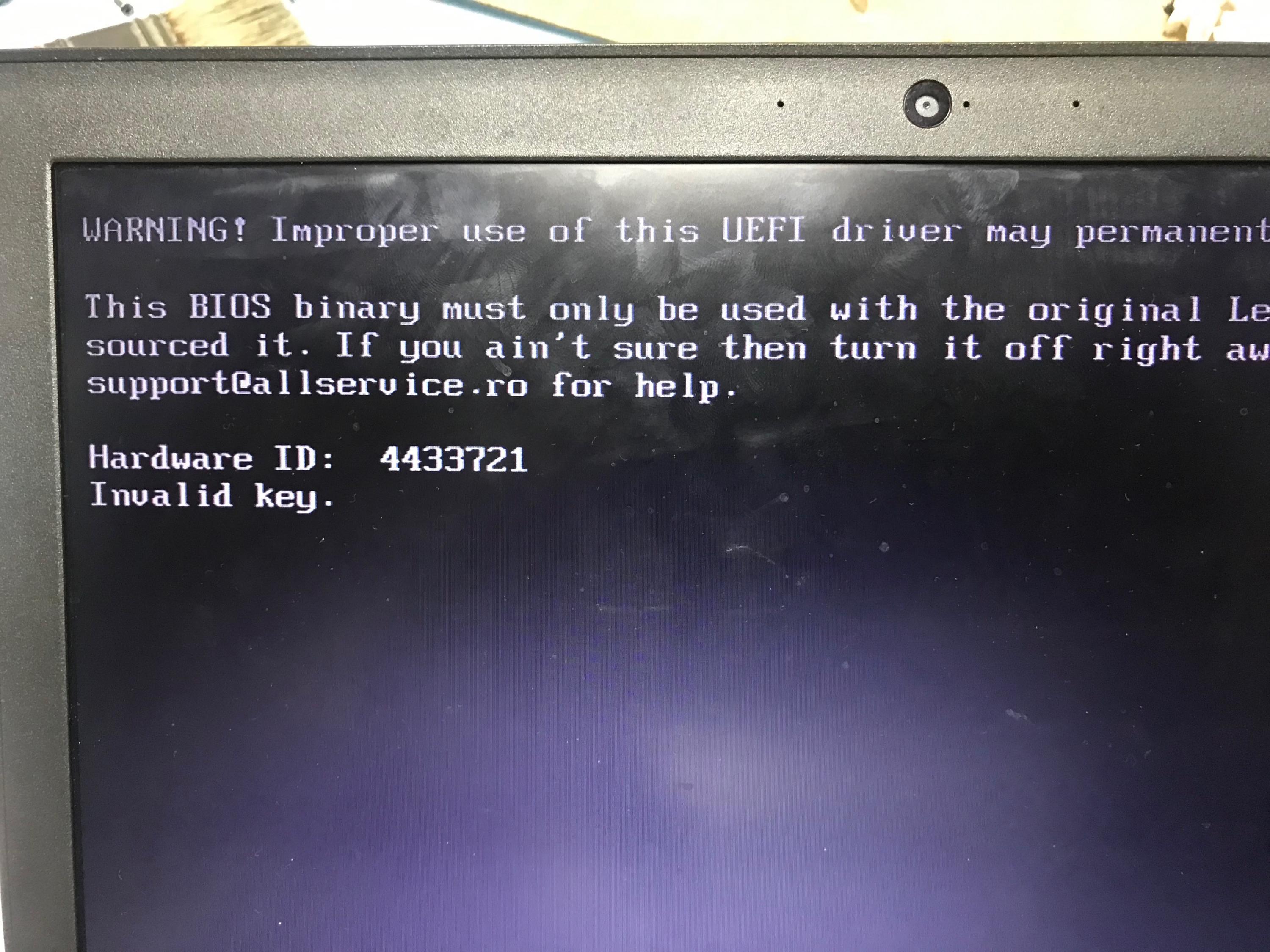

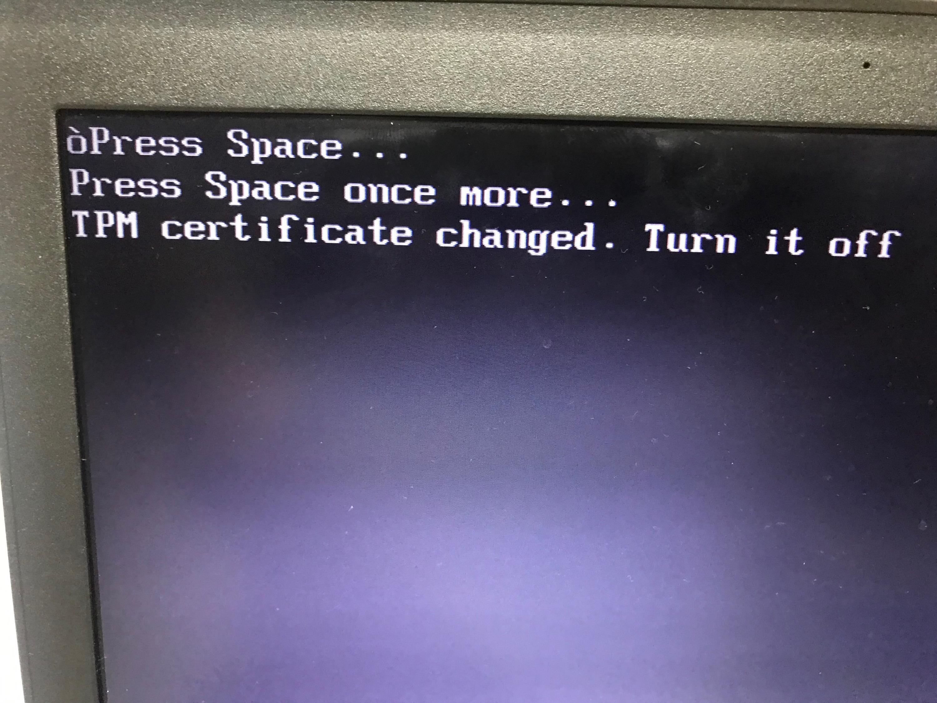

                                #115
                                Re: Lenovo Unlock Dxe Driver Bios Collection
                                Patched file for X270 didn't work for me, failed after asked for key for hardware id. (invalid key) I took a patched file from https://www.badcaps.net/forum/showth...highlight=X270
                                and worked.
