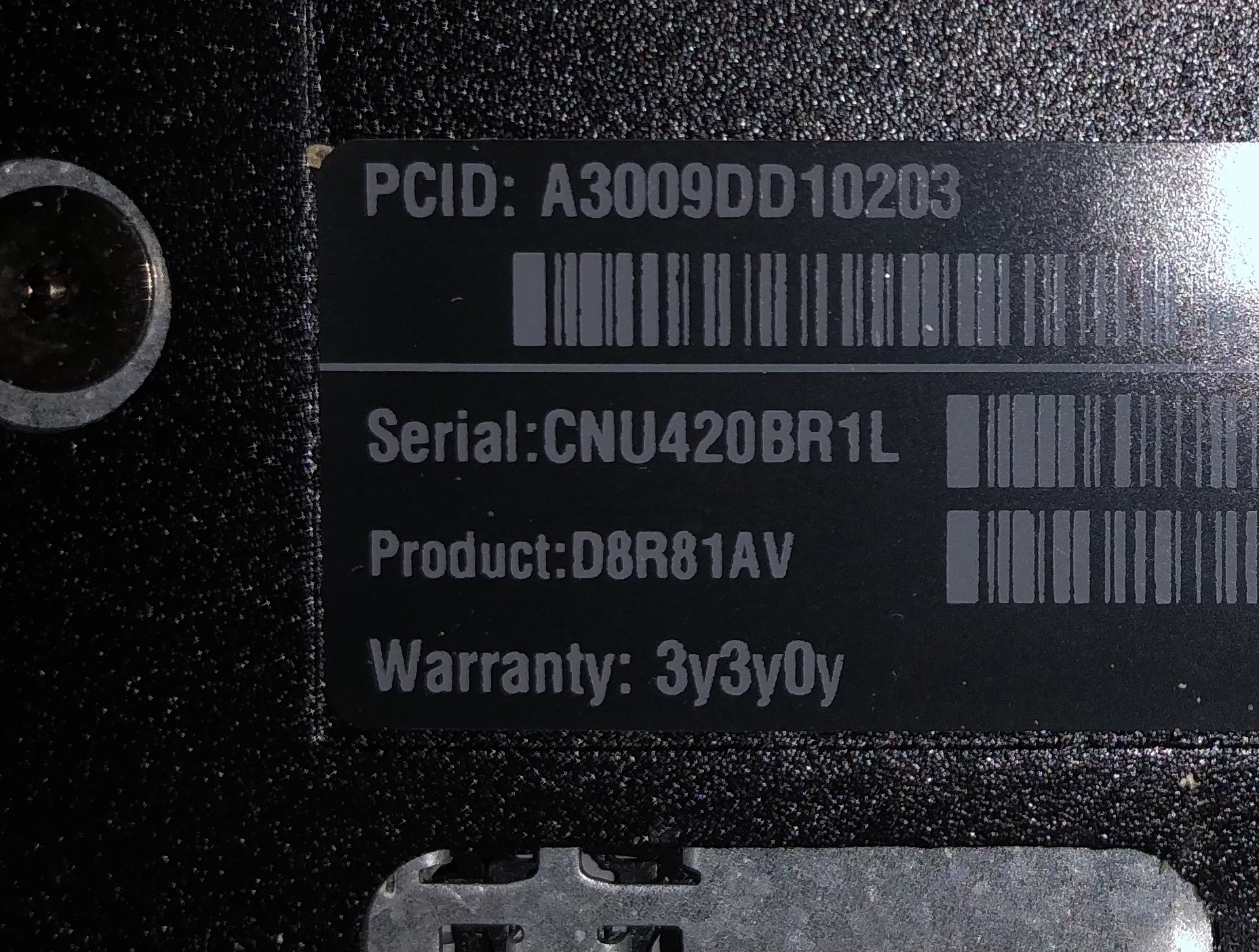

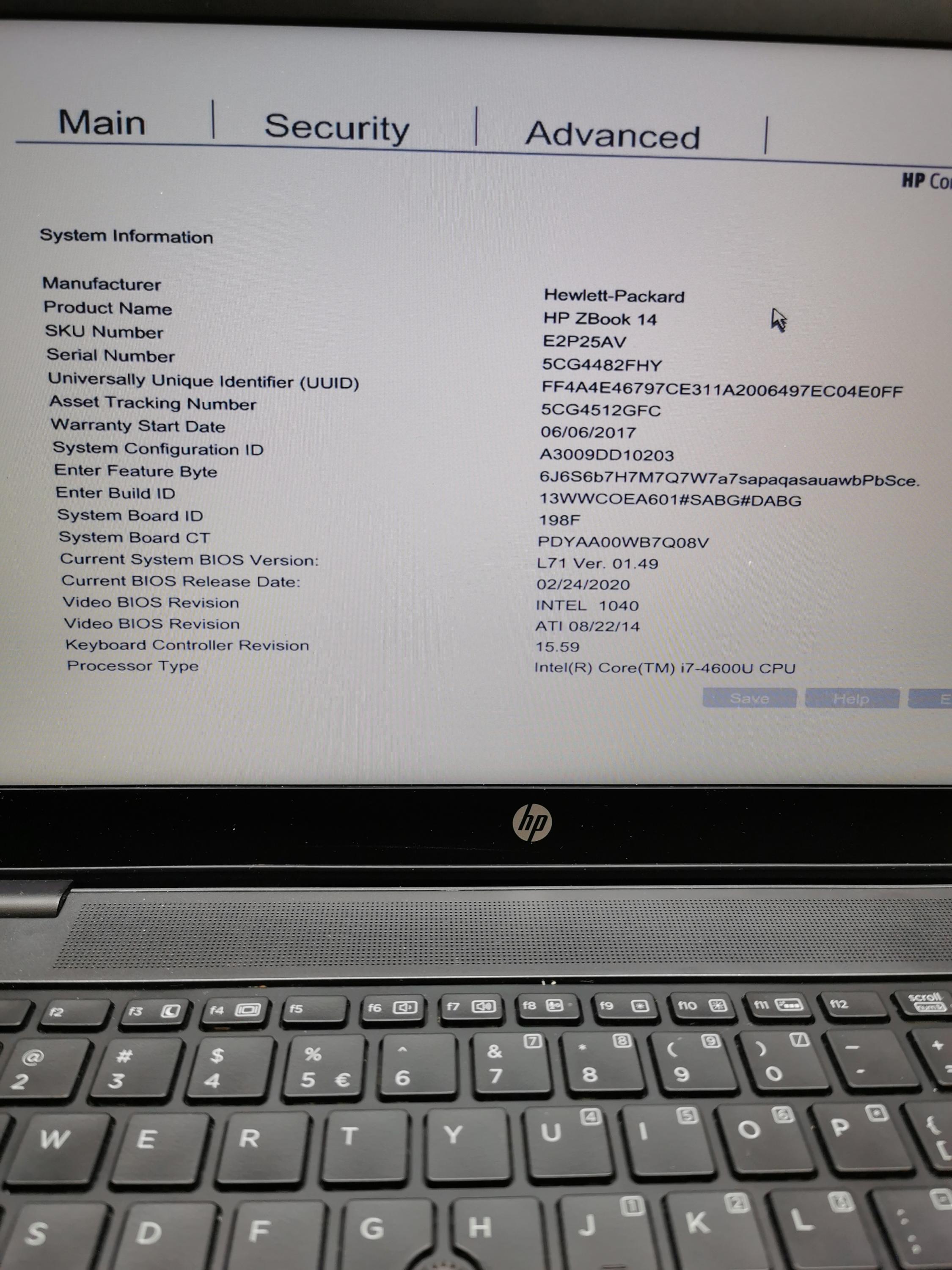

                    #49
                    Hi. I think I have the same problem as mhd bero.
                    A client came to me with a messed-up bios uploaded from the forum with an incorrect serial number. When I restore the bios from the second memory chip, the effect is the same.
                    Everything seems to work fine except the wrony S/N, message "Machine Is Not In Committed State" and the lack of MS license.
                    Can you help?
                    Elitebook 840 G1
                    S/N: CNU420BR1L
                    Click image for larger version  Name:	IMG_1618.jpg Views:	0 Size:	1,000.0 KB ID:	3228709
