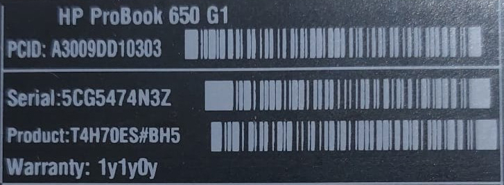

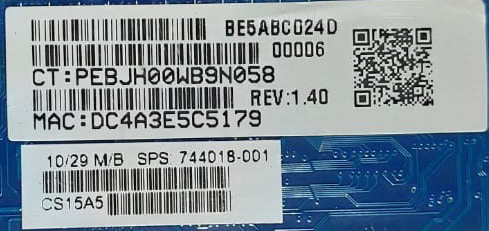

    I have an HP 650 G1
    Motherboard was changed but I do not have backup of old BIOS
    I get "machine not in committed state" when laptop starts
    CPU is over heating. I do not know if related.
    Tried BIOS from below link. Laptop do not boot.
    https://www.badcaps.net/forum/showpo...00&postcount=7
    I get "MPM is not unlocked", when using "HP Manufacture Programming MPM Unlock tool down"
    See attached BIOS, CT from new board and serial number of laptop
    Can someone please update the BIOS and send me?
