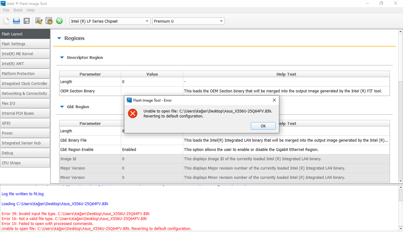

    Hello, does anyone know where i can download flash image tool ver. 11.0.0.1180 please.

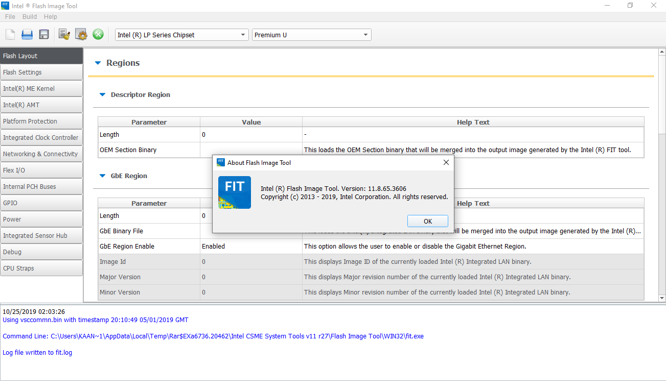

      Sorry does not work with this version. (Intel CSME Sistem Araçları v11 r27)

        What doesn`t work with that version ? ,are you trying to repair a bios.Are you sure 11.0.0.1180 is the FIT version,and not the ME firmware version.

          Hello there. Motherboard Asus X556UJ Rev 2.0 bios me want to update. But the bios won't open the file. I'm gonna add a visual.

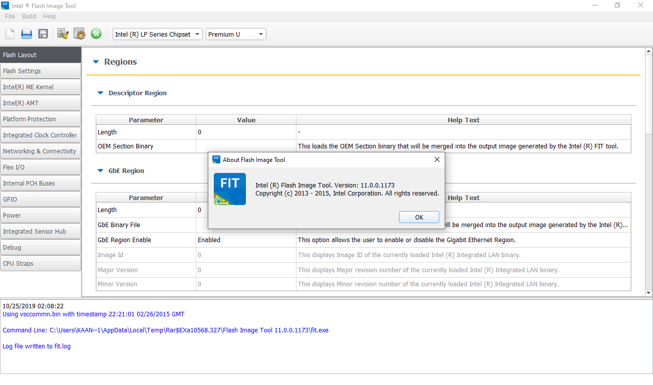

            See flash version tool version! the version I'm looking for is 11.0.0.1180. Do you have this software?

              Put your flash image tool in C:\FIT folder. Your windows username has a character FIT might not like. I had similar problem with FIT.

                Thank you, you are great ... My problem is solved.
