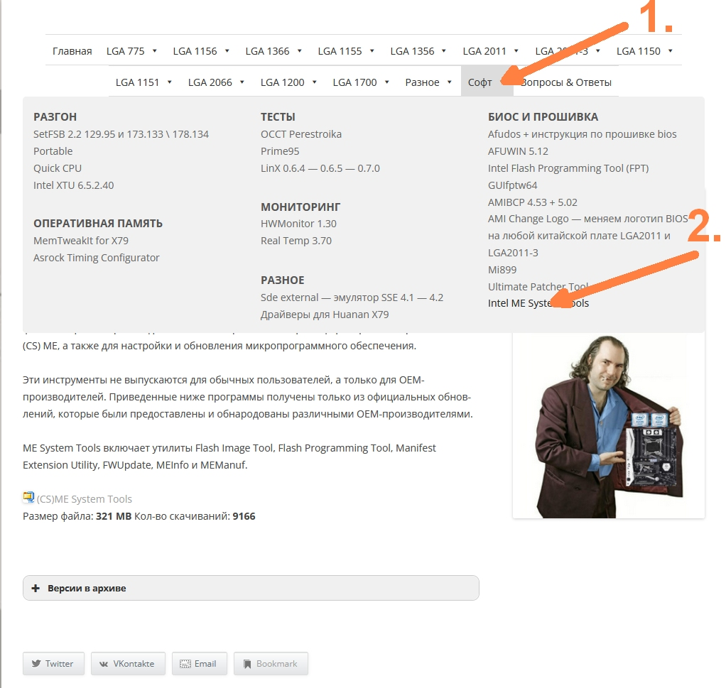

                    If you are brave enough, here another good download source on an russian site:
                    https://xeon-e5450.ru/soft/intel-me-system-tools/
                    Click image for larger version  Name:	obraz.png Views:	0 Size:	460.8 KB ID:	3291208
                    It'a one file all inclusive.
                    I used it, and so far I and my PC still are alive.
