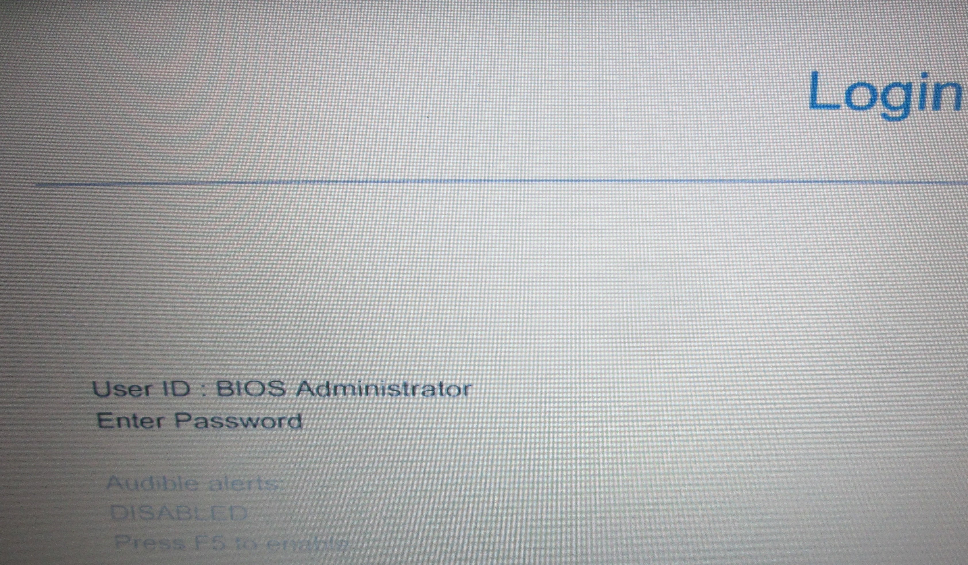

Hp probook 640 g1 bios
  • bogdanelectronics
    replied
    Hello
    HP probook 640 G1 Bios corrupted
    Sn : 5CG6040QFV
    Mother board 6043B0141201 MB-A01
    Thnak you for your for your support​
    Leave a comment:
  • F6 Solutions
    replied
    Originally posted by shiyab
    hi try
    not working
    Fan speed is higth
    having to message at startup
    warning: Machine is not in committed state
    manufacturing program mode set
    also in forum i download the files HP 640 G1 6050A2566302 MB A04
    at startup having only message
    Machine is not in committed state​
    Leave a comment:
  • shiyab
    replied
    Originally posted by F6 Solutions
    Hello
    HP probook 640 G1 Bios corrupted
    Sn : 5cg451274t
    Mother board 6050A2566302 MB A04
    thanks
    hi try
    Leave a comment:
  • F6 Solutions
    replied
    Hello
    HP probook 640 G1 Bios corrupted
    Sn : 5cg451274t
    Mother board 6050A2566302 MB A04
    thanks
    Leave a comment:
    commented on 's reply
    https://www.badcaps.net/forum/troubl...72#post1760372
  • mahlcom
    replied
    hi i have hp 640 g1 but have password anybody dump password m/b 6050a2566302-mb-a03
    Model: HP Probook 640 G1
    Mainboard: 6050A2566302-MB-A03
    Serial: CNU422CNTJ
    Product d3b09av
    thank you​
    Leave a comment:
  • hoaca388
    replied
    Originally posted by Jayesh Fernando
    Model: HP Probook 640 G1
    Mainboard: 6050A2566302-MB-A04
    Serial: MXL51715JV
    Turns on No Picture Three Blink in Caps LOCK
    Original bios is attached
    HP ProBook 640 G1 Notebook PC
    Leave a comment:
    commented on 's reply
    Thread merged.
  • Jayesh Fernando
    replied
    Model: HP Probook 640 G1
    Mainboard: 6050A2566302-MB-A04
    Serial: MXL51715JV
    Turns on No Picture Three Blink in Caps LOCK
    Original bios is attached
    Leave a comment:
  • peste
    replied
    Originally posted by aladin2l
    request bios please After i repiar this laptop with defective gain transistor on main power rail now its powering ON but the unit wont display then after second the fan slowly starting to spin very fast but no display i hope this is bios problem
    Model: HP Probook 640 G1
    Mainboard: 6050A2566302-MB-A03
    Serial: MXL4110JV5
    search here, a bios according to the model of the motherboard...and try..
    Leave a comment:
  • aladin2l
    replied
    request bios please After i repiar this laptop with defective gain transistor on main power rail now its powering ON but the unit wont display then after second the fan slowly starting to spin very fast but no display i hope this is bios problem
    Model: HP Probook 640 G1
    Mainboard: 6050A2566302-MB-A03
    Serial: MXL4110JV5
    Leave a comment:
  • albologna
    replied
    Hello.
    Can someone help me with this ProBook 640 G1 with no display
    Serial : 5CG5020W3M
    Motherboard : 6050A2566302-MB-A04
    Thank you
    Leave a comment:
  • SCREAM76
    replied
    THANKS
    Leave a comment:
  • hoaca388
    replied
    Originally posted by matyka
    HP Probook 640 G1 BIOS Need
    Model: HP Probook 640 G1
    Serial: 5CG54674LJ
    PCID: A3009DD10303
    Product: F1Q66ET>ABU
    Need bios. Please help.​
    HP ProBook 640 G1 Notebook PC
    Leave a comment:
  • matyka
    replied
    HP Probook 640 G1 BIOS Need
    Model: HP Probook 640 G1
    Serial: 5CG54674LJ
    PCID: A3009DD10303
    Product: F1Q66ET>ABU
    Need bios. Please help.​
    Leave a comment:
  • steenwijk
    replied
    Laptop is ready again.
    I didn't know exactly what to fill in because there were no labels attached.
    After a very long search on how to build the config file, we succeeded.
    Data from other 640 g1 uses a mix. haha
    Still missing a SKU number but found it.
    The config of the bios was very easy to adjust and fill in the missing data in "MPM TOOL" for Windows!!
    You read the current config in Windows and after editing you write it back.
    Finished!
    Put the working text file into youre bios chip.
    Maybe adjust
    No more annoying error messages at startup
    Hopefully this will also help other people now.
    Good Luck!
    Appendix:
    MPM tool
    Working bios file
    Leave a comment:
  • steenwijk
    replied
    I've come a lot further.
    I use NbDmiFit-2.07
    I have entered the information that I think should be included
    But keeps giving 2 messages.
    1. Product family
    2. System board CT Number
    (I did fill this in)
    Who wants to help me on my way because I can't get any further now.
    I'm trying to add photos.
    Thank you in advance
    Part config file:
    BIOSConfig 1.0
    ; Originally created by BIOS Configuration Utility
    ; Version: 4.0.32.1
    ; Date="2024/05/02" Time="04:22:03" UTC="2"
    ; Found 226 settings
    Manufacturer
    Hewlett-Packard
    Product Name
    HP Probook 640 G1
    System Board ID
    1993
    Product Family
    HP Probook 640 G1
    SKU Number
    A3009DD10203
    Notebook Model
    D9R53AV
    System Board CT Number
    PEBGU00WD7A5RWCZI
    Serial Number
    5CG43200RT
    Product Number
    D9R53AV
    Universally Unique Identifier (UUID)
    FFFFFFFFFFFFFFFFFFFFFFFFFFFFFFFF
    Processor Type
    Intel(R) Core(TM) i5-4200M CPU
    SKU Number
    H5G68EA#ABH
    Warranty Start Date
    00/00/0000
    Processor Speed
    2.50GHz
    Sunday
    *Disable
    Enable
    Monday
    *Disable​
    Leave a comment:
  • steenwijk
    replied
    sorry here the s/n: 5CG43200RT
    Leave a comment:
    commented on 's reply
    Thread merged. Post the laptop serial number https://www.badcaps.net/forum/troubl...before-posting
    Also read - https://www.badcaps.net/forum/troubl...68#post3164468
  • steenwijk
    replied
    Need compleet new bios file for this laptop.
    Have new chip purchased and will use CH341 programmer
    Old bios data is not available.
    I have read that a serial number must be entered in the new BIOS.
    Read a lot but it is not completely clear to me with Google translate.​
    How can I best approach this?
    Thanks,
    Marcel from the Netherlands
    Leave a comment:
  • zenius
    by zenius
    12-08-2024, 06:13 AM
  • traxformania
    TONGFANG "GM7TG7P" Bios Password Problem?
    by traxformania
    I'm using TONGFANG "GM7TG7P" model laptop for over 3 years and i'm entering the same bios administrator password everyday. My laptop has Aptio BIOS (American Megatrends, AMI).
    But today it's not accepting my password. I'm %100 sure i'm entering the correct password.
    I'm trying to reset my bios without success.
    I tried :
    -I removed the BIOS battery and main battery. Waited for a long time but it didn't work. They already stated in the user manual that the password will not be reset even if the batteries...
    11-15-2023, 07:32 AM
  • tlindi
    Toughbook CF-18KHH65LE (Customer Special Configuration) Supervisor Password needed remove HDD locking and BIOS Access ...
    by tlindi
    Sublect line continuation: ... Jaguar IDS PC aka Panasonic
    >Read BIOS guides, methods, resources and tools
    Ack
    >Try the method at BIOS guides, methods, resources and tools before requesting help
    Ack
    >Explain you were not able to succeed with the methods at BIOS guides, methods, resources and tools
    python ./main.py "/mnt/c/temp/205605f9e1b60403a41787efeffe9cad-flas_maybe5.BIN" --output-dir "/mnt/c/temp/205605f9e1b60403a41787efeffe9cad-flas_maybe5.txt"
    01-30-2025, 04:26 AM
  • Soumana Sanou
    “HP ProBook 11 G2 BIOS password reset request – Need SMC.bin
    by Soumana Sanou
    Hello,😇😇😇
    I need help unlocking the BIOS password on my HP ProBook 11 G2 laptop.
    🔧 Model: HP ProBook 11 G2
    📦 Serial Number: 8CG72478MY
    🆔 UUID: 6F5ED686-5532-11E7-A2E2-911C6404E011
    🔒 BIOS Status: Locked with password
    The laptop is no longer under warranty and HP refused to help me.
    I’m looking for a custom SMC.bin file.
    I don't have a CH341A programmer, so it's difficult for me to provide a BIOS file.
    Thanks a lot for your help!🙏🙏🙏...
    06-17-2025, 04:04 PM
  • Nopslide
    HP Omen 15-dh0052nf power-on & bios password
    by Nopslide
    Hello everyone, I come here to tell you my problem regarding the power-on password. It is not a bios reset demand, and i can't have any access to windows. This is the bios and power-on password that is blocking all other things.
    My Omen 15-dh0052nf purchased second-hand was configured with the bios password upon purchase (very simple password :P ).
    Having decided to sell it in order to get something more powerful, I reset all BIOS settings and set a blank administrator password. But the power-on password cannot be changed to a blank one so I let the actual password set....
    04-01-2024, 04:27 PM
