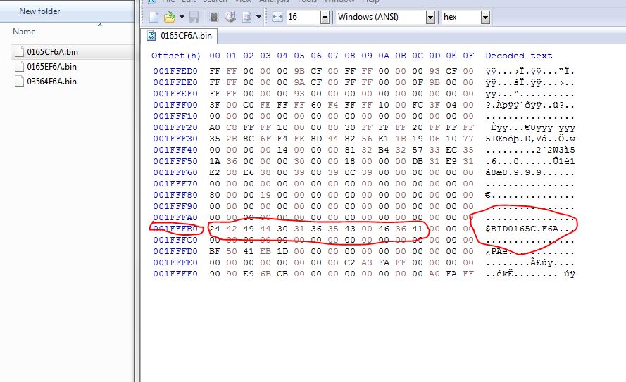

    looking for bios for HP G7-1135sd DAOR22MB6D1
    Hi ,
    Who knows which is the correct bin file for this MB :
    DAOR22MB6D1 - Rev : D - R22
    with AMD cpu
    Bios chip is Winbond - 25Q16BVSIG
    Thank you
    • 22275
    Re: looking for bios for HP G7-1135sd
    All the bios are posted in another thread of yours: https://www.badcaps.net/forum/showthread.php?t=73026
    To find the correct bin you need to open your bios backup with a hex editor,and search for the word BID ,that is the bios id. If the bios is corrupt or empty you`ll just have to try all 3 bios.
    https://mh-nexus.de/en/downloads.php?product=HxD20
    • pecrie
      • Nov 2011
      • 182
      Re: looking for bios for HP G7-1135sd DAOR22MB6D1
      Thanks SMDFlea.I did not know how to use the hex editor and that you can check the bios bin.
      But now I've learned a little more.
      By the way , that post was for another HP G72 laptop.
      This is another G72 and I did flash the bios chip.But alas it is not working.
      Maybe the bios chip is defective - I ordered a new chip .Will see if that will make a change
