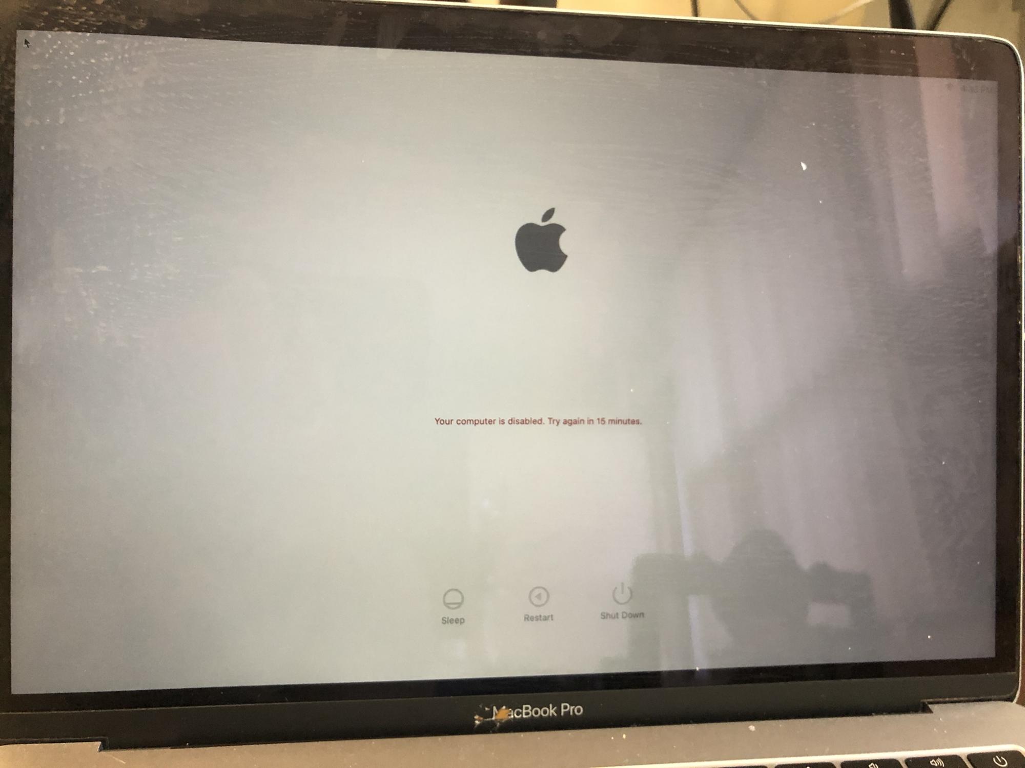

            #165
            Re: A1708 820-00840-a efi lock
            It showing me locked right now after that it comes with password screen.
            • Vesko356
              VIP Moderator
              • Aug 2018
              • 4386
              • Bulgaria 🇧🇬
              #166
              It's ICloud pin lock, not EFI password
              https://www.badcaps.net/forum/showpo...42&postcount=4
              3.2. Apple
              3.2.2. 2012 to 2017
              If there is an iCloud pin, you need to perform 3x PRAM reset after removing password. If FindMyMac is still enabled, you have to reinstall macOS while being disconnected from the Internet, then reconnect after logging in and bind to a new Apple account.
              Become a Badcaps supporter
              Thanks to all supporters.​
              • saisoni20
                • Feb 2022
                • 111
                #167
                Thanks for your help.

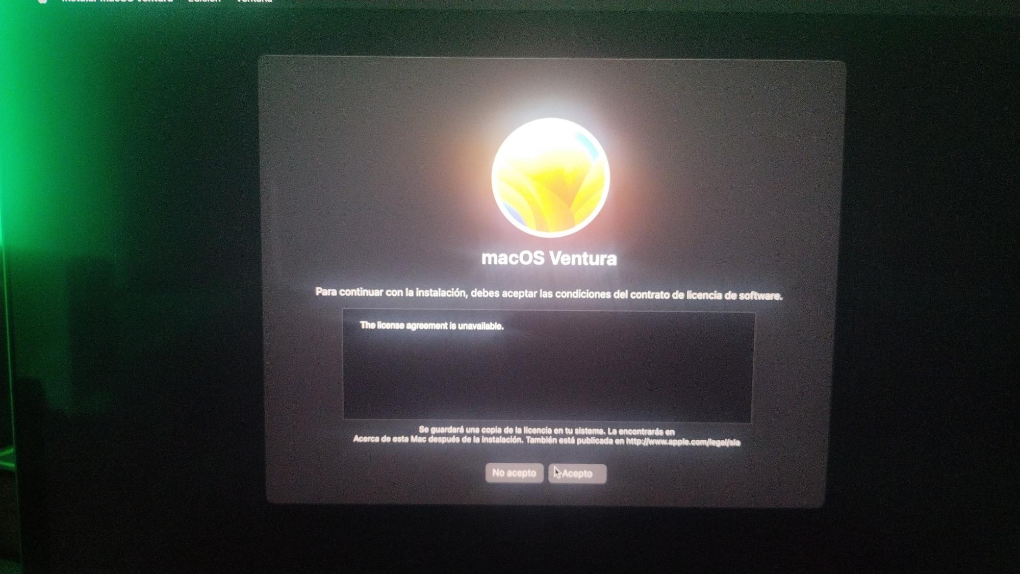

                    #169
                    Hello, could you help me, it does not detect the disk and it comes out with the efi lock, please help, this is the backup that I managed to obtain from the original PC but as such it does not recognize the disk. Can you help me please
                    • Expired
                      • Feb 2023
                      • 34
                      #170
                      Try This and reply with results.
                      • webdan
                        • Jun 2023
                        • 14
                        • Romania
                        #171
                        Works, yes of course. I tried myself to unlock the BIOS and was easy. I`m not a such as lazy or sluggard, but sometimes because of lack of time I appeal to you. I learn my lesson how to use RCUlocker.
                        • yandelmaxxx
                          • Aug 2023
                          • 2
                          • colombia
                          #172
                          Hello, I have tried your contribution and collaboration, it no longer has efi lock but when installing mac os ventura it tells me that the license is not valid and presents an error, could you please help me...
