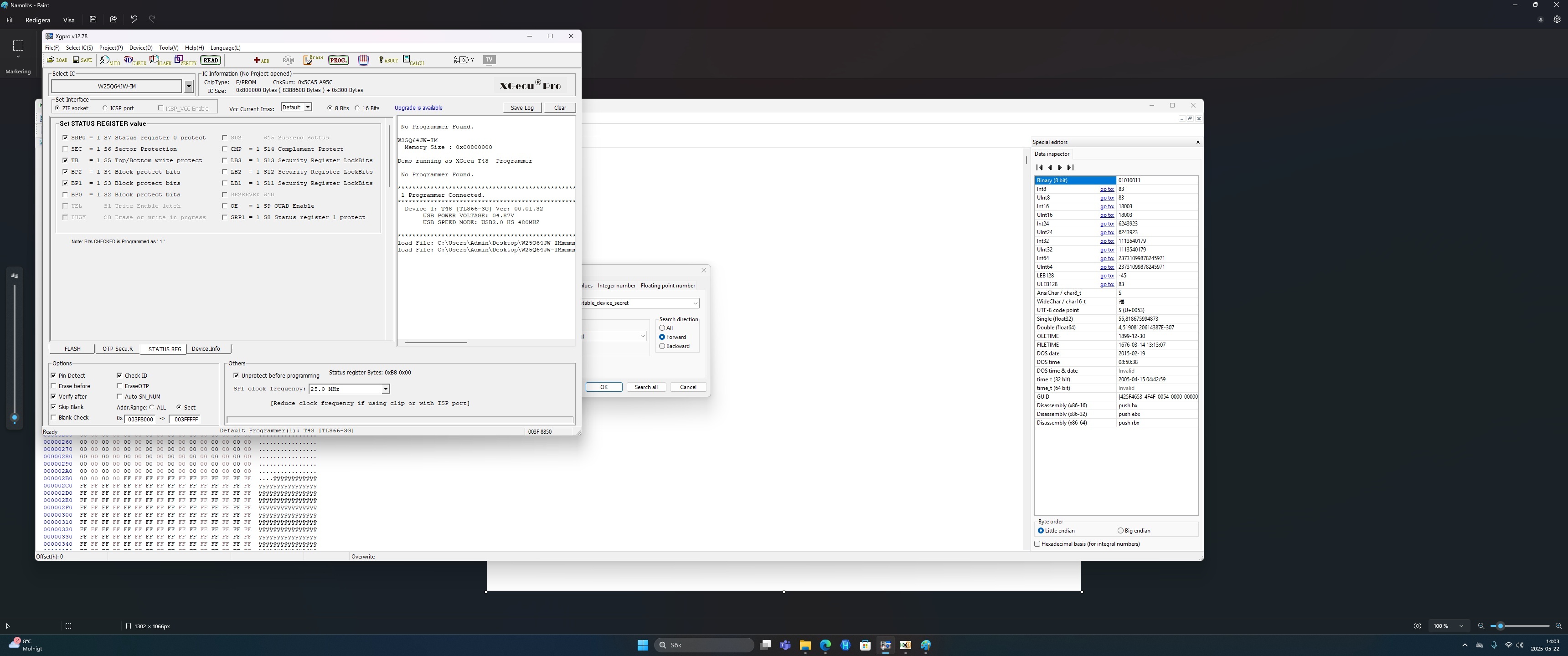

        hello guys. Can you please help unlock this bios bin file.
        Lenovo 300e 2nd gen
        Model name 82gk
        SN: R9101HCR
        MTM: 82GK000XSP
        Boad ID: BM5015_V1
          Lenovo 300e 2nd gen
          Model name 82gk
          SN: R9101HCR
          MTM: 82GK000XSP
          Boad ID: BM5015_V1
          Name of chip did you read ?
          • xpy000
            • Feb 2022
            • 22
            • Morocco
            GD25LQ128D (1.8v)
              GD25LQ128D (1.8v)
              File's corrupted.

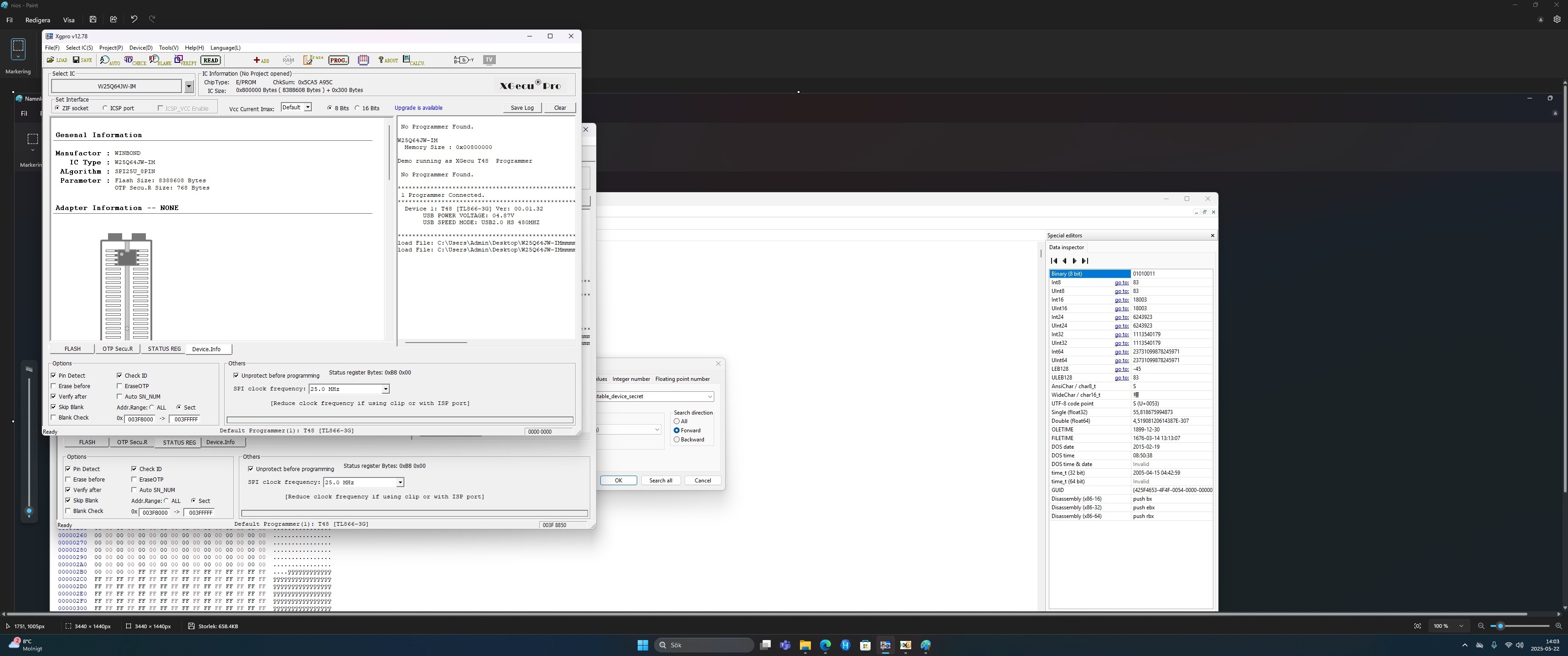

              • xpy000
                • Feb 2022
                • 22
                • Morocco
                I appreciate your help. I made another file. If this one is corrupted too then I think I need to use 1.8 v adapter. I am thinking that with Xgecu T56 I don't need that adapter but I might be wrong.
                • hoaca388
                  Badcaps
                  • Jan 2022
                  • 12269
                  #29
                  File is still corrupted
                  • xpy000
                    • Feb 2022
                    • 22
                    • Morocco
                    #30
                    This one should be good
                    • hoaca388
                      Badcaps
                      • Jan 2022
                      • 12269
                      #31
                      300e 2nd Gen Notebook - Type 82GK
                      • xpy000
                        • Feb 2022
                        • 22
                        • Morocco
                        #32
                        Thanks. It worked perfectly
