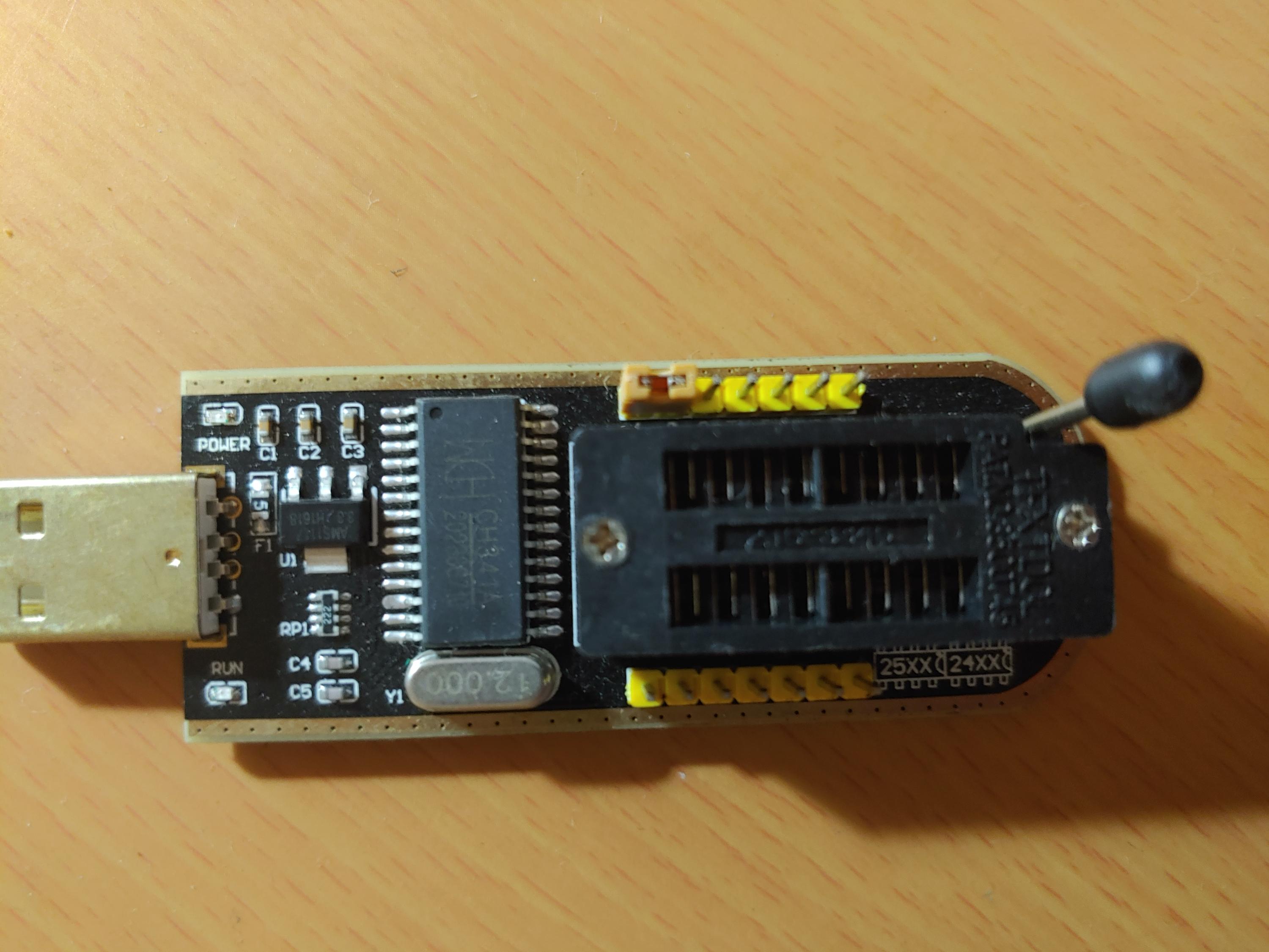

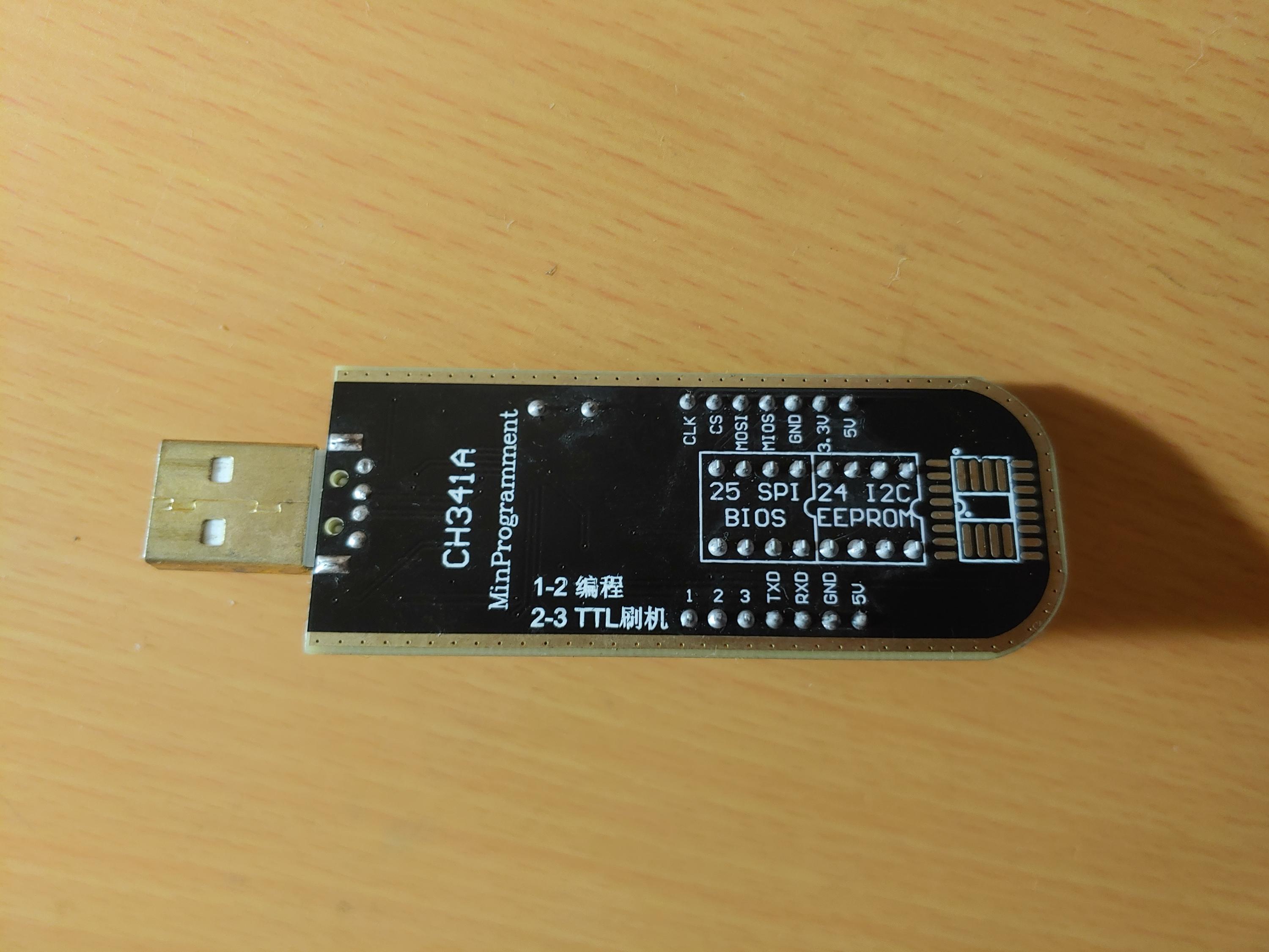

                        I have a ch341a programmer. Previously, they were flashing other laptops and everything was fine. Firmware version CH341A Programmer
                        1.34. I evaporate the chips before the firmware. When checking the buffer, it throws an error on FZ-G1. There is also a program NeoProgrammer 2.1.0.16. In it, a buffer check passes. I was stitching the latest dumps of this tablet with it. But the tablet has a black screen. Only indicators work. Maybe there is a problem with my programmator?

                            Tomorrow I will receive an adapter for 1.8v flash bios for my programmer. And try flashing it again with your bios.
                            • Sashajkl
                              • Mar 2019
                              • 27
                              • Ukraine
                              Re: Need Panasonic FZ-G1 Bios DFUP2371ZE
                              I think the problem is either in the programmer or in the program. I soldered the Bios chip. The program erases, checks for a dummy, writes. But when it comes to checking, the program says that the buffer does not match. That was all my attempts.

                                Hi. I think the problem is in my programmer. This week I plan to purchase ezp2010.

                                  what model your ch341a ? black? there s 2version 3 and 5 v...
                                  and have you try other software? like asprogrammer

                                    Hi. Thank you for helping me all this time. I do not know the version of my ch341a programmer. But I took a photo on both sides.

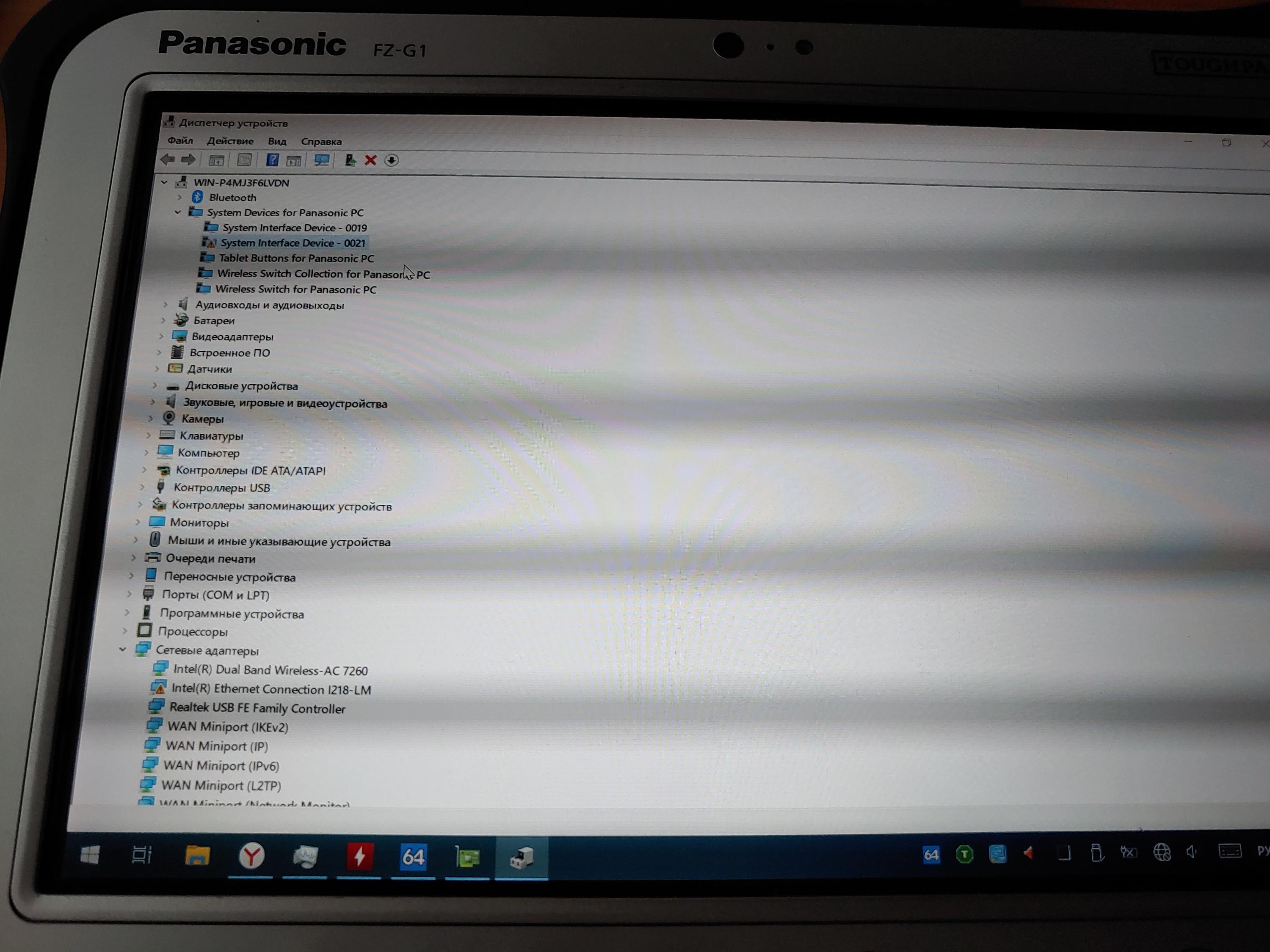

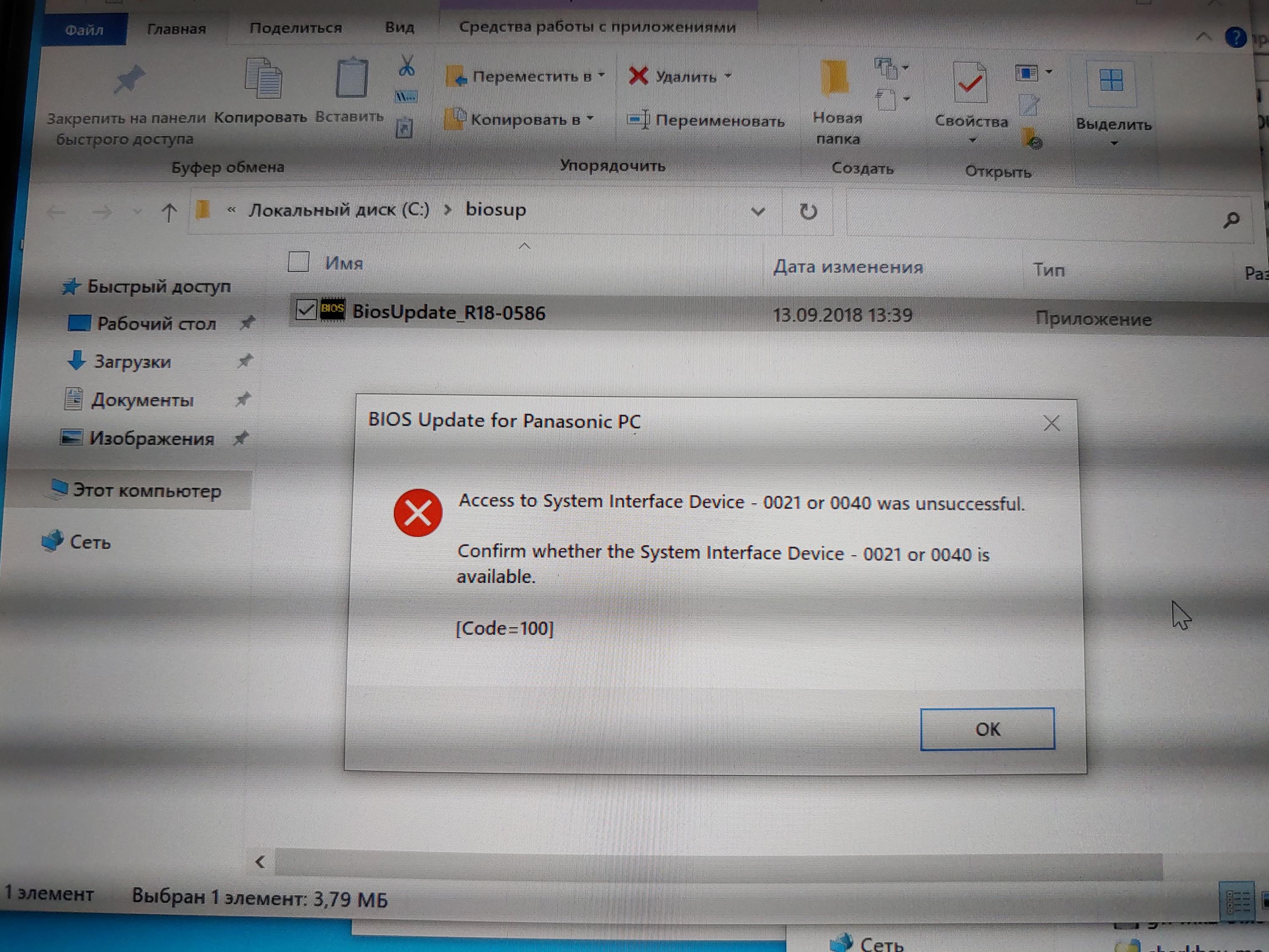

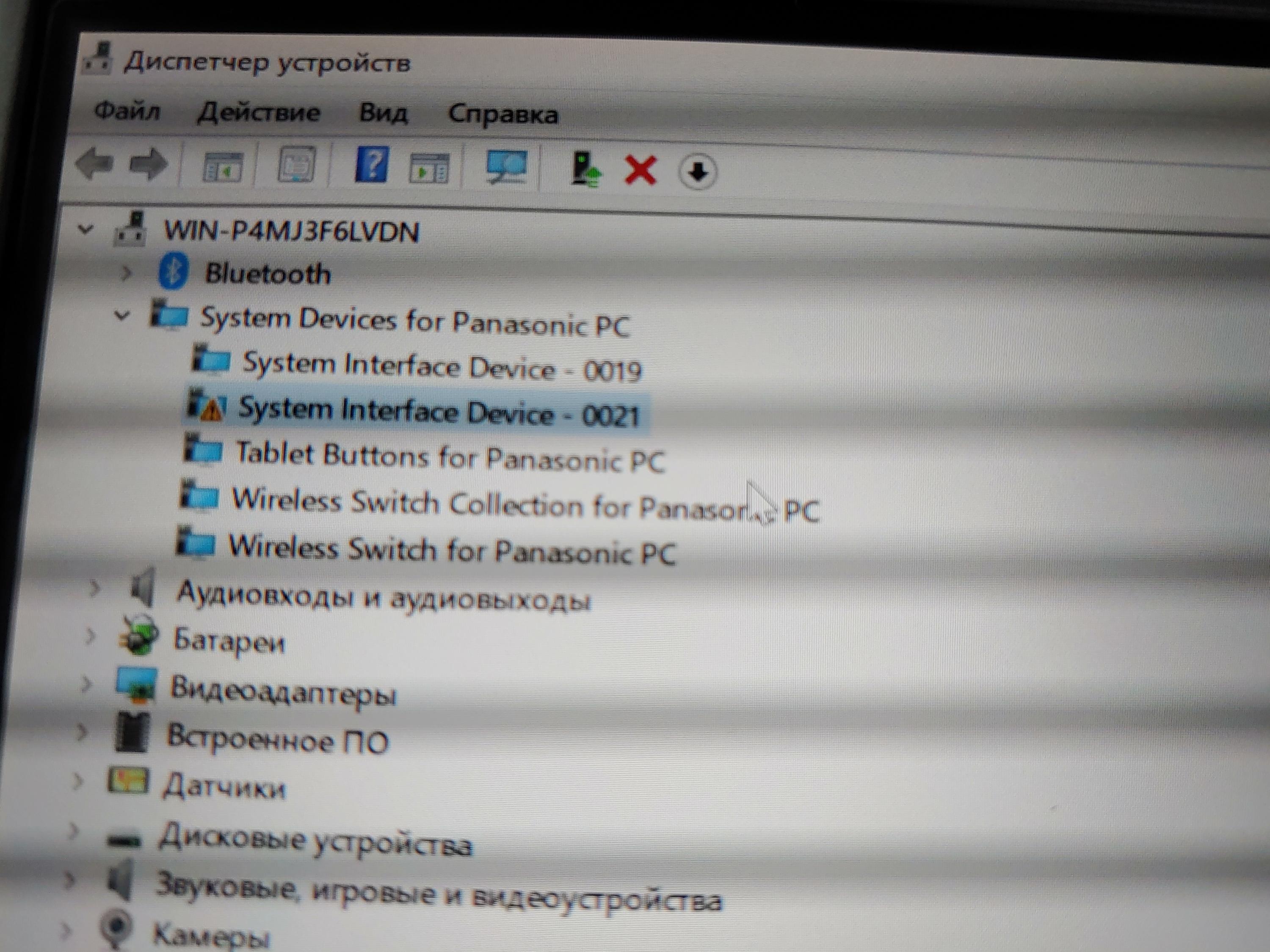

                                      Hi. Today I purchased the ezp2010 programmator. From the first time it turned out to flash your last Bios. The one that has the title "New". This miracle finally happened. I am very grateful to you. Without you, I would not have succeeded. 😄😄😄👍👍👍
                                      • Sashajkl
                                        • Mar 2019
                                        • 27
                                        • Ukraine
                                        One driver throws an error. Also, because of this error, it does not allow updating bios through windows
