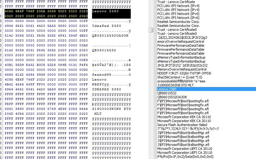

    anyone ca fix this bios please
    Does the serial number found in the bios match the one on the case . Its a Z380

      Re: need bios Lenovo Z480
      but on the back of the laptop downside cover written z480
        and serial written on the back is QB06015532
          And the board id DALZ2AMB8F0 REV:F
            Bios + DMI .Try it and give feedback .
            Z480 Laptop (ideapad) - Type 2148
              @smdflea thank you its working
