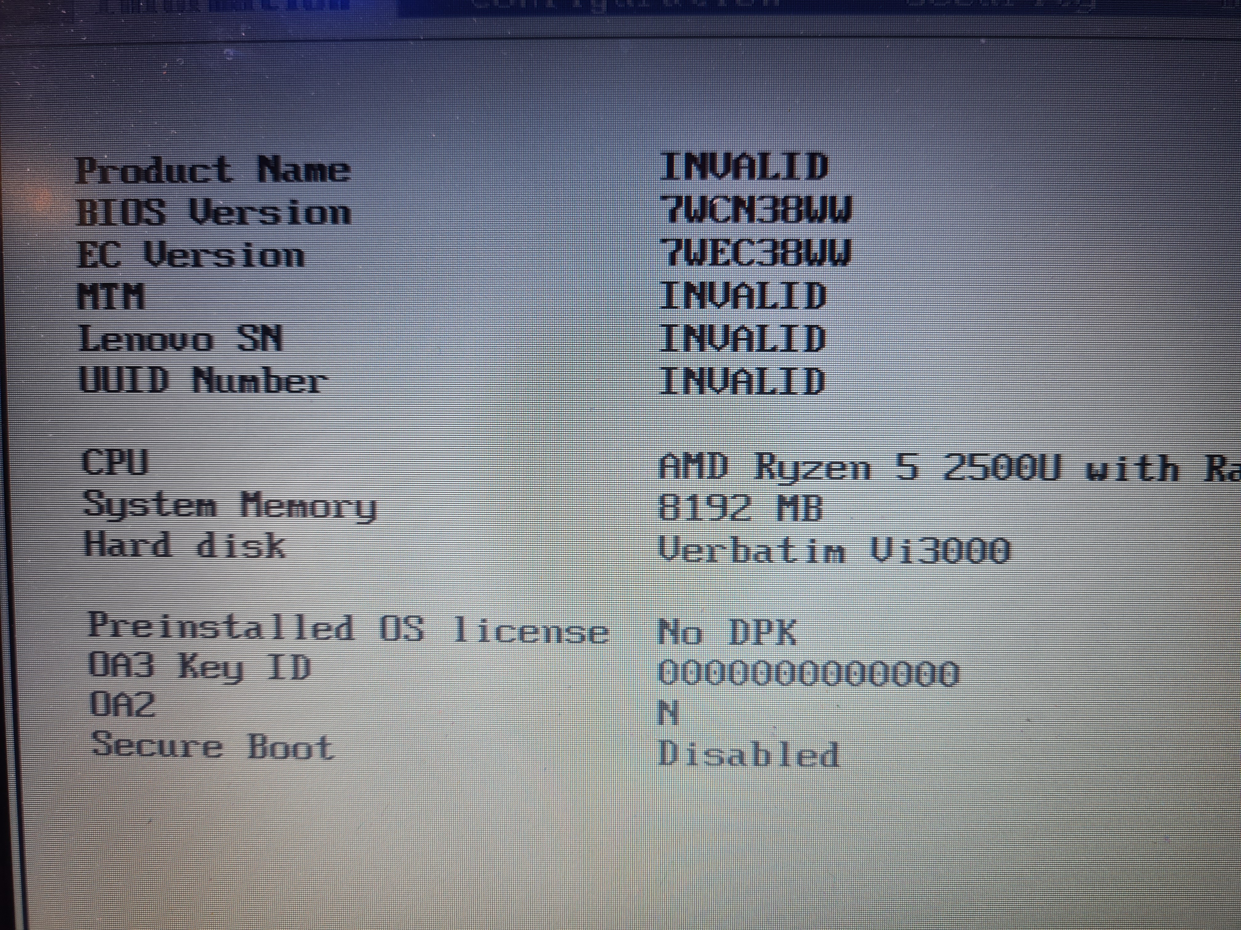

      Hi, have a nice day, i have a Lenovo Ideapad 330S-15ARR 81FB Ryzen5
      with Serial number: YD04X9L9
      MO: YDN0B862801V
      FACTORY ID GXSC
      MTM:81FB005WIX
      stuck on ubuntu uefi voice for startup, every linux boot is freezing with a cursor on a top left of screen.
      can i have latest bios with correct serial (i think the serial is wrong because the motherboard was replaced/fixed) thankyou!

          no changes... Serial and other datas are INVALID

            #185
            it shouldn't be ...

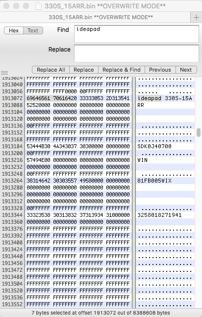

            • volinakis
              • Jan 2021
              • 2874
              • N/A
              #186
              try this one, maybe DMI wasn't in the right place in your bios backup. Is bios from 181 with your serial.

              #187
              OMG! it's working, the board was coming from Aliexpress... and they probably placed an eeprom from another board with a different address?
              how is possible? i was thinking the eeprom can have DMI everywhere and everything was managed from the code inside bios... there is probably somthing on EC that can determine the DMI location?

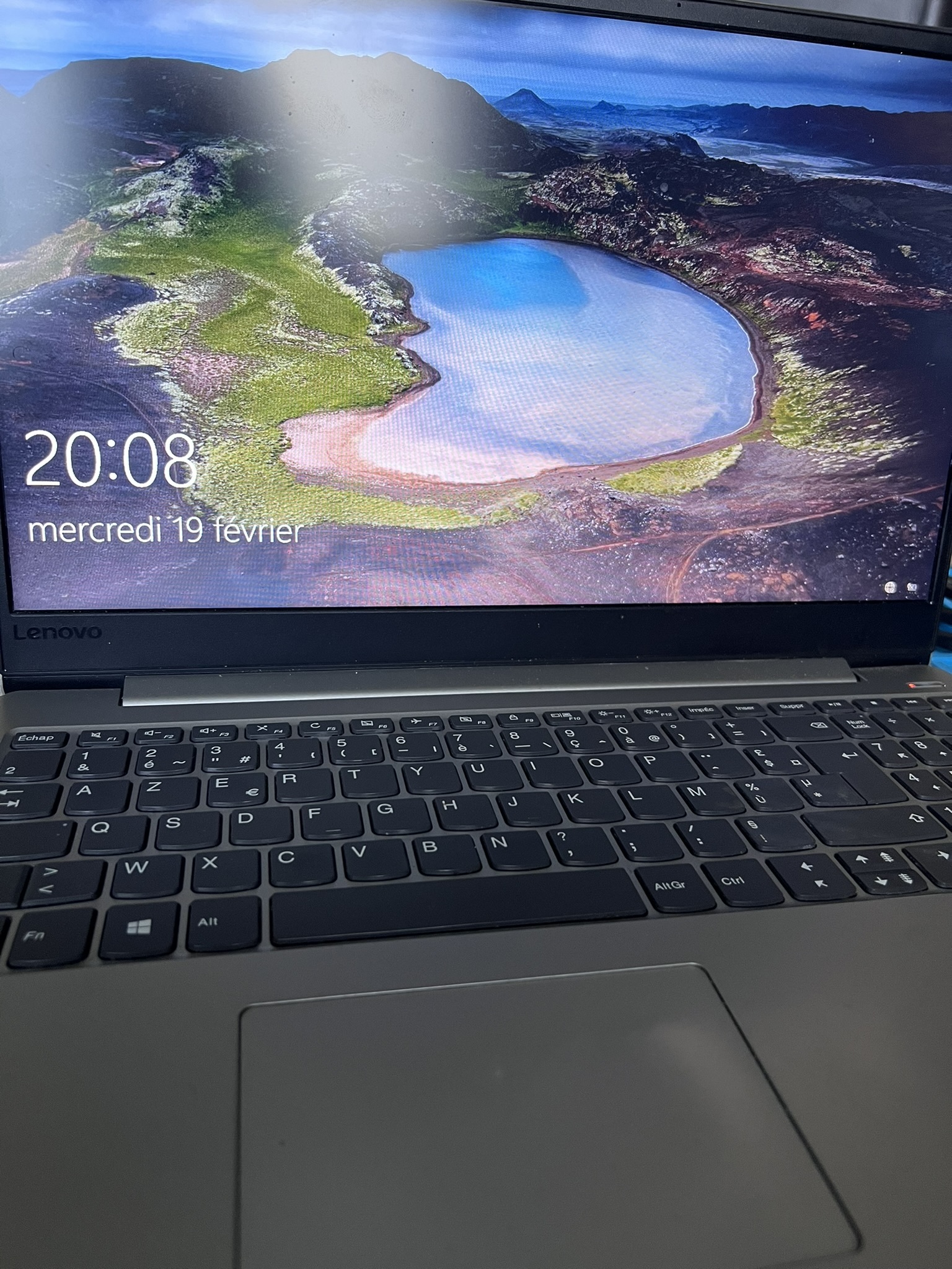

                #188
                Hello Team, Possible to have BIOS for LENOVO ideapad 330S-15ARR, SN° YD05ZT6H please ? 🙏

                    #190
                    The original BIOS is corrupt and do not work

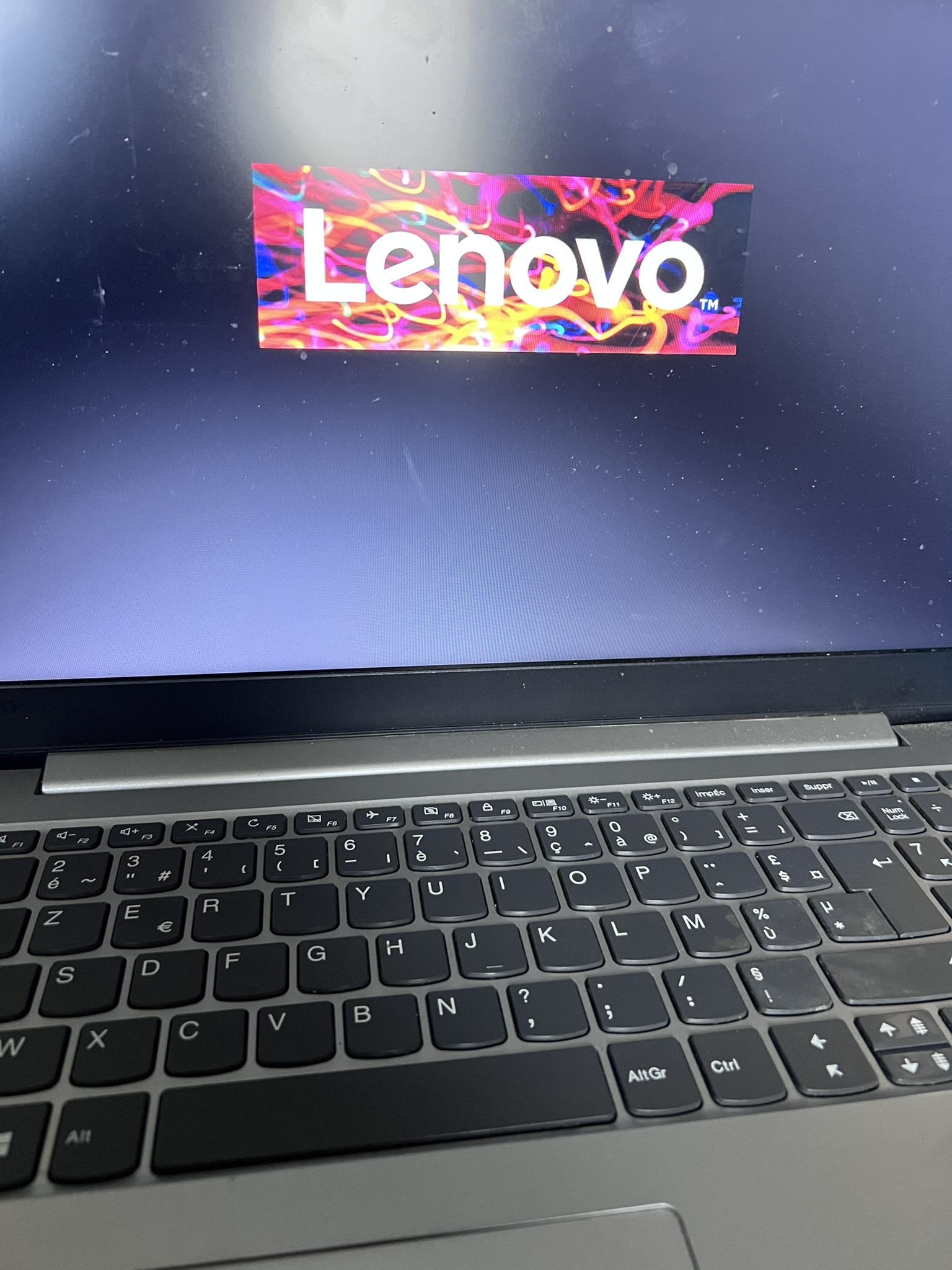

                          • wizard13
                            • May 2021
                            • 13
                            • ccc
                            #194
                            Hi hoaca388,
                            Sorry about that! I initially uploaded the file to SwissTransfer because the site didn't accept .bin files. But now it's all good—I've put the BIOS inside a .rar archive and attached it here.

                              • wizard13
                                • May 2021
                                • 13
                                • ccc
                                #196
                                Originally posted by hoaca388
                                330S-15ARR Laptop (ideapad) - Type 81FB
                                Hi hoaca388,
                                I just wanted to express my sincere gratitude for your incredible help! Thanks to your BIOS fix, my Lenovo 330S is now fully functional, and I couldn't be happier. Your expertise and generosity in sharing your knowledge are truly appreciated.
                                I really admire your dedication and willingness to help others in need. If there's anything I can do to return the favor, please let me know!
                                Again, a huge thank you for your precious assistance—you're a legend! 🙏🙏
