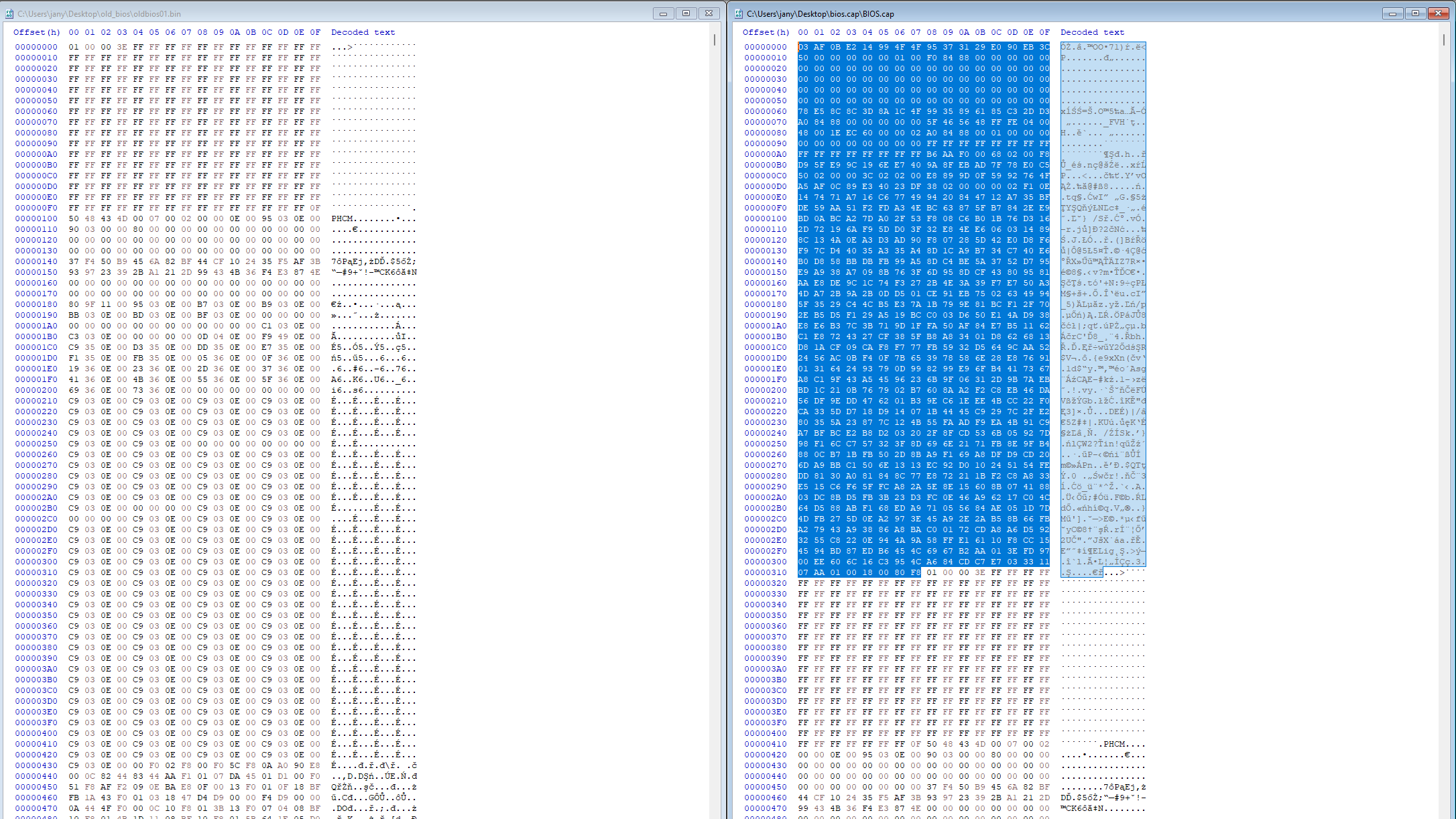

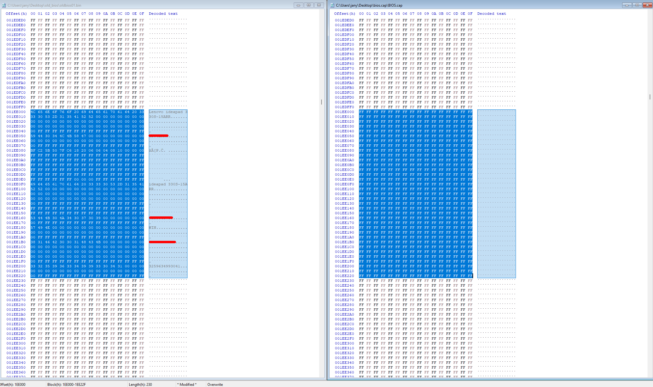

      #162
      I followed post number 29. I found the region 1EE000 - 1EE22F and replaced it.
      However, I do not know if it is enough to replace only this region 1EE000 - 1EE22F (I did not replace the Win key)
      The BIOS you sent me starts in the hex editor like this
      Code:
      00000000: 0100 003e ffff ffff ffff ffff ffff ffff ...>............
      00000010: ffff ffff ffff ffff ffff ffff ffff ffff ................
      00000020: ffff ffff ffff ffff ffff ffff ffff ffff ................
      00000030: ffff ffff ffff ffff ffff ffff ffff ffff ................
      00000040: ffff ffff ffff ffff ffff ffff ffff ffff ................
      00000050: ffff ffff ffff ffff ffff ffff ffff ffff ................
      00000060: ffff ffff ffff ffff ffff ffff ffff ffff ................
      00000070: ffff ffff ffff ffff ffff ffff ffff ffff ................
      00000080: ffff ffff ffff ffff ffff ffff ffff ffff ................
      00000090: ffff ffff ffff ffff ffff ffff ffff ffff ................
      000000a0: ffff ffff ffff ffff ffff ffff ffff ffff ................
      000000b0: ffff ffff ffff ffff ffff ffff ffff ffff ................
      000000c0: ffff ffff ffff ffff ffff ffff ffff ffff ................
      000000d0: ffff ffff ffff ffff ffff ffff ffff ffff ................
      000000e0: ffff ffff ffff ffff ffff ffff ffff ffff ................
      000000f0: ffff ffff ffff ffff ffff ffff ffff ff0f ................
      00000100: 5048 434d 0007 0002 0000 0e00 9503 0e00 PHCM............
      00000110: 9003 0000 8000 0000 0000 0000 0000 0000 ................
      00000120: 0000 0000 0000 0000 0000 0000 0000 0000 ................
      00000130: 0000 0000 0000 0000 0000 0000 0000 0000 ................
      00000140: 37f4 50b9 456a 82bf 44cf 1024 35f5 af3b 7.P.Ej..D..$5..;
      00000150: 9397 2339 2ba1 212d 9943 4b36 f4e3 874e ..#9+.!-.CK6...N

      If I can see correctly, I looked for the PHCM sequence in BIOS.cap and it looks like this (region starts at 00000310):
      Otherwise, I have to delete everything up to line 0300 (including)
      Code:
      00000300: 00ee 606c 16c3 954c a684 cdc7 e703 3311 ..`l...L......3.
      00000310: 07aa 0100 1800 80f8 0100 003e ffff ffff ...........>....
      00000320: ffff ffff ffff ffff ffff ffff ffff ffff ................
      00000330: ffff ffff ffff ffff ffff ffff ffff ffff ................
      00000340: ffff ffff ffff ffff ffff ffff ffff ffff ................
      00000350: ffff ffff ffff ffff ffff ffff ffff ffff ................
      00000360: ffff ffff ffff ffff ffff ffff ffff ffff ................
      00000370: ffff ffff ffff ffff ffff ffff ffff ffff ................
      00000380: ffff ffff ffff ffff ffff ffff ffff ffff ................
      00000390: ffff ffff ffff ffff ffff ffff ffff ffff ................
      000003a0: ffff ffff ffff ffff ffff ffff ffff ffff ................
      000003b0: ffff ffff ffff ffff ffff ffff ffff ffff ................
      000003c0: ffff ffff ffff ffff ffff ffff ffff ffff ................
      000003d0: ffff ffff ffff ffff ffff ffff ffff ffff ................
      000003e0: ffff ffff ffff ffff ffff ffff ffff ffff ................
      000003f0: ffff ffff ffff ffff ffff ffff ffff ffff ................
      00000400: ffff ffff ffff ffff ffff ffff ffff ffff ................
      00000410: ffff ffff ffff ff0f 5048 434d 0007 0002 ........PHCM....
      00000420: 0000 0e00 9503 0e00 9003 0000 8000 0000 ................
      00000430: 0000 0000 0000 0000 0000 0000 0000 0000 ................
      00000440: 0000 0000 0000 0000 0000 0000 0000 0000 ................
      00000450: 0000 0000 0000 0000 37f4 50b9 456a 82bf ........7.P.Ej..
      00000460: 44cf 1024 35f5 af3b 9397 2339 2ba1 212d D..$5..;..#9+.!-
      00000470: 9943 4b36 f4e3 874e 0000 0000 0000 0000 .CK6...N........
      This looks more like the BIOS you uploaded to the forum.
      However, it still does not match 8388608 bytes.
      So I moved to the end of the file (extracted from the original BIOS (NTB)) and saw that at the end offset 007FFFF0. I deleted everything from offset 00800000.
      Code:
      00800000: 83fb 0076 2950 5152 b806 0000 800f a2c1 ...v)PQR........
      00800010: e910 662b 0f66 8b5f 0466 03d9 5a59 580f ..f+.f._.f..ZYX.
      00800020: b7db c1e3 0a3b c376 058b c30f 6ed8 5251 .....;.v....n.RQ
      00800030: 2500 80ff ff0f bdc8 0f84 d100 0000 510f %.............Q.
      00800040: b3c8 5060 b801 0000 000f a2c1 eb18 81e3 ..P`............
      Now the file matches closely with what I extracted from NTB.
      Code:
      -rw-r--r-- 1 gusto gusto 8388608 okt 31 10:42 BIOS_test.cap
      I edited the BIOS in the hex editor as it is written in # 29. However, it is not written anywhere that I have to cut the beginning and end of the file.
      I am also attaching pictures and a file that I edited. It should match the one from volinakis (however md5sum doesn't match).
      I don't have NTB at the moment, so I can't check if mine is correct.

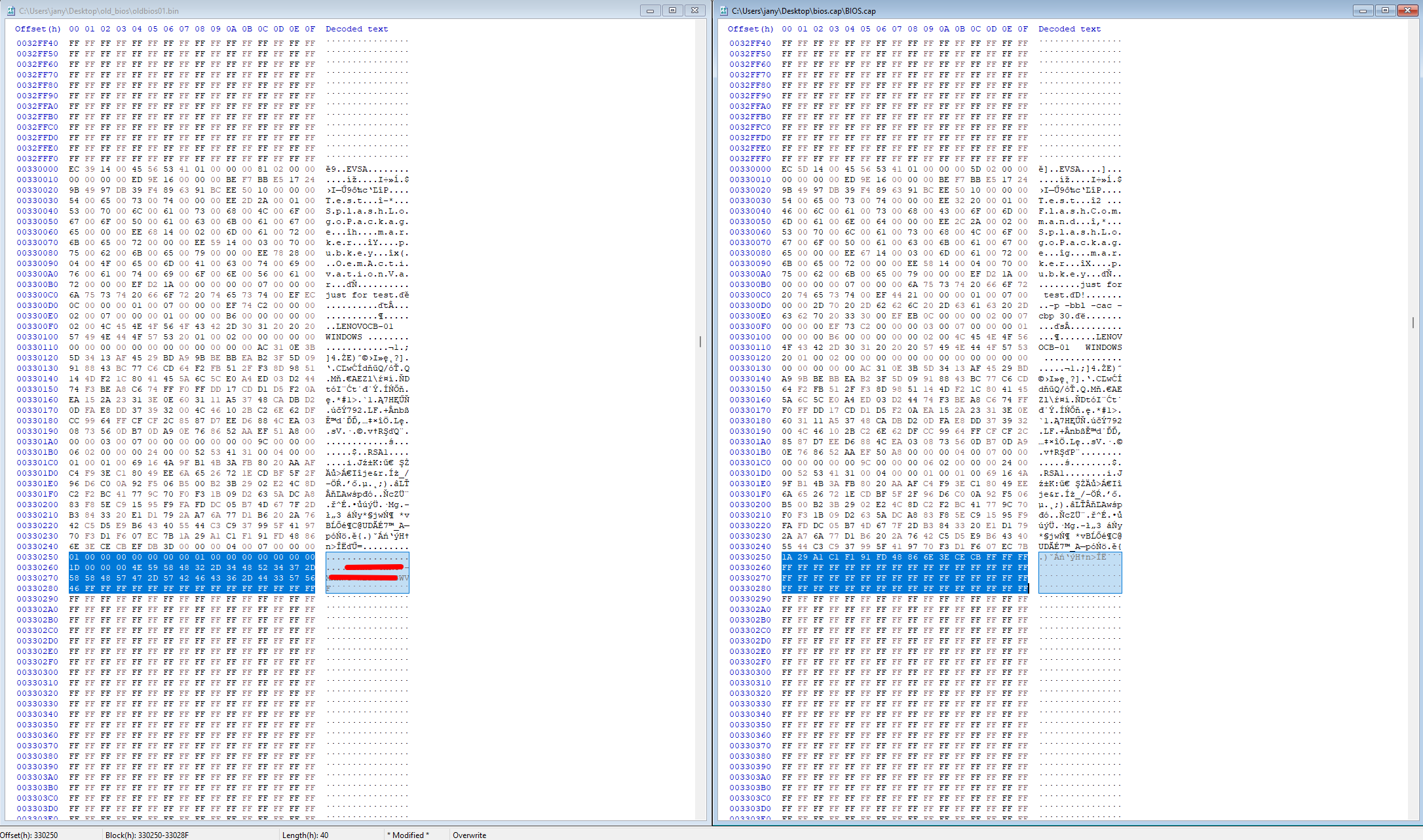

                      After some time I came back to it. I did
                      1. cut the beginning of the file from 0 to 0000317 (792 bytes) see
                      2. cut the end of the file, everything from offset 0080000 to the end 008881D0 (557528 bytes) see
                      3. I replaced DMI offset 001EE000 - 001EE220 (560 bytes) see
                      Now the file has the correct size 8388608 bytes, but the md5sum does not match your file
                      I searched for the problem and compared the files.
                      Code:
                      BIOS.my BIOS.volinakis differ: byte 11588379, line 126499
                      see offset 01EE220
                      my
                      Code:
                      00 FF FF FF FF FF FF FF FF FF FF FF FF FF FF FF
                      your
                      Code:
                      FF FF FF FF FF FF FF FF FF FF FF FF FF FF FF FF
                      There is only a difference between 00 and FF. Either I am wrong or you are.
                        for sure i am wrong, that's why "I uploaded the one you gave me to the bios. I started NTB and it works great." ...
                        • gusto
                          • Oct 2024
                          • 34
                          • Czech Republic
                          #172
                          I didn't say you were wrong.
                          I can't tell if it would work with
                          Code:
                          but with
                          Code:
                          it definitely works​

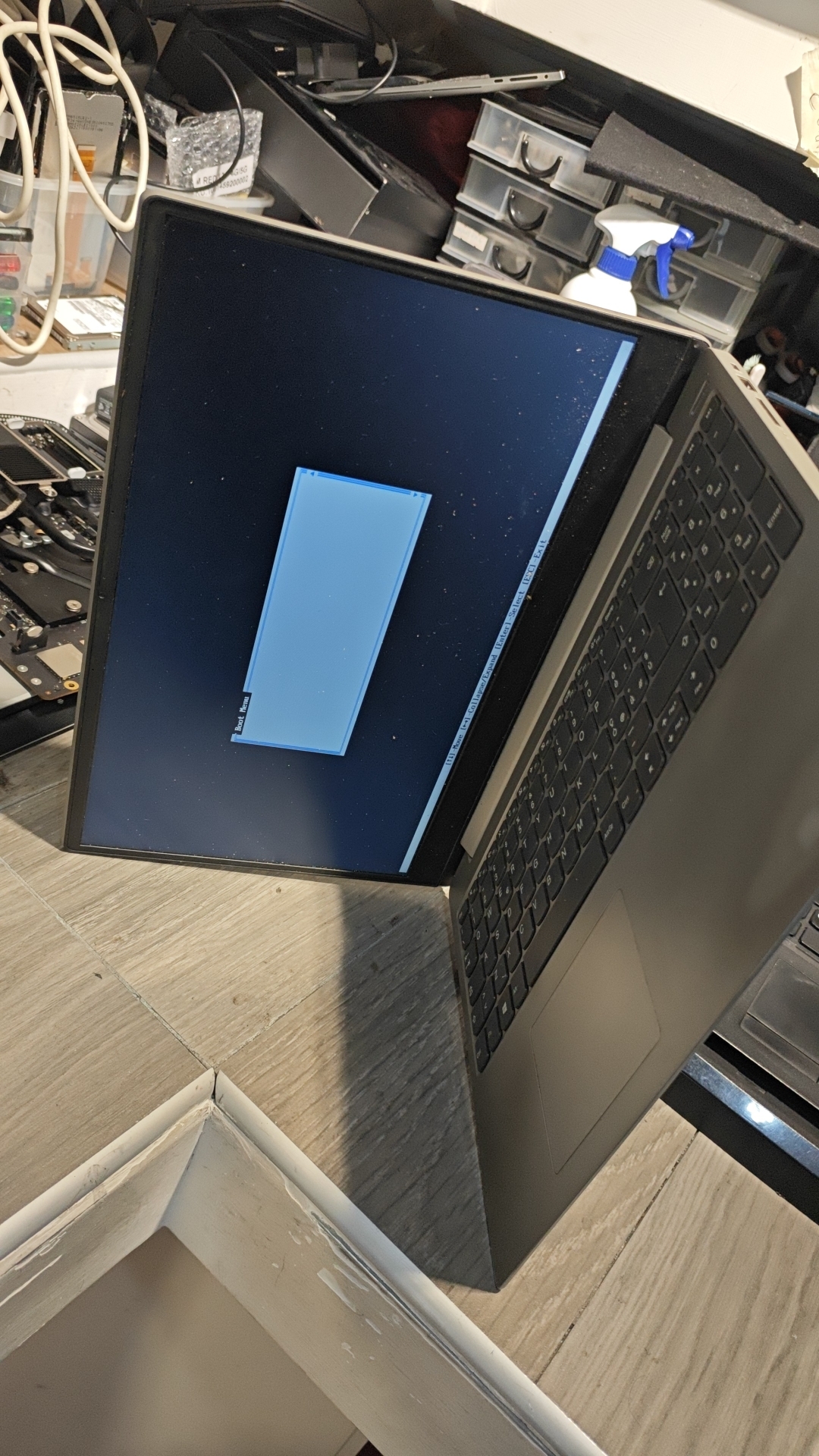

                              Same notebook 330s-15ARR
                              I have black screen solid white power button light
                              The lcd goes to dark (every pixel on) backlight off, no image
                              Thanks in advance

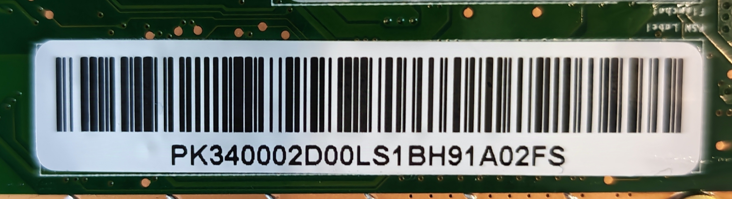

                                Serial number ?
                                • tyl85
                                  • Nov 2020
                                  • 51
                                  • Italia
                                  #176
                                  Originally posted by hoaca388
                                  Serial number ?
                                  Serial image was disappear
                                  • hoaca388
                                    Badcaps
                                    • Jan 2022
                                    • 12330
                                    #177
                                    330S-15ARR Laptop (ideapad) - Type 81FB
                                    Serial _ PF1KW1XA
